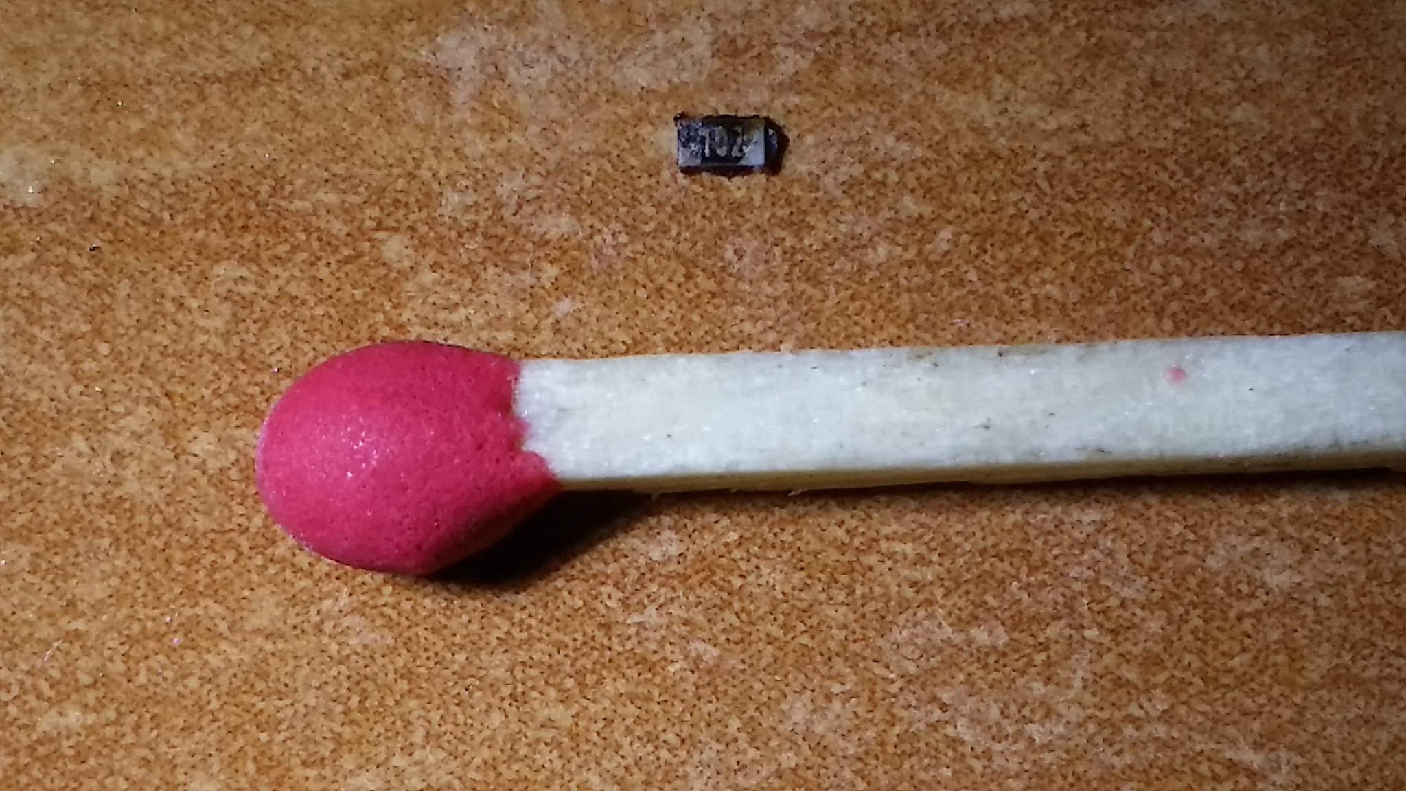

    Elements affected by corrosion have been desoldered, undamaged pads cleaned of tin.
    The TLE chip has corroded and completely disappeared together with the pad, element No. 1, which probably was the resistor disappeared, element No. 2 is but does not show any resistance, element 102 can be read on element No. 3, while element no. 4 has not yet has been deciphered to the end, but these are most likely 2 diodes.

    Item number 3:
    Corroded PCB Repair: MPM BMW E60/61 Energy Management Module HELBAKO MPM HW 00.3 FSV 5.10.26
