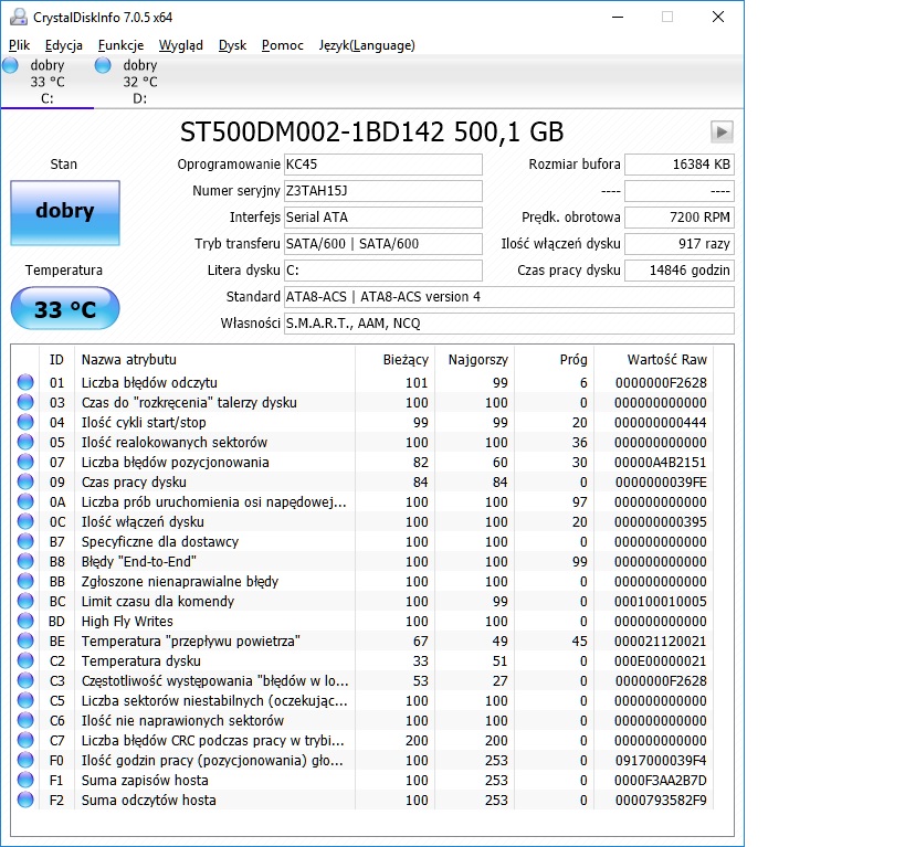

    Show SMART disk.
  • #5 16426096
    michalo9
    I insert SMART

    OK drive.
    Check the system operation in safe mode with networking.
