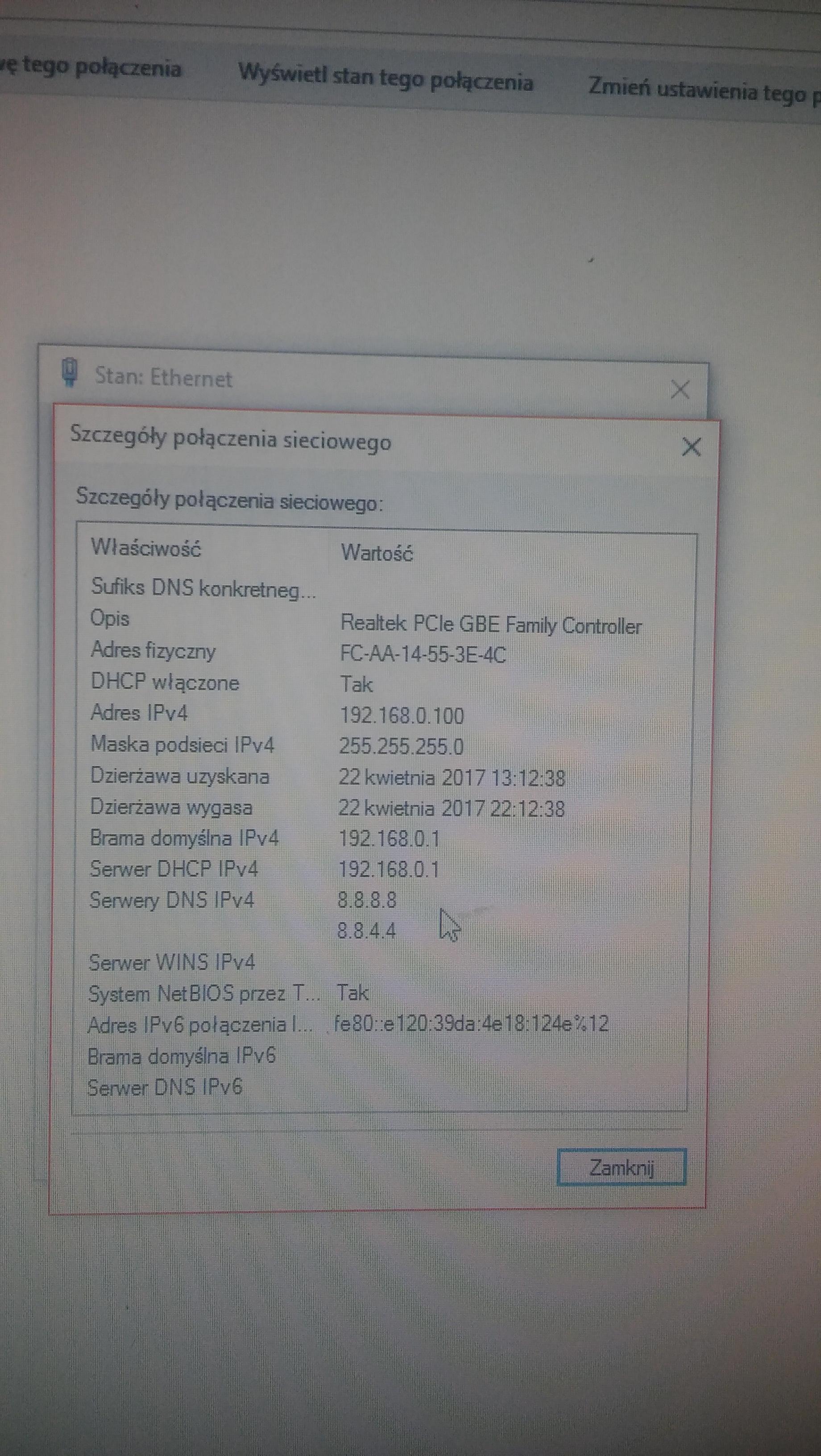

  • #13 16428862
    sq9cwd
    Posts: 1142
    Help: 74
    Rate: 143
    Makkusu wrote:
    jimasek wrote:
    Tp-Link connected via WAN port to the provider's modem?
    Yes.
    There is one WAN cable from the modem and the other is from the television.
    From the router, however, from one of the four ports which were going cable connected to the computer.
    Added after 3 [minutes]:
    sq9cwd wrote:
    I don't have Win10 on hand, but you'll find network connections in the control panel. There should be a network card you use. There may be more than one, you should know which one you are talking about. Then read the network parameters assigned by DHCP. I'd ask printscreen network parameters, or print it manually.
    Which of these to choose ??
    View network status => Change network adapter settings => 2 Click Local connection (if it is on a cable) => Details
    I am interested in what is there.
  • #14 16429510
    Makkusu
    Posts: 8
    There is such a thing
    • Multimedia - your computer is configured correctly but the DNS resource is not r 1492884949219.jpg (694.56 KB) You must be logged in to download this attachment.
