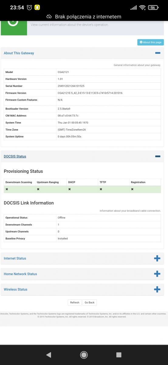

    A month ago I bought fixed internet from Play, the installer installed and configured everything and for a month everything worked flawlessly.
    Today I unplugged the modem from the power for a few hours and after plugging it back in the power LED lights up for a few seconds and then flashes every second or so. It is possible to connect to the modem but there is no Internet all the time. (Earlier I also disconnected it from the power and after connecting it back after a few minutes the LED stopped flashing and the Internet started working)
    Reset the modem several times, reconfigured unfortunately the problem persists
    I would appreciate help if anyone knows how to solve this problem :) .

    Can you log on to its website and look for DOCSIS signal parameters in the options?

    Problem with play desktop internet - Technicolor CGA2121 modem .
  • No DOCSIS signal detected on modem startup
    #6 19640573
    KOCUREK1970
    Posts: 35667
    Help: 3860
    Rate: 5488
    @kuba21111
    The modem did not detect any DOCSIS signal (although supposedly 1 downstream channel detected and there should be these channels from 16 to 24, and did not detect any upstream channel and there should be these channels from 4 to 6) and therefore did not log in to the operator's network and did not download provisioning from CMTS - there may be several reasons for this and none of them are under your control:
    - defective modem,
    - defective power supply from the modem,
    - some network/network failure on the operator's side.
    You won't verify it yourself - call the operator and report it.

  • #9 19640956
    kuba21111
    I called and they actually have some kind of breakdown in my area, thanks for your help
