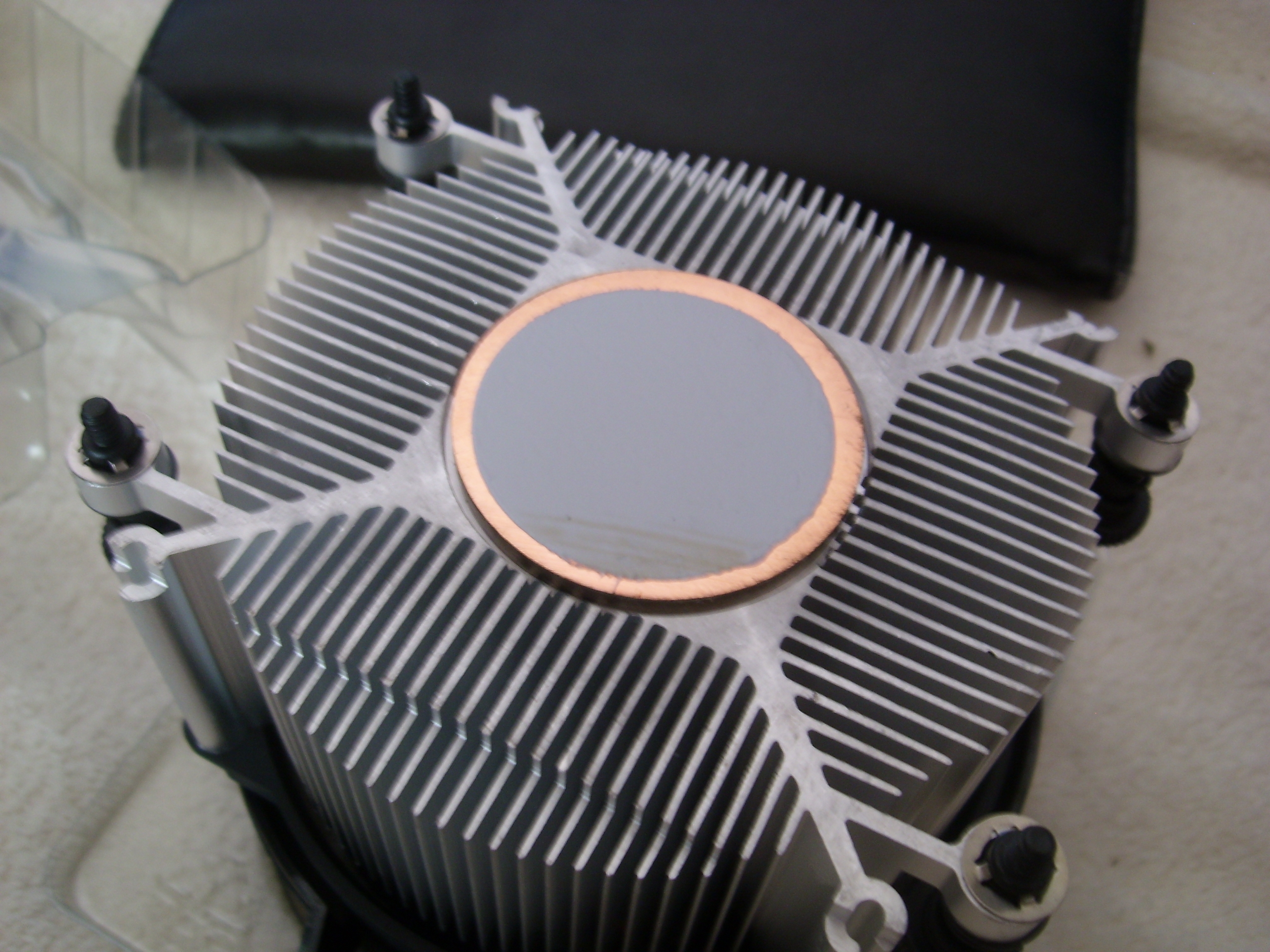

    I'm wondering about this yellowish color, isn't that a problem?
    If I have this Arctic MX-2, I do not know if it makes sense to replace it, the processor will be overclocked. I just don't know how to remove this paste and how to evenly apply a new one, any advice?

    You can leave this paste up to 3-6 months and then replace it with Arctica.
    This yellowish color is copper, he is the conductor, so there is no problem.

    And what is this paste, how did it get there and why do you want to overclock on such poor cooling? It seems that this CPU is not power-hungry, but this stock cooling usually only works with the factory settings. After the OC, it will be noisy, to say the least.

    @ 310artur series of questions, no one knows why ... how much on stock cooling 1600 can be turned up, it is enough to see in the reviews, the cooling is very good, but not necessarily super quiet. And the paste is pre-applied, which should be known to a friend. Anyway, the rhythms can only be turned to ~ 4GHz and it does not make a diametrical difference in temperatures.

    If it is factory-made, it's nice and it can only be if the author is aware that there is (should) a foil stuck on? Because the question was a bit strange as if the author did not really know what he had in his hand.
    Well, since you write that it's good only loud, that's great - it's a matter of taste, but for me good can't be loud ... At most, it can be efficient, but not good.
    And the stupid question of replacing the toothpaste every 3-6 months? I think you run the website to recommend it so often. If I do not move the cooling, I do not change the paste as long as the temperatures are good. 2 years are good for pastes like AAB TG2 and the one on the heat sink looks similar.

    Buddy, let's start with the basic information. There is no foil because it was not there. The heat sink is covered with a contoured material and the paste is not covered with anything. To make it funnier, it was exactly the same in the FX series (only there the profiled "plug" fitted better and prevented oxidation / drying out. That's one. Two - if for a friend "not necessarily super quiet" means loud, I really advise you to read the text again, this time Of course, that cooling will be less efficient than such spartan 1024, so to have a similar temperature the fan will have to spin more. And now the information from one hand - the spartan HE1024 on all loaded cores keeps the temperature ... 45 ° C. What cooling capacity do you need to have

    As for the 3rd, my mistake.
    As for 1 and 2 - good to know. I do not work on the site, and somehow I have never convinced myself to AMD. Anyway, the foil or cap must be removed before mounting on the CPU. And the question "what to remove it" still bothers me - after all, "it" can be removed with anything, as long as the cap is removed.

    So, rather, no foil got tangled there.

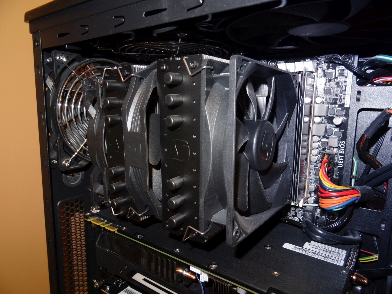

    None :)
    I have such a set and I recommend it, the silence of the coolness :)
    AMD Ryzen 5 1600: Stock Paste Color Concerns, Arctic MX-2 Replacement & Overclocking Tips
    You can buy a little cheaper:
    https://www.ceneo.pl/47605326
    https://allegro.pl/listing?string=SilentiumPC...nce-floki-5-nga-hcp-ele-1-3-1003&price_to=187
    For PLN 200, you can also buy [Thermal Grizzly Kryonaut] or [Gelid GC-Extreme] paste, which should additionally improve cooling.

    And these RAM memories can you normally insert and remove without disassembling the cooling? And doesn't the whole thing bend the motherboard too much?

    I do not have to disassemble all the cooling, only the fan is enough. Although I installed the memory when folding the computer, I did not move them. :)
    Nothing bends, Fera, Fortis and Grandis cooling systems have the same mounting system, which for me is a revelation,
    all you need is a flat screwdriver, photo, 2 fans, unscrewing 2 screws and the paste can be replaced.
    Earlier, I had a cooling system [Zalman CNPS14X] in which the assembly was massacre, and without removing the CD it was a reeling for half an hour some strange 4 screws screwed on with a strangely bent key - a massacre.
