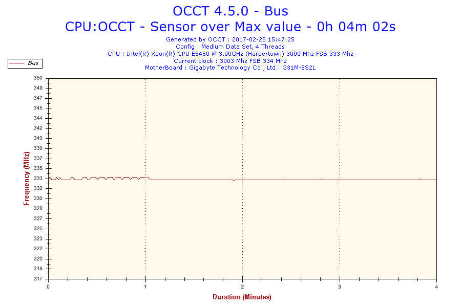

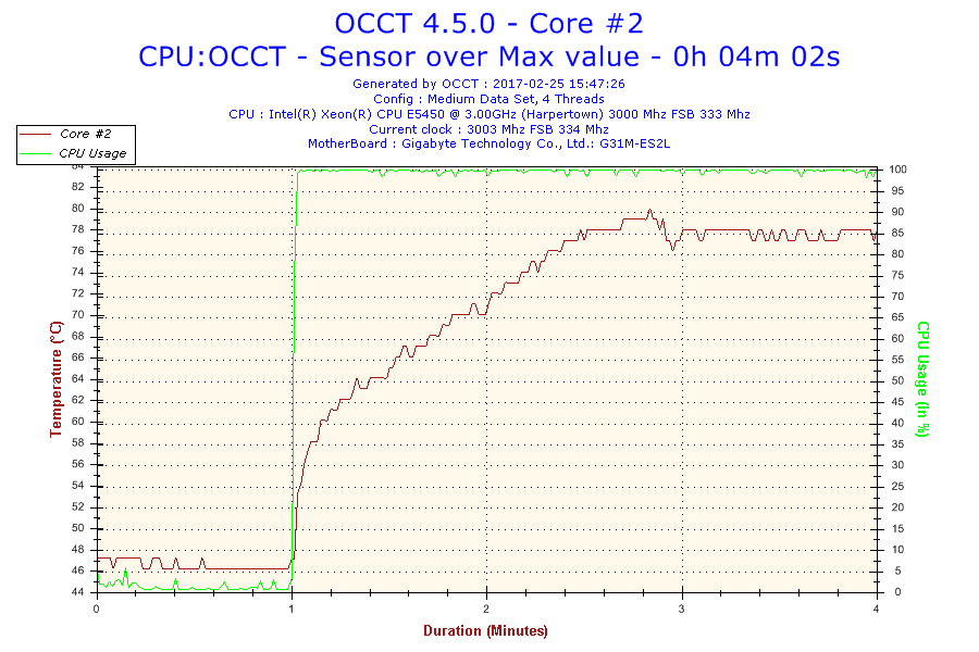

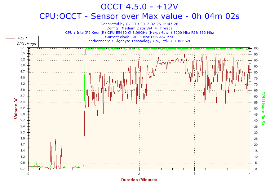

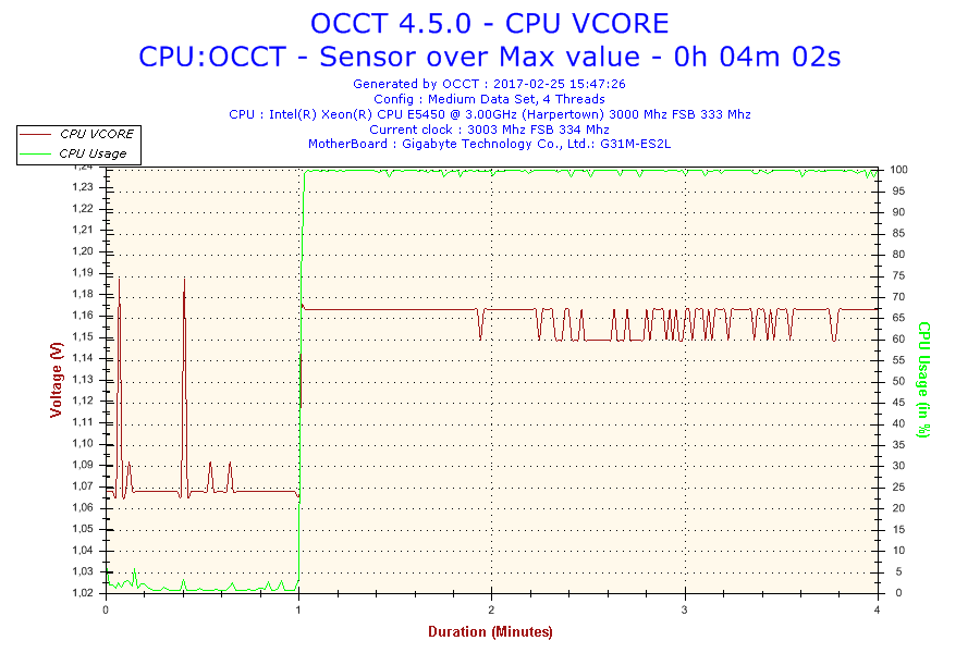

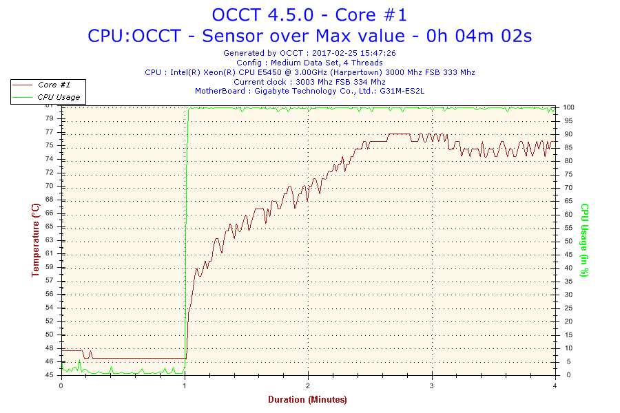

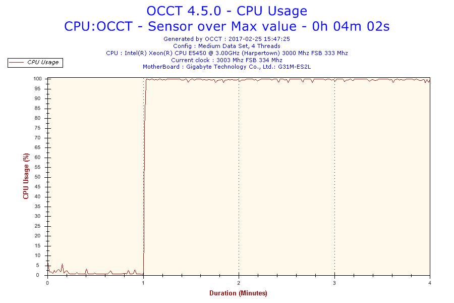

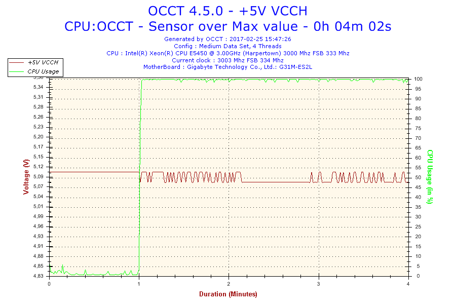

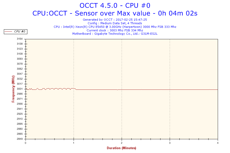

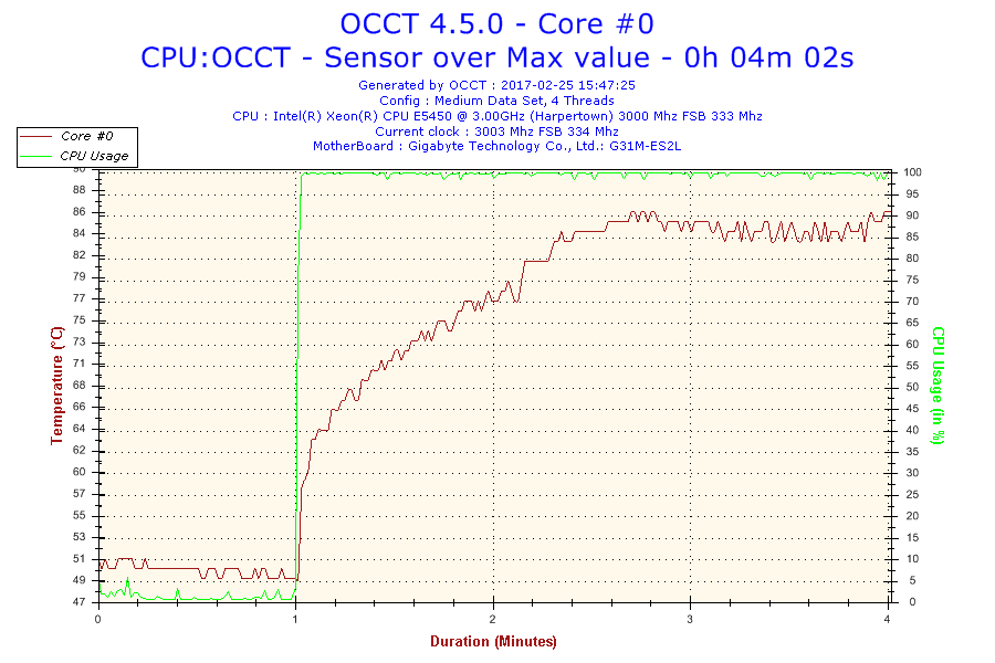

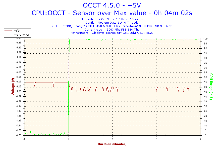

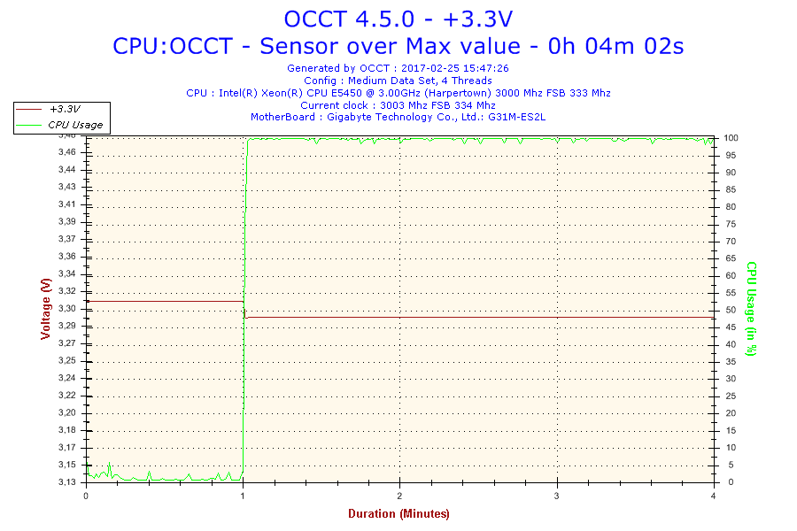

    I have a problem with CPU temperature and performance. At no load it is around 50 degrees, when playing it reaches 84 and rather does not rise higher (the lowest CS: GO settings; measured HWMonitor). During the OCCT test, the temperature exceeds 85 degrees and the test stops. BOX cooling, thermal paste Arctic MX-2. I have the impression that the processor (or maybe something else) is not stable, in the game you can feel performance drops, some cutoffs. How can you solve the problem? Replacement of cooling or maybe it's the power supply's fault? Below are the results from OCCT, could someone interpret them?
    I can say only about the power supply: BOX ATX 500W SFAN CE + PFC 12cm / FAN. Such information is on the computer case

    Hello, cooling is box, but from a different processor. It is too weak for this processor, its maximum allowable temperature Tcase is 67 degrees (so on the cores it will be maybe about 75 degrees). If the housing does not provide adequate ventilation, it will also be warmer in it.
    Information on the power supply can be found on the power supply itself.
    A Power Supply test would be more useful than a CPU - the PS test will also heat up the graphics card.

    Temperatures are good or too hot (I don't want to count). Generally it is Xeon on a modified disc. HWmonitor is a moron ancient program that should be removed from the network but dinosaurs still love it.
    Install HWiNFO and run in "sensor only" mode. At the core temperature, right click and set Tjmax to 85 degrees. The core temperature readings in this cpu on this board are just speculation. As already be guided by the CPU temperature reading from the motherboard.
    With HWiNFO in the background, run 10 minutes of the power supply test. In the OCCT settings turn off the test stop after exceeding the specified temperature or set the core for 95 degrees. After the test, give screen from HWiNFO.

    In order for the results to be reasonably real, you need to set the correct TjMax in the temperature monitoring program. e.g. for E54XX it is 85 ° C
    PS. Everything is OK.
    PS2. Although on this BOX ATX 500W SFAN CE + PFC 12cm / FAN - no matter what set would be powered, I would be afraid.

    Temperatures are not tragic. You can think of a bit more efficient cooling. However, the first thing I would do was replace the power supply. Have you ever checked the voltage on it ??

    With such a weak power supply, I wouldn't risk too extreme tests. Damage to the power supply may result in other components.
