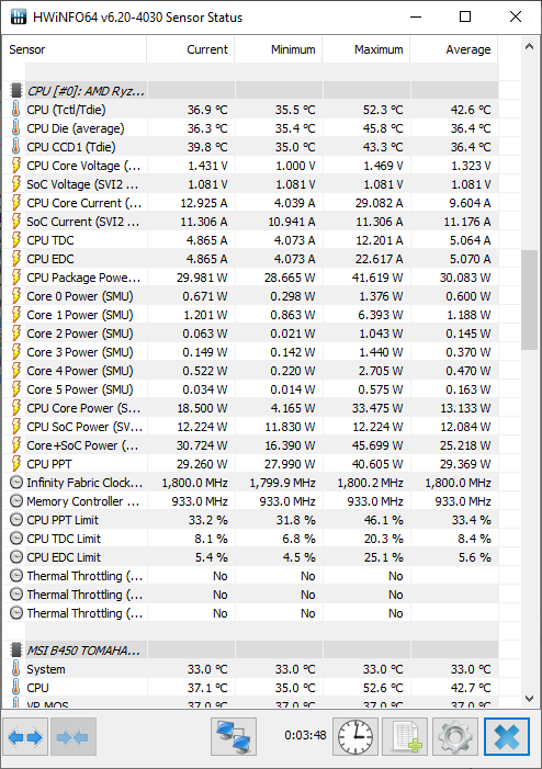

    Today I put together a new setup and am puzzled by the sudden temperature spikes on the CPU. Ryzen 6 3600, SPC Fortis 3 v2 cooling, Grizzly paste. HW Monitor shows me in idle around 32C, but when I fire up even a browser, the spikes start. Within 1-2 seconds the temperature can jump to 50C, drop to 40C, in a moment 30K, again 40+, 50+, 30.... etc. It seems physically impossible to me that the temperature can jump +/- 10-20C in a matter of seconds. Is this possible or more of a sensor or app error? The fan is consistently spinning at 670-770 rpm.

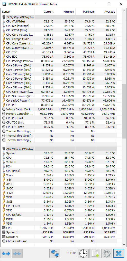

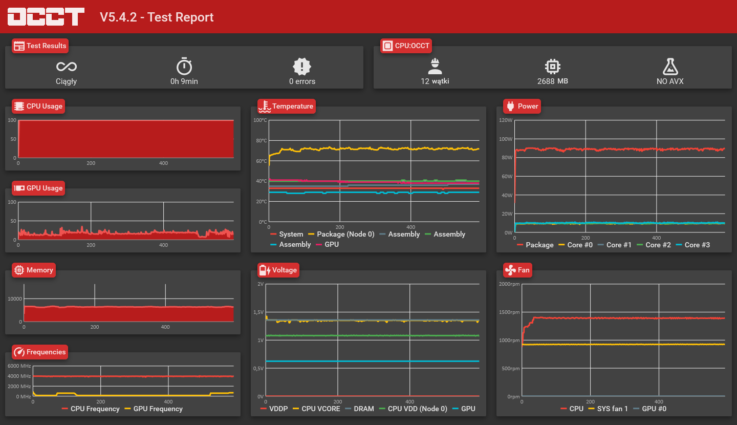

    WHiNFO64 at idle. OCCT after 10 minutes of testing. Max 73.8C, but almost all the time the temperature stood at 72C. The fan sped up to 1400 rpm. After turning off OCCT the temperatures dropped by more than 20C literally in 3 seconds...
    So I wonder.... Maybe I gave too much paste? It slightly squeezed out from under the heatsink. Not enough to spill all over the board, but a slight "overhang" formed around the CPU. Tightened up decently, more is not possible.

    Well, so I took off a little paste. And actually quite a bit - this time I just gave a small "grain" to the middle of the CPU. Temperatures are even worse; in idle they hit 40C, in OCCT up to 74C....

    Completely nothing has changed. Only the temperature increased by 1-2C on average, but it continues to jump whenever I load the CPU even for a moment (for example, opening a browser). It is possible that this time I gave a little too little paste, because I don't have much left.... I'll still try tomorrow with the paste added to Fortis - this time in the right amount.
    But I don't know if this can be the main cause of the problems.... Somehow I doubt it.

    With these MSI MAXes you have to be careful because they seem to have inflated voltages for the CPU in AUTO mode.
    MOrtax max I have I don't know what the voltage is, but in AUTO it is certainly inflated - I do not know whether as much as indicated by hwinfo that 1.55V, but it is quite a lot and this voltage has the greatest impact on the heating even when you do nothing.
    Paste should be given rather not too thin - I do not know how this your Fortris 3 but Grandis has a convex base so in the middle it presses and after the countries break. Although I don't worry about it.
    I wouldn't worry about these jumps. Check how much HWINfo shows the TDP for the VRM - preferably screen with PRIME95 running in the background + fire up the software from MSI for OC under windows and set the test (With prime running in the background) lower voltage and not set to AUTO. Test until it doesn't get rash.

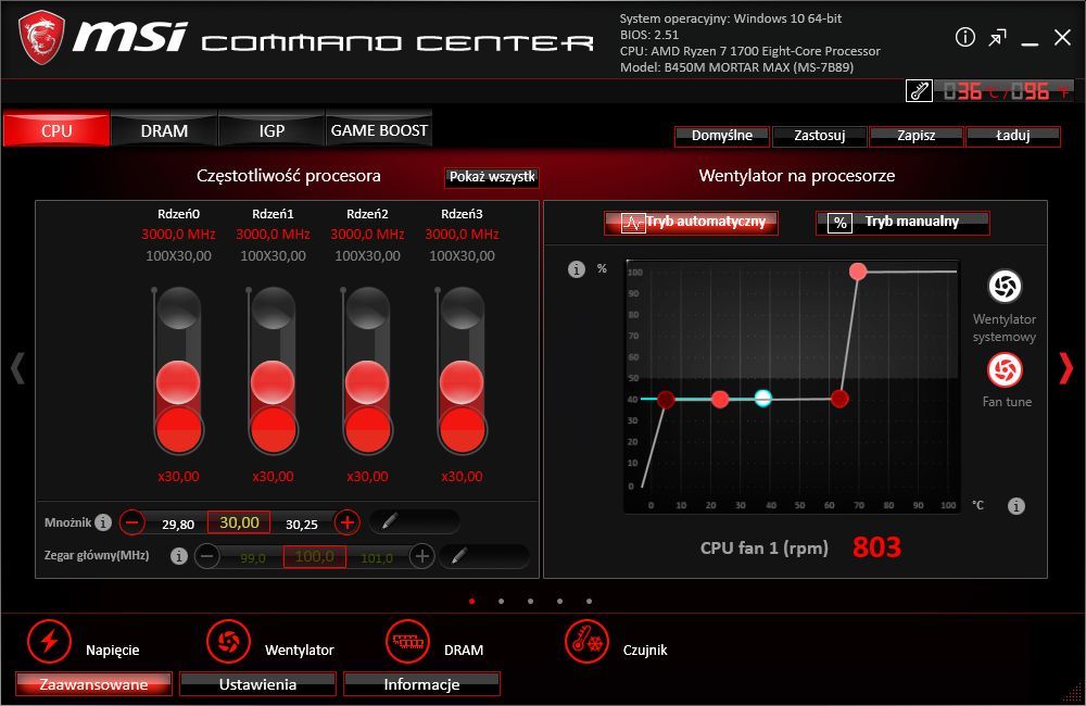

    Generally OC control with these MSI from under windows as far as my eye is a failure. If I don't manage to add the CBS tab to BIOS then OC from under windows is the biggest failure I've encountered, really GIGabyte has CBS, ASUS was able to do it better too and MSI didn't give CBS rally there's no way to set p-stats just force fixed voltage. What's funnier changing the voltage from its own to deafult causes a BSODA...

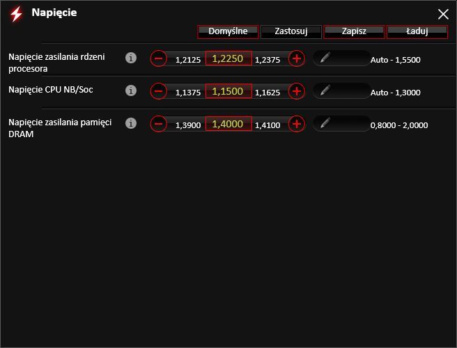

    Screens after applying OC yesterday and undoing it (so much that the voltage has to be manually lowered) - no longer CPU idls. Voltages so roughly set of course.

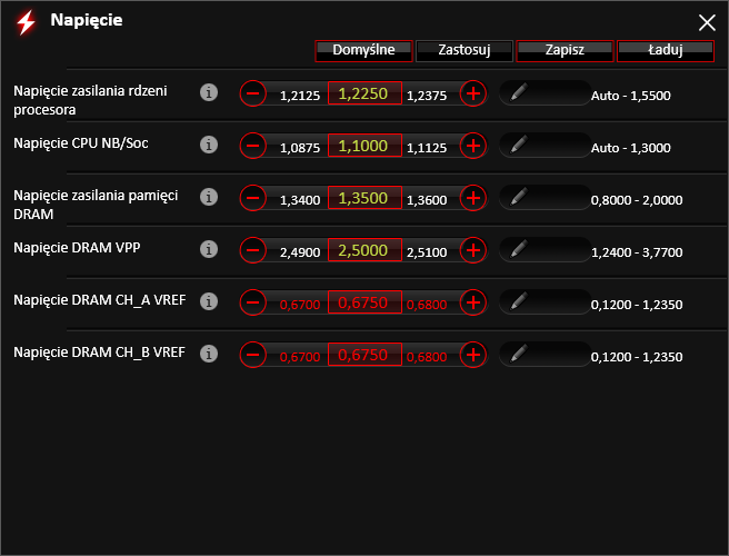

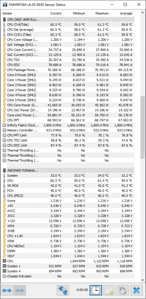

    Hmm... At my place the voltages are currently as shown below. By default only the first position was on Auto. Then the voltage on the core jumped from 1.0xx to 1.4xx and with it the temperature jumped. After changing it to 1.225 it looks ok I think? Screen shots from HWiNFO before the voltage change and after the change. In idle the temperature does not exceed 40C (usually 36-38C). After 10 minutes of OCCT max 62C, average 60-61C. Acceptable
    Till now I have not yet given new paste. I'll replace it when I buy Grizzly.
    Apparently, there are no stupid questions.... But lowering the voltage on the CPU will not cause a drop in its performance?
