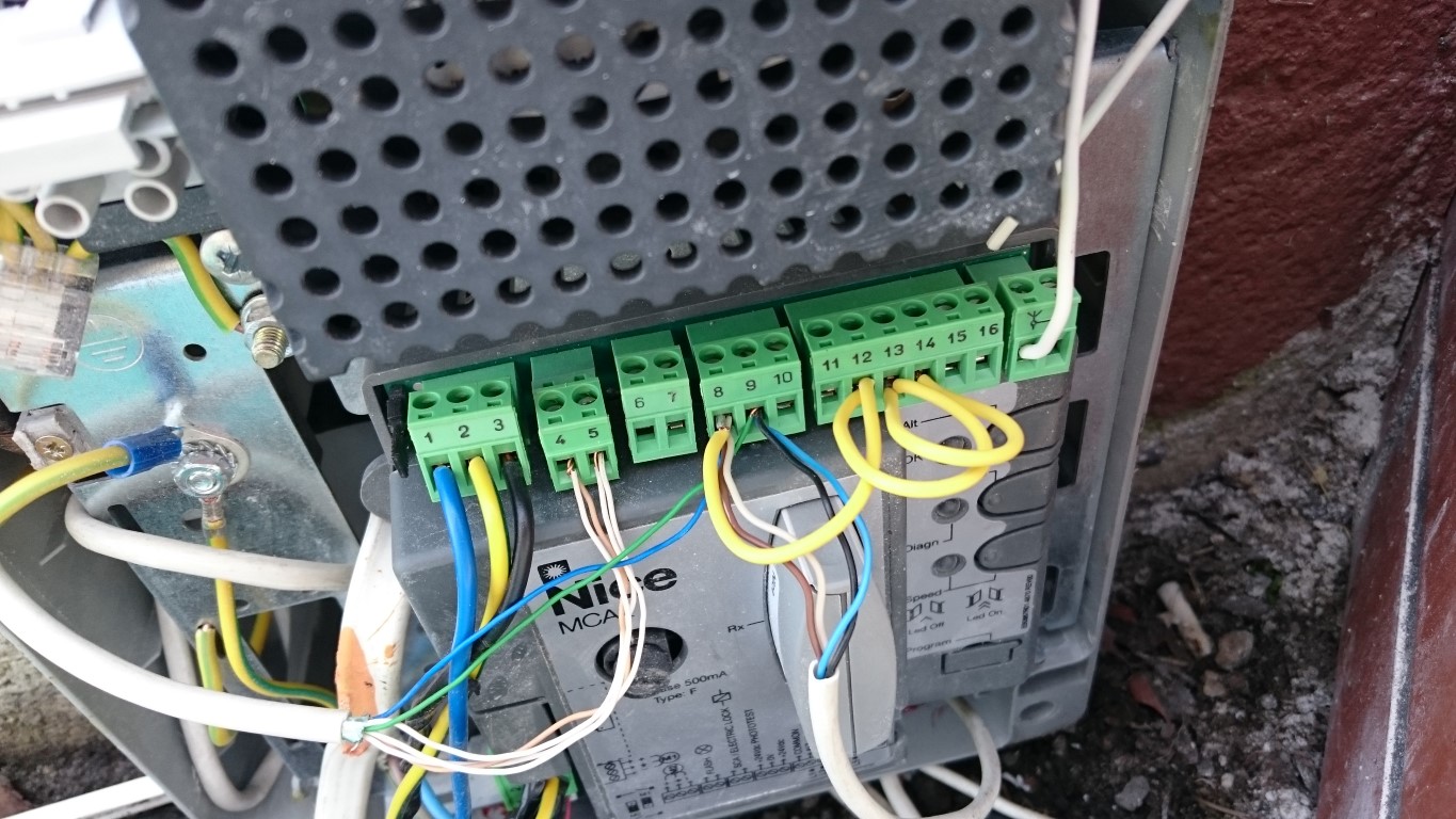

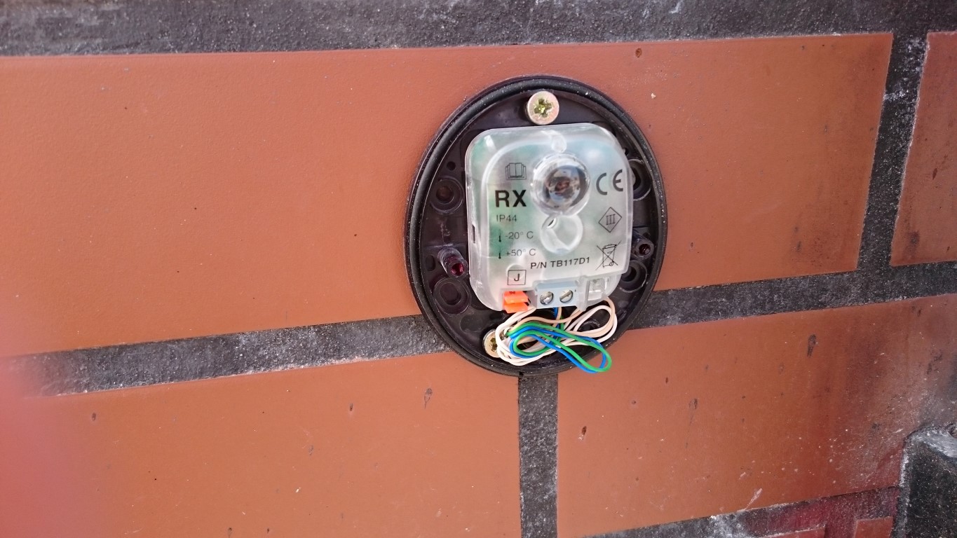

    Could someone help me finish the assembly, everything is already working, set only with photocells, I have a problem.
    After connecting, 3 quick flashes followed by a second pause, i.e. - the device has not been recognized by the control unit.

    Forget it, you can't, I mean it's possible like you've already done it, but it won't work as you stated yourself. You have blubus photocells, and this control unit does not recognize them.

    As the previous speaker wrote ...
    You have MOFB photocells and you should have MOF or BF or other "normal" photocells (third party) ...
    Did you complete the set yourself, did someone "wise differently" help?

    I assembled myself - unfortunately, I did not expect that the photocells might not fit - it's a simple design. I was buying remote controls, a receiver from one supplier, and he had only such photocells.
    Please advise to buy NICE or "normal" eg AG574 for 30 PLN - do you have any experience?

    AG574 will also work ...
    You can choose from differences in brand, price and (perhaps) quality, although both can last for a long time and damage themselves ...
    If you choose MOF Nice, you won't have to change the housings and drill new holes. You move only the inserts.

    I ordered AG574, I will make holes in the housing, so I will not drill new holes in the wall. Could I have some suggestions for connecting the AG574 to the MC424?

    grzechotnik wrote:
    My suggestion is that you connect them according to the instructions.
    So in Polish:
    -you connect in the same way as if you connected the original photocells Nice MOF or BF according to the instructions for MC424 ..
    In AG, you do not have the NO terminal in the receiver, which is in Nice, but you do not connect this terminal anyway.

    Simple and to the point. Thank you for your help and explanation.
