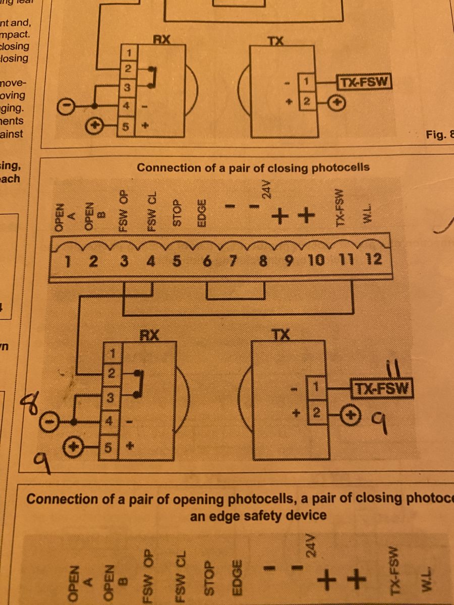

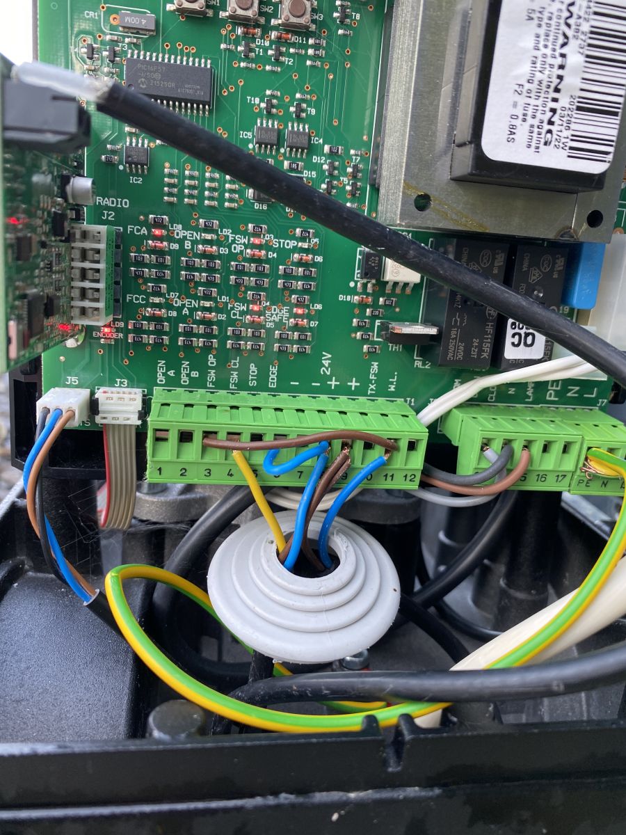

    I have connected the motor and photocells as per the diagrams. The remote is also connected, yet when pressing the remote, nothing happens. All basic programming is correct too, but there is still no response from the motor. Any thoughts on what might be wrong here? Thanks.

    Is there a wire between the terminals 5 and 7 (or 8)?

    The basic question is whether the remote control has been read into the radio ?
    Were the photo2 and STOP inputs bridged ?
    Insert the diagram according to which you connected and preferably some photos of the connection of the control panel and of the LEDs that are lit or not on the control panel.
  • #4 20855503
    MMM31
    Hi, many thanks, diagram from the manual that I followed attached, certainly no bridge so perhaps the manual should be clearer.

    Solved, thanks for the note regarding bridging 5 to 7, all now working as initially expected.

    There must be a wire between 5 and 7
    it is not in Figures 4-9 but is in Figure 2

    So STOP, but that`s how they draw the diagrams - if you look at the photos, there is no bridge in the diagram and this often confuses amateur installers because the diagram regarding the stop terminal is earlier.
  • #8 20867386
    MMM31
    Bridged the two contacts as described
