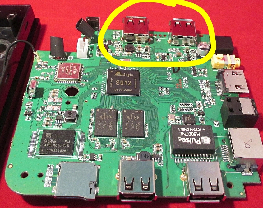

    I recently bought a popular Chinese TV box H96 Pro + on the S912 CPU, with the idea of connecting to the old TV under SCART at the moment.
    The problem is that the Chinese do not add an AV cable to the set.
    From what I see on the PCB, the Jack socket is on 3 pin, and in my opinion it should be 4 pin (GND, Video, Audio L + P).
    Did anyone have to do with connecting this type of TV set?

    Hey, you had to read from some other model there are several variations of this Tv Box.
    (Trapped between power and HDMI - AV:])
    Mine is just like on a photo, like a bull's AV output.

    And, more or less, my box looks inside:
    Connecting H96 Pro+ Android TV Box to Old SCART TV: A Practical Guide Connecting H96 Pro+ Android TV Box to Old SCART TV: A Practical Guide Connecting H96 Pro+ Android TV Box to Old SCART TV: A Practical Guide
    Added after 13 [hours] 15 [minutes]:
    OK, everything has cleared up, it is a short circuit of the Video signal to GND on the prock side, so the Chinese kachana sent a damaged sell.
    The correct distribution of signals should look like this:

    According to the description and photos of this box, it has 2 x USB type2.
    But in the pictures for AoT_Hunter on the board there are 4 items (2 USB hidden)
    Hunter, can you confirm it and are they fully functional?

    Hello, yes I confirm are hidden, just cut out the holes and you have extra :)
    The box is really efficient in its class.
