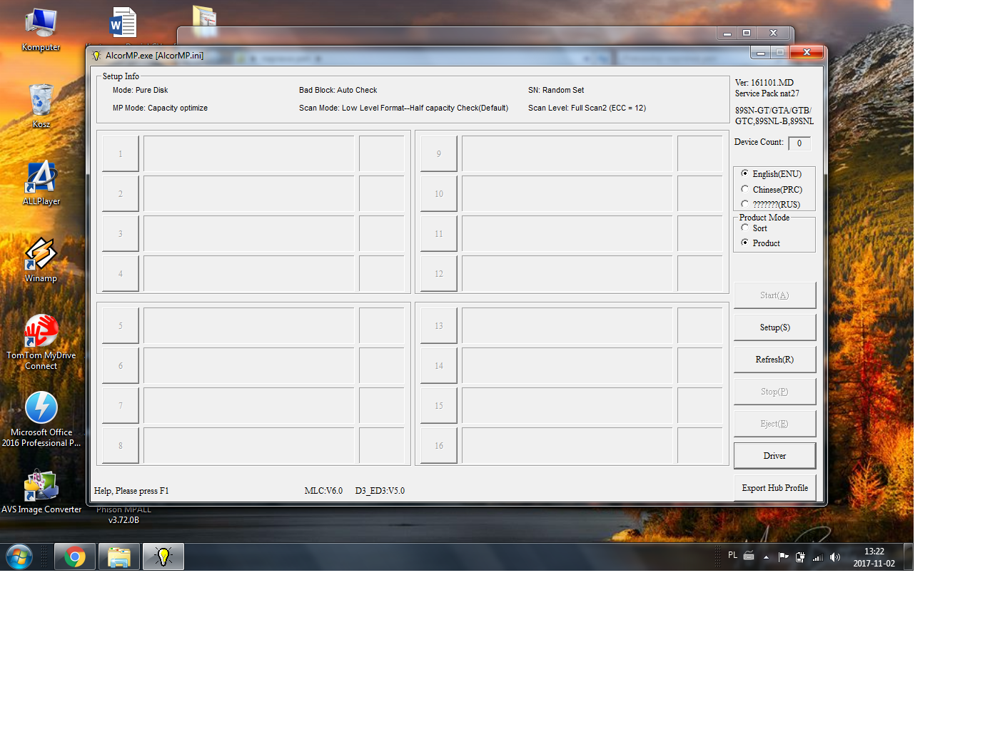

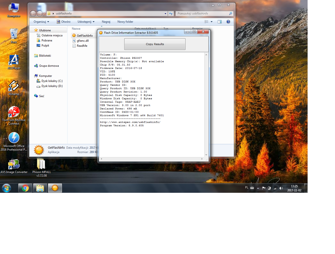

    Hello, my problem is a complex one after the flash drive responded badly to Restore 3.21. To start with, I wanted to format kingston because I couldn't copy the content from it and here I got the message "the disk is write protected". After a few days of page flipping I found the program Restore_v3.21.rar; size: 3 279 982 bytes, which I downloaded from http://www.usbdev.ru/files/phison/phisonrestore/, after which I cannot see the device but detect it.
    This is what ChipGenius v4.00 sees
    Description: [F:] USB mass storage device (USB DISK 30X)
    Device Type: Mass Storage Device
    Protocal Version: USB 2.10
    • Kingston DT50 32GB restore fail please contact your vendor.error code:-2 2.png (1.19 MB) You must be logged in to download this attachment.
    • Kingston DT50 32GB restore fail please contact your vendor.error code:-2 1.png (818.77 KB) You must be logged in to download this attachment.
    Flash controller detected, but NAND memory failed

    on 99% of the flash drive to be thrown away.
    Memory controller or memory itself failed. After so many unsuccessful attempts with various programs, I can say that nothing concrete can be done. Even if you manage to bring it back to life, fear whatever you hold on to it, because it may break again in a short time.
    You can see in the photos that the controller is detected, but it does not give the names of the memory cubes.
    Write protection is most likely due to exceeding the number of write cycles from memory.
    best regards

  • #6 16799566
    esirnus
    Hey, I was very sad about this news because I had a secret hope of getting fixed :(
    Here's what popped up.
    • Kingston DT50 32GB restore fail please contact your vendor.error code:-2 3.png (1.56 MB) You must be logged in to download this attachment.
  • #7 16809769
    pidar
    Posts: 11363
    Help: 1569
    Rate: 3590
    And the assigned letter which was not entered :?:
  • #8 16812019
    esirnus
    And sorry, I'm already improving :)
    • Kingston DT50 32GB restore fail please contact your vendor.error code:-2 1.png (1.47 MB) You must be logged in to download this attachment.
  • #10 16816964
    esirnus
    I consider the topic closed, no more, thanks for the pidar, you are great
