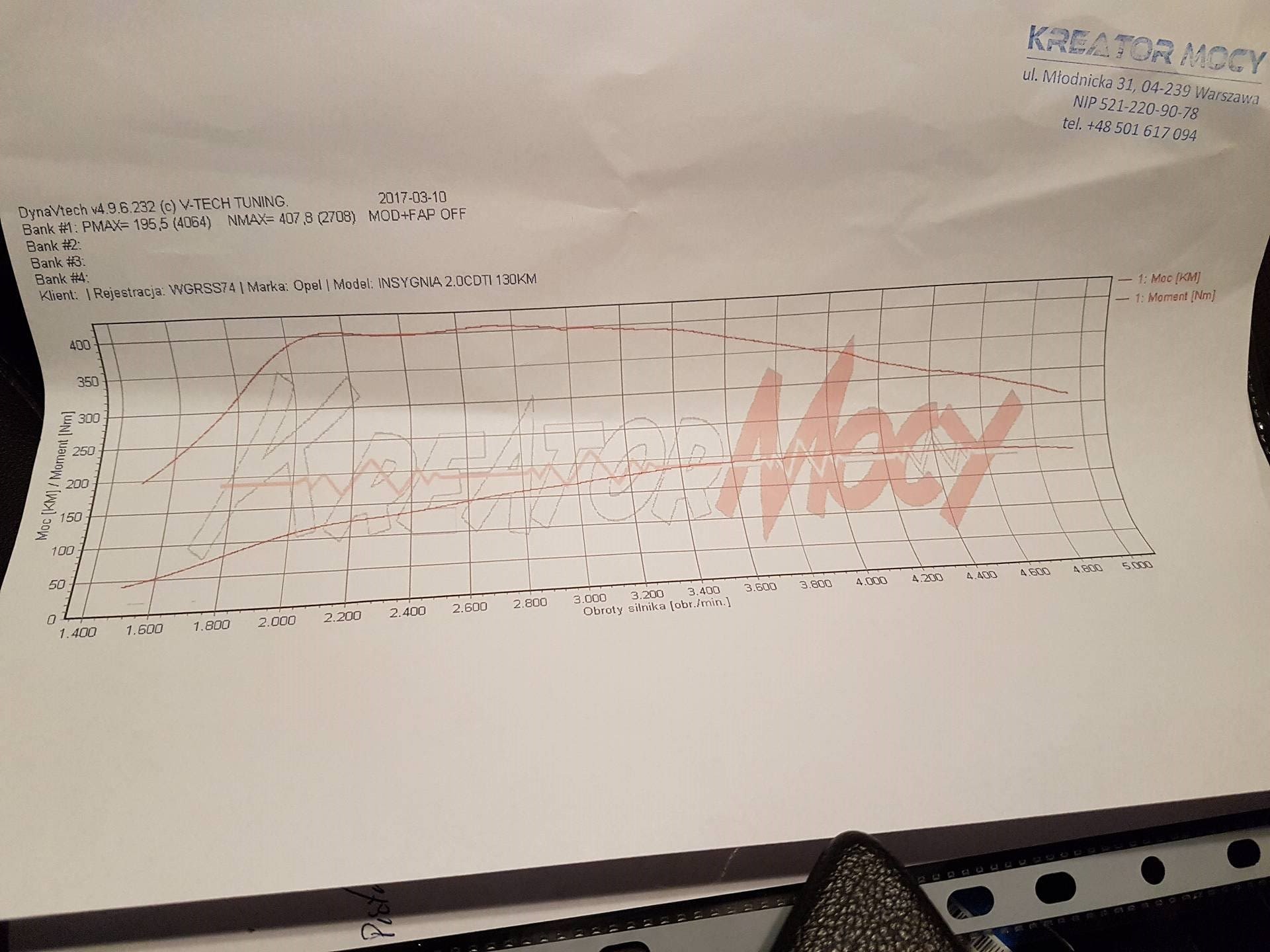

    Hello, I have a problem regarding safe mode.
    Engine 2.0 130KM mileage about 193k, car after chip and removal of DFP in Power Wizard in Warsaw.
    While driving, it can fall into emergency mode and drives like an old skoda, lack of power, but it happens that when driving out of this mode and begins to drive normally.
    On the computer there is no error at the mechanic, I went to the KM and found that there may be poor fuel pressure. Filters replaced + oil, for about 1k km nothing like this happened, but today returning from work again was a lack of power, and not being able to pull over anywhere to turn off and start I drove on and again after about 2 km the car started to drive.
    What could this be the reason?
    Badly made chip? EGR valve? Or something else?
    I will upload a scan chart from the dynamometer later, it may be helpful.

  • #20 17250644
    adam4797
    Posts: 9
    The matter is resolved, I'm just letting me know now. It turned out to be a differential pressure sensor. It was dismantled completely due to the fact that the car does not have DPF anymore and everything is going well.
