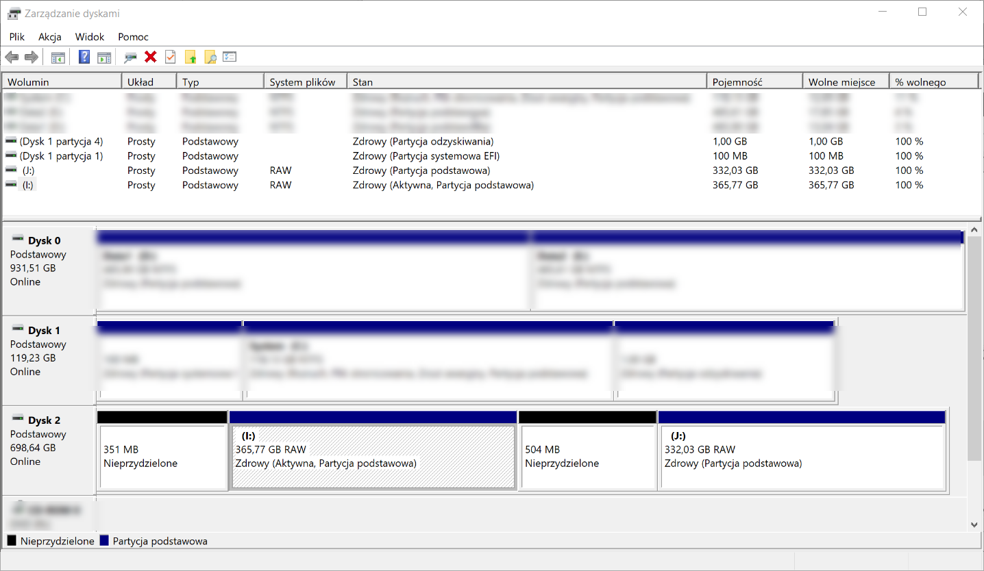

    I apologize in advance for a new post on a similar topic, but looking through the others, I can't really find a solution for myself.
    The drive lost partition tables possibly on removing the USB cable from the socket without safely removing the hardware.
    It is a drive removed from the laptop and now used as an external drive. It had two partitions with files "I" and "J".
    After opening vol01 and vol02 the file structure is correct and recoverable (individual files).
    My question and request for help in restoring the partition structure, if possible after analyzing the data below.
    Thank you in advance and at the same time asking Admin to create maybe a tutorial in the FAQ for posterity. :)

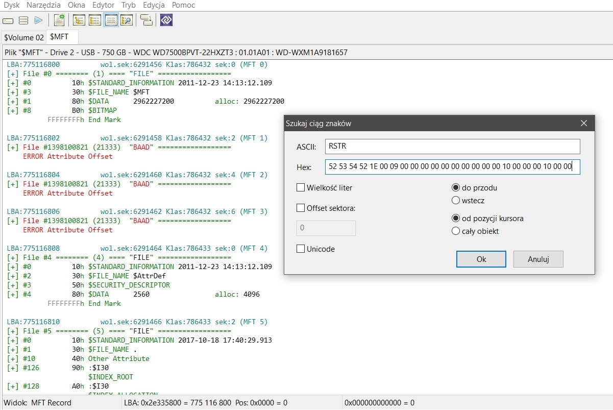

    Scans from DMDE:

    Attach these bad sectors to the file - $ MFT fragments (3 files: 1 - sectors 7010304 - 7010313, 2 - sectors 7015370 - 7015377, 3 - sectors 775116800 - 775116809). They should be repairable. The disk has not lost its partition table and $ MFT is corrupted.
    EDIT: There is no tutorial. You need to know what is damaged and what to change. Not every case is the same. You have damaged 3 out of 4 records of the 0 $ MFT cluster in both cases and two more records. It is not known if there is more damage.

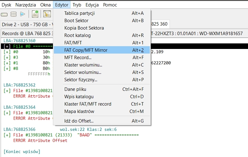

    Looking at the window with partitions from where so many of them! And in addition, the unallocated 368MB and 529MB space is it left over from using a laptop? Can they be used in the future?
    Edit: Is this a $ MFT mirror?
    Restore NTFS partition from RAW in external USB drive after disconnecting power Restore NTFS partition from RAW in external USB drive after disconnecting power
    MTF Record:

    Show $ MFT mirror for these partitions. The damage is of such a type that, however, all of these sectors are probably lost. The first partition looks virtually empty, but the second has millions of files. For the first partition, the data will definitely be faster. For the second, you can try to rebuild these 6 sectors, as long as $ MFT mirror also contains incorrect data. Is there any 5,800,000 files on this second partition?
    EDIT: It seems as if it is supposed to be the same. $ MFT mirror start cluster 2 - ok I saved.
    EDIT2: You have the file $ LogFile to find, give its starting cluster or disk sector where it starts by searching from the beginning of this partition with the following hex string in DMDE: 52 53 54 52 1E 00 09 00 00 00 00 00 00 00 00 00 00 10 00 00 00 10 00 00

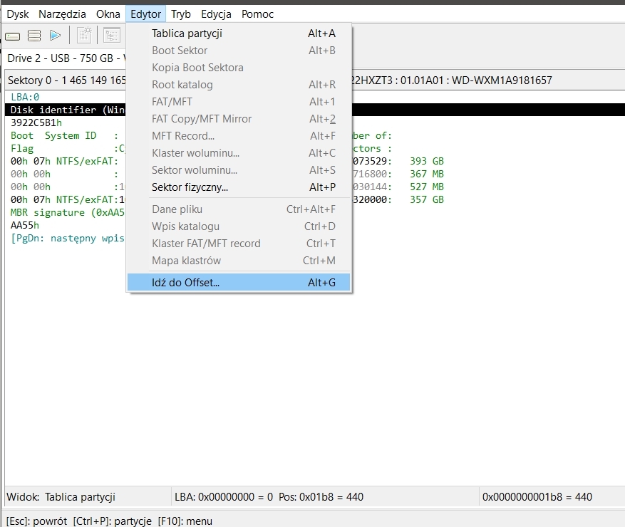

    5. I select the disk - I write down the starting sector or approximately, for me it is enough to remember 768 000 000.
    6. I close the "Partitions" window.
    7. Go to Editor -> Go to offset
    8. I enter the value - 768,000,000.
    9. After that Ctrl + F and type: 52 53 54 52 1E 00 09 00 00 00 00 00 00 00 00 00 00 10 00 00 00 10 00 00
    score:
    10. As you find, write the LBA value or paste the screen.

    You write down the starting sector or approximately, for you it is enough to remember 768,000,000. You close the Partitions window. Go to Editor -> Go to offset and enter this value. After that Ctrl + F and enter: 52 53 54 52 1E 00 09 00 00 00 00 00 00 00 00 00 00 10 00 00 00 10 00 00. As you find you write the LBA value or paste screen. After that, Ctrl + F and this time try to search: 46 49 4C 45 30 00 03. If you do not find this string quickly, you can skip the next search, because above 5,000,000 LBA from this point, you don't even have to look, because then it will find fragments of $ MFT and not $ MFT classes. 0 in $ LogFile.
    You can also check the offset and specify 0, because it can find not only $ MFT classes. 0 in $ LogFile.
    EDIT: It was supposed to be 768,000,000 from the sector, not 1,500,000, because that's how it would make no sense to wait an hour, and today I have little time, max 30 minutes. A colleague entered the value 768,000,000 in the offset, not the sector, hence the mistake of the beginning of the search area (sector number = offset / 512 - hence we got 768,000,000 / 512 = 1,500,000 sector)
    EDIT2: Switch to hex view, because I don't know what is in the attached screenshots. Possibly tomorrow after 3pm through TeamViewer, because something is slowly going.
    EDIT3: As previously noted, maybe everything is ok (although the last one doesn't look like a copy of $ MFT. 0 classes, but you will see, just put it in the hex view, not the partition table.

  3. Press Ctrl+F and search for 52 53 54 52 1E 00 09 00 ... to locate $LogFile. [Elektroda, mati211p, post #16777085]
