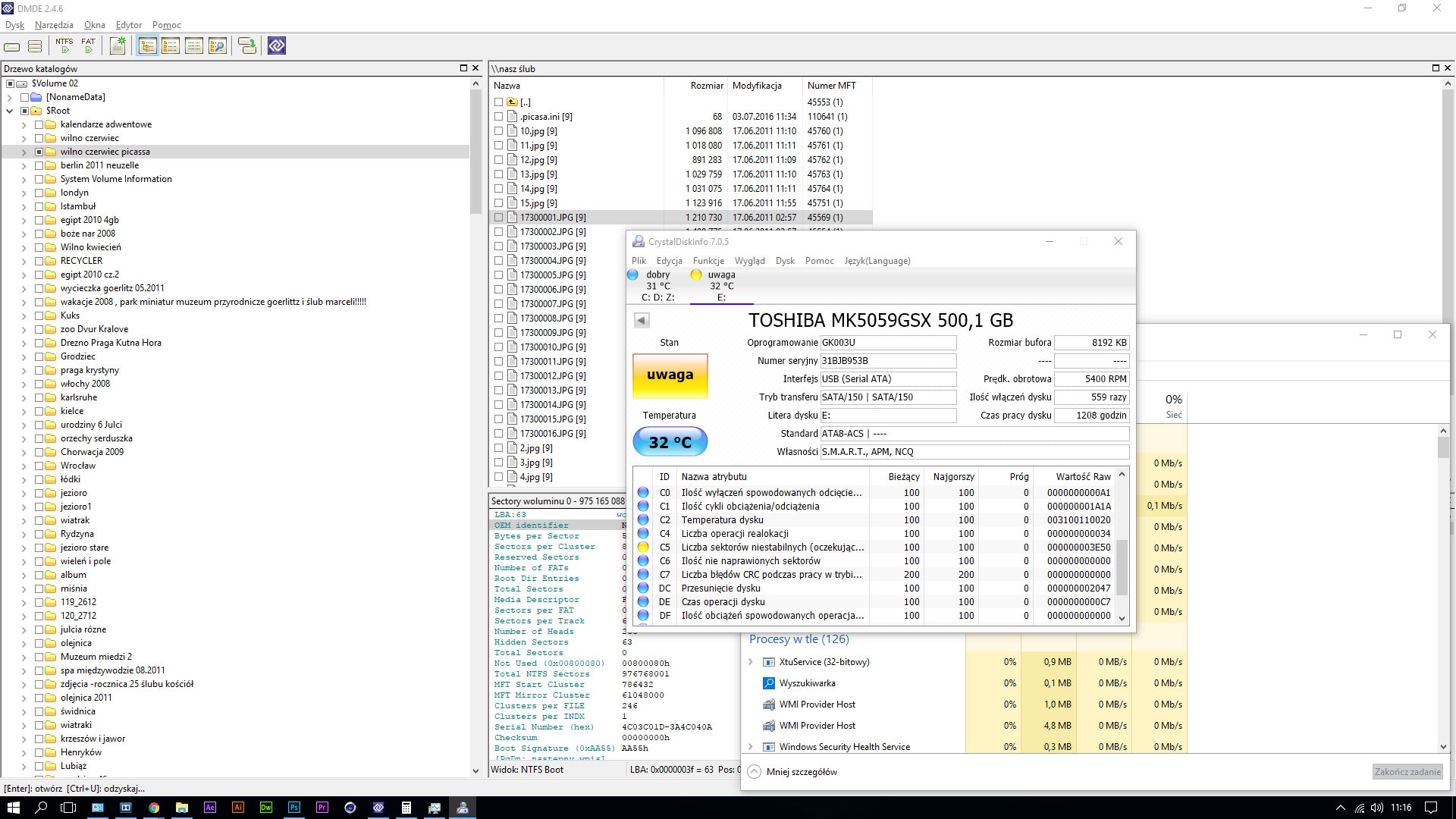

    Well. Then I post a screenshot from CrystalDiskInfo.

    SMART places itself all not fragments. Didn't you think to stretch the program window? Correct these screenshots!
    Anyway, even after these fragments you can see that the disc is scrap.
    Make a sectoral backup and recover from it, because you will tire the disk to the end.

    It looks like a huge number of bugs. There is no point in SMART re-inserting, the disk to be replaced, data to be ripped through a sectoral copy to a new disk and only possible recovery. Additionally, it is connected via USB, which will slow down the backup process and may result in disconnection of the disk and incorrect copying over time.
