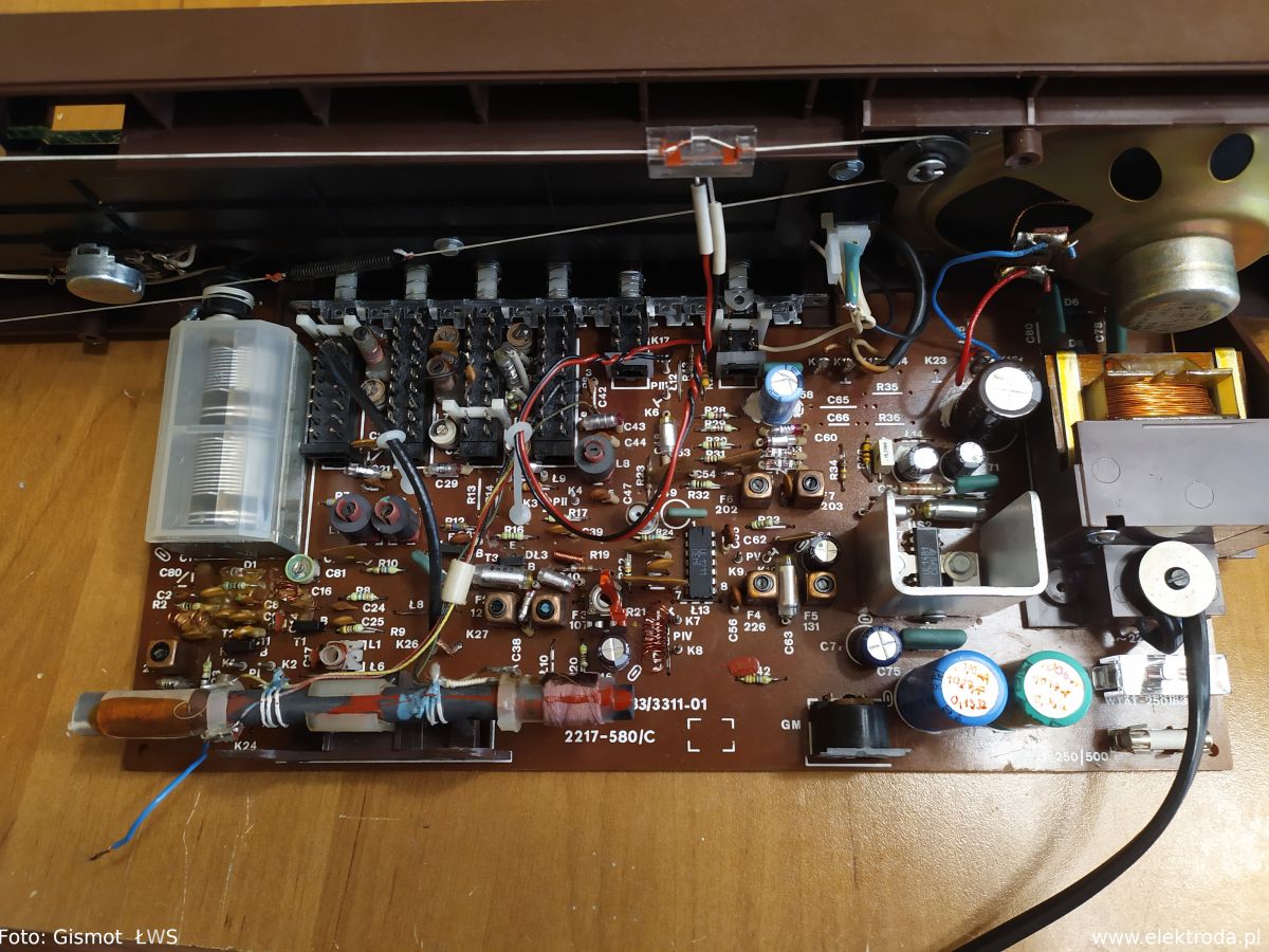

    The electrolytic capacitors, which may have to be replaced, are glaringly visible.
    You can already start looking at the interior - you can see that there is a single Tonsil 8Ω speaker inside:
    Interior of an old Polish radio receiver UNITRA Sniezka R-207 .
    Above you can see the distinctive GM545 socket.

    The electronics PCB is fixed to the front and slides out of the case along with the front:
    In the photo above you can also see the cable and rollers and the tuning carriage - a mechanical arrangement.
    In addition, we can see that someone has rummaged around here before - an additional connector is plugged directly into the speaker.

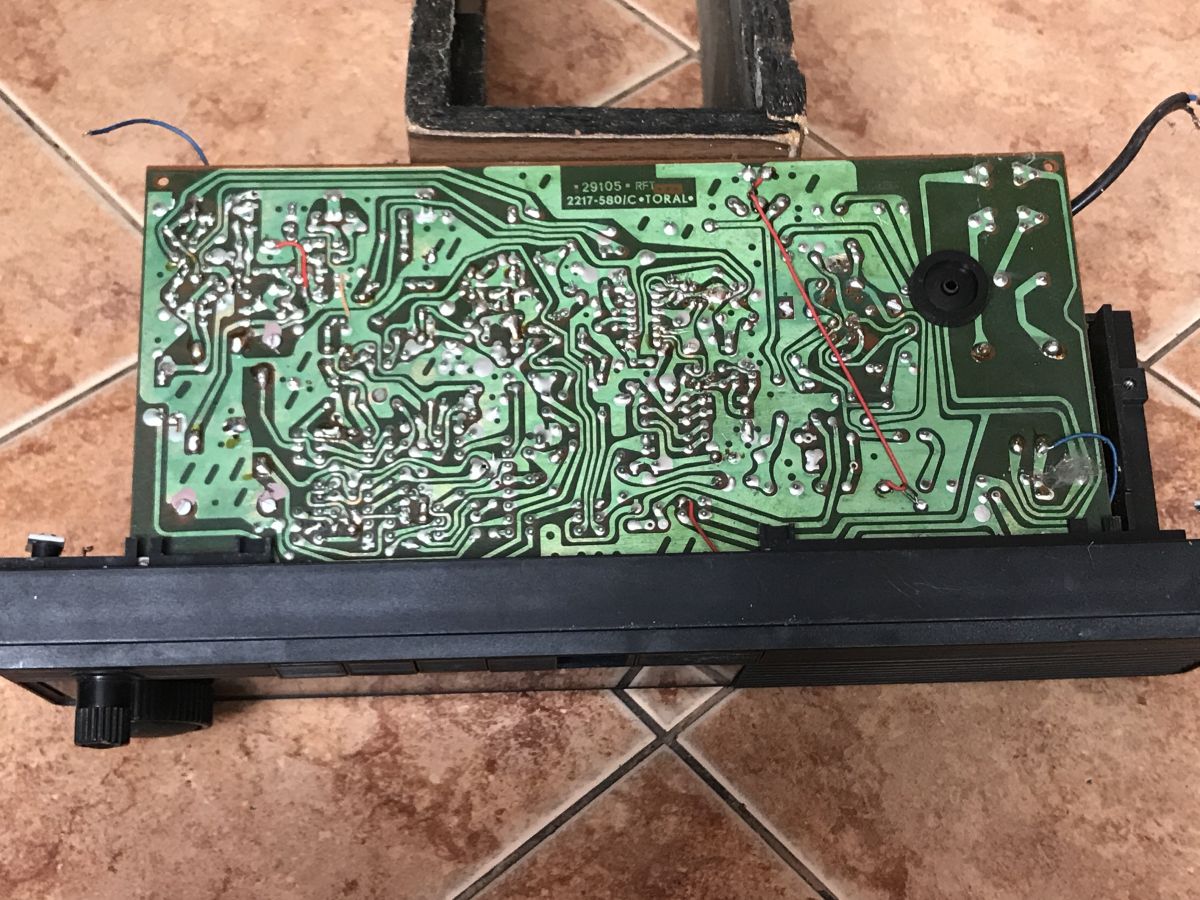

    PCB from underneath:
    There are two integrated circuits in the radio. PA210 by CEMI (6W power amplifier):
    UL1211 (also from CEMI), AM/FM intermediate frequency amplifier:

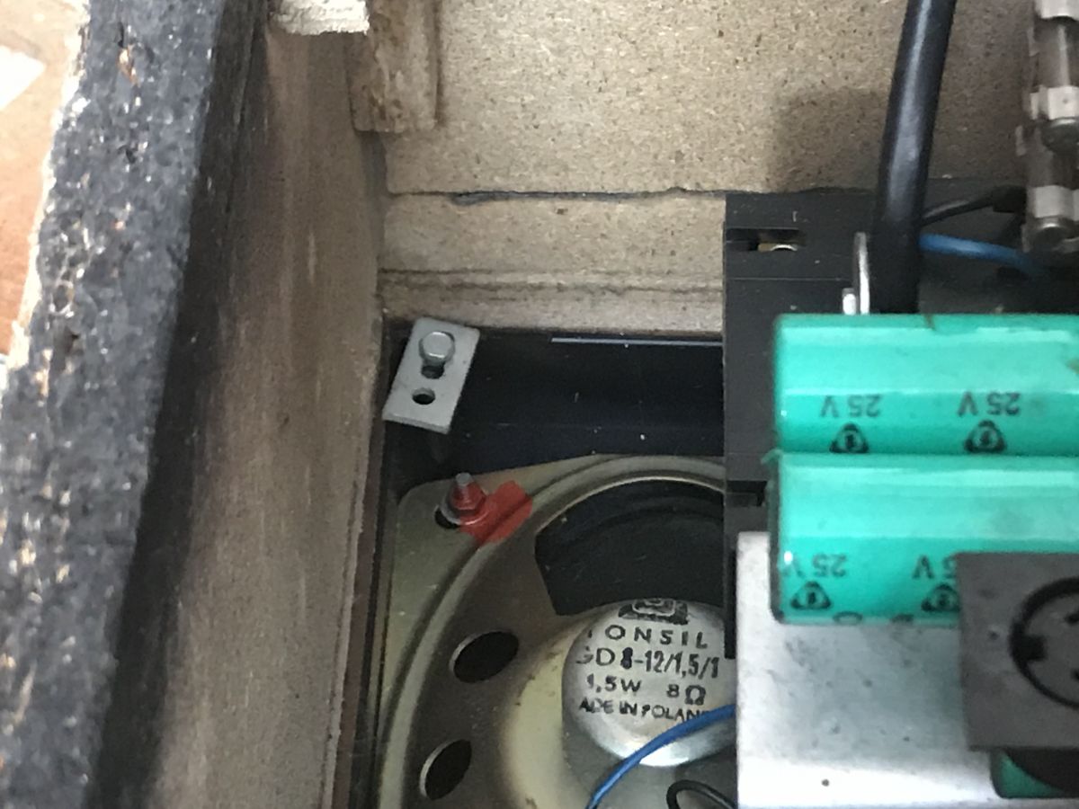

    The PA210 is the export equivalent of the UL 1481/1482. They used whatever they happened to wind up in the assembly :P .
    An external speaker socket added amateurishly and in a rather idiotic way - connecting anything there will be in parallel - in effect reducing the resultant impedance and may lead to damage of the HF amplifier . There were suitable domestically produced speaker sockets with a normally open contact when plugged in - you could cut off the speaker built into the radio in this way.

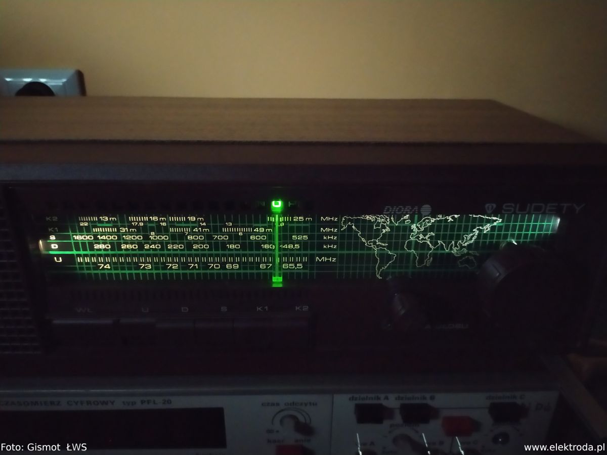

    The R-207 Snezka and R-208 Sudety radios differ only in the casing - the main PCB is the same. And I would forget the RE-320 Kalenica - the main board is the same as in the R-207 only they added a converter module and a clock.
    Unfortunately, a slight 100Hz hum in them is standard because the power supply is poorly designed, specifically the ground.
    The original design was as follows: bridge rectifier -> m.cz. amplifier -> and only capacitors C75, C76 smoothing the voltage in the power supply. The result: loud hum in the loudspeaker.
    The design error was corrected to some extent by shorting with an additional ground wire.
    I have marked it on the photo:
    So I wonder why the designers did not redesign the PCB?
    R-208 Sudeten
    Interior of an old Polish radio receiver UNITRA Sniezka R-207 Interior of an old Polish radio receiver UNITRA Sniezka R-207 Interior of an old Polish radio receiver UNITRA Sniezka R-207 .
    I know a hotel in Zakopane where the rooms are still equipped with R-208 radios, of course with UKF tuning, so the local radio station (Radio Alex) can be listened to - there is a climate :)

    flinc wrote:
    Adding in the subject line, adding a 75 Ohm input hot-mass socket
    After this modification the equipment will lose value ;) .

    Diagram of R-207, R-208:
    • Interior of an old Polish radio receiver UNITRA Sniezka R-207 Diora R-208 Sudety.jpg (576.49 KB) You must be logged in to download this attachment.

    Gismot wrote:
    You probably suggested the schematic from #1 post, unfortunately it is from R-206.
    I think you are indeed correct, although R207 is even carried on this schematic.
    I will correct the first post.

    He,he :) I even made a stereo decoder for it in the second half of the 80s, based on UL1621, described some time ago in Radiolektronik, the signals of both channels were output only to the cassette socket. It was great to listen to (and record) Tomasz Beksinski's Stereo Club, Bogdan Fabianski's Record Evenings and Songs on Request and other programmes on Channel 2 of Polish Radio, the only stereo programme at the time (at least in my town).
    I took the signal for the stereo decoder from the middle pin of the UKF switcher and ran it through a preamplifier on two transistors, as the signal level was too low to control the UL1621 directly. The top PCB of the sandwich is the aforementioned preamplifier, while the bottom PCB is the actual stereo decoder.
    And this is how the radio looked when playing a stereo broadcast.
    Best regards, KT

    Tytus Kosiarski wrote:
    He,he :) I even made a stereo decoder for it in the second half of the 80's on UL1621 described some time ago in Radioektronik, the signals of both channels were output only to the cassette socket. It was great to listen to (and record) Tomasz Beksinski's Stereo Club, Bogdan Fabianski's Record Evenings and Songs on Request and other programmes on Channel 2 of Polish Radio, the only stereo programme at the time (at least in my town).
    Regards, KT
    Well I wouldn't have guessed that something had been reworked if you hadn't written :) . I myself have only two radios Ania R612 and Dorota IC and also a mister hit gramophone. And one tube Philips B4S62A. For the Ania it needs a knob for the range switch. Maybe someone has and wants to sell? Greetings.
