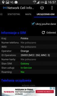

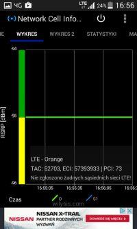

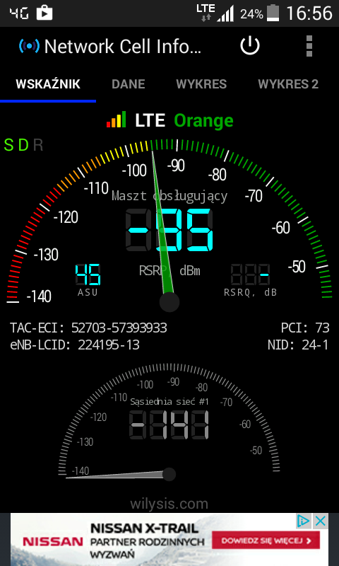

    I called orange, they say that they have active 800 MHz lte, tomorrow it will jump to the antenna and I will check this program personally, but I can not find the option to force 800 MHz in it. Well, I wanted this MF286, I waited a month for it and they didn't have it in stock, so I was forced to choose the MF283 +. Tomorrow, when I check, I will contact you, but I don't know whether to insert screenshots for you or do you want any specific data?
  • #6 16468632
    matek451
    Posts: 31253
    Help: 4352
    Rate: 5808

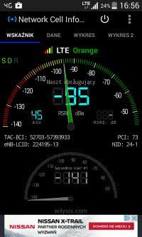

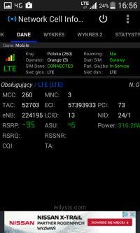

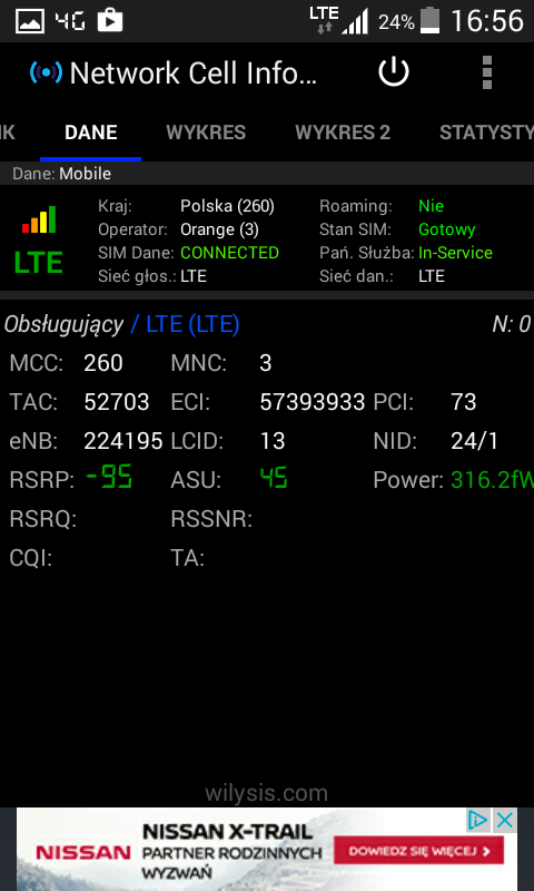

    You do not have to force the LTE800 band, possibly only LTE800 works in Szydłów, the license for LTE1800 under NetWorks and LTE2600 does not work. Show the screenshot from under this BTS.

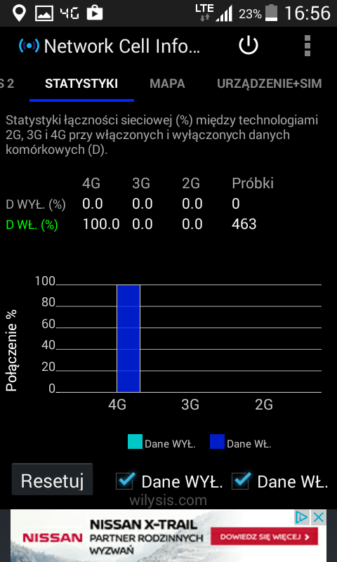

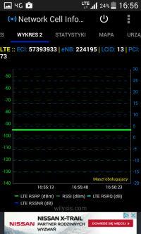

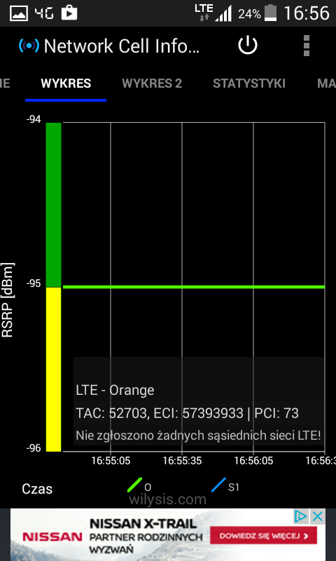

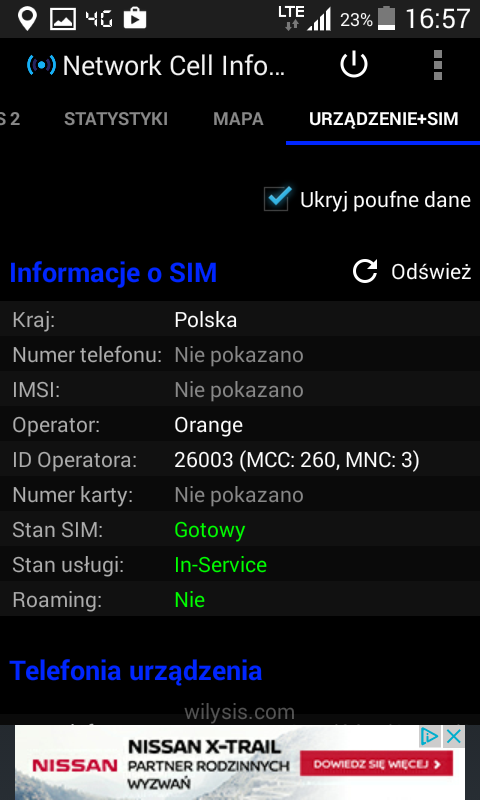

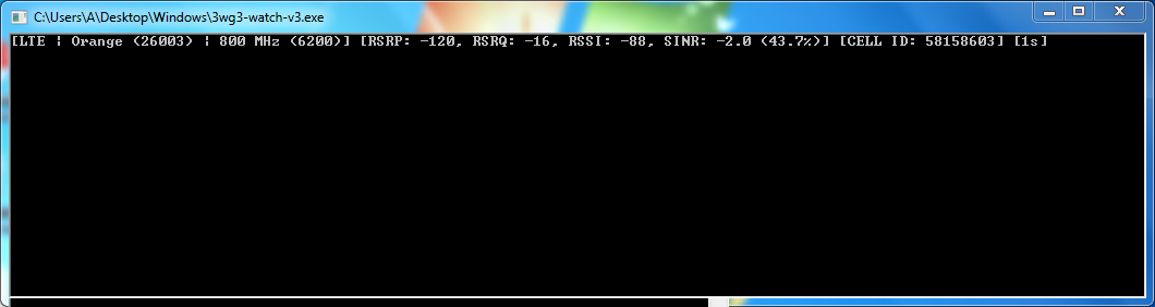

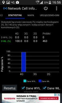

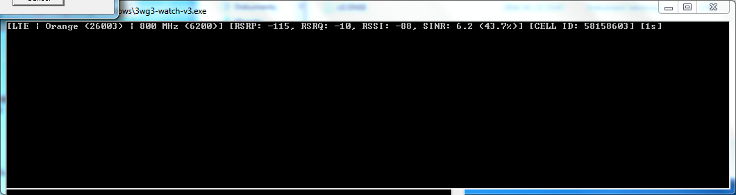

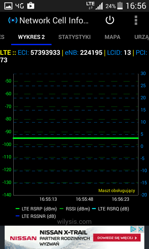

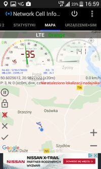

    Indeed, in Szydłów, as you said, only 800 MHz works, I throw you the screens you asked for
    Choosing the Right Antenna for ZTE 283+ on LTE 800 MHz: Factors, Options & Improved Performance

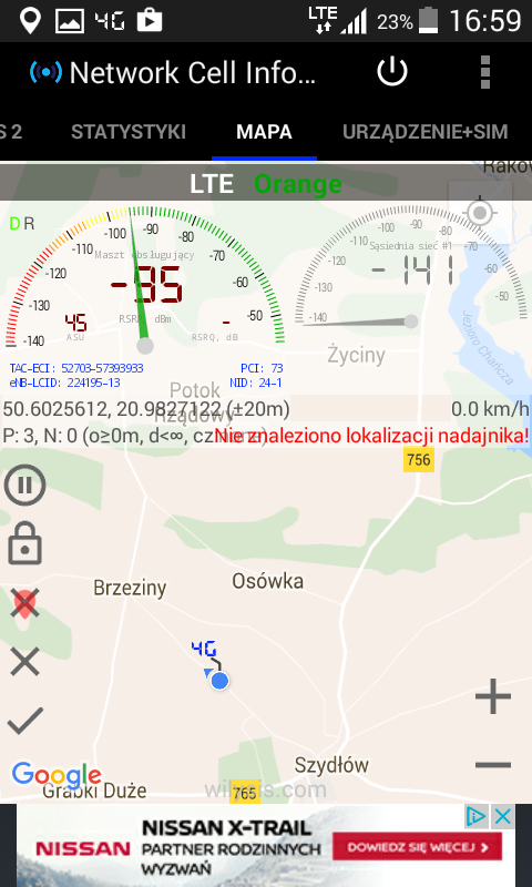

    and here with the map, although I do not know why, but I was under almost the transmitter and I wrote that the transmitter cannot be found, maybe they do not have it there yet in the database of this program, I have no idea
