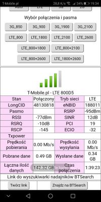

    The Zte info program does not show anything, I have a small huawei e 5377 router at home and I went to the roof with it, such signal parameters were shown by the huawei manager.
    This is the best that was achieved on the roof. ZTE MF286 Router Antenna Recommendations: Strengthen LTE Signal at 800MHz, 7.4km from BTS
