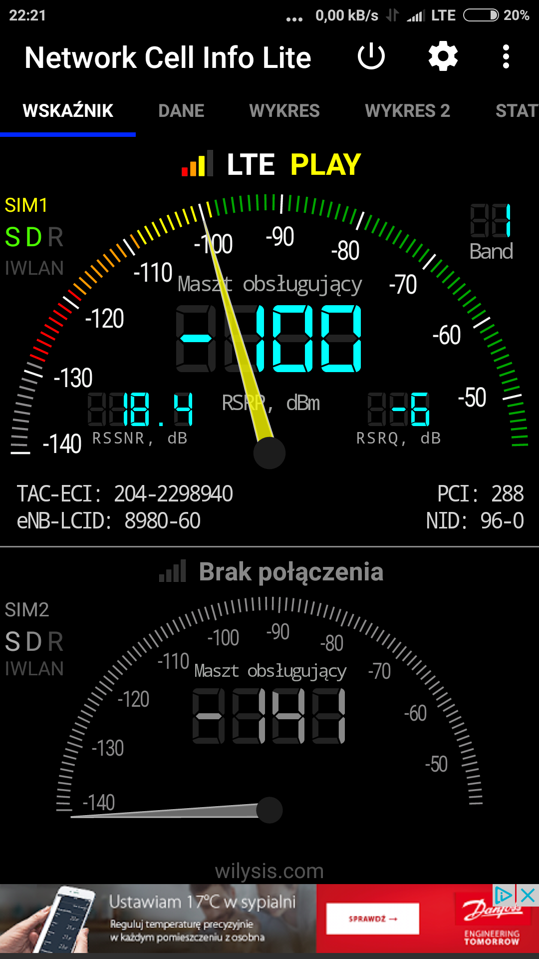

    Hello, I would like to advise you because I am green what antenna to mount on the roof for MODEM ZTE MF 823 TAKI RUSKI BELLINE. I have a Red Bull Mobbile card in play, I see that the modem connects to the LTE B20 network (800)
    at http://beta.btsearch.pl/?dataSource=locations...ards=&bands=?er=49.616841%2C20.965439&zoom=14
    I have 5.7 hp to the transmitter from grybów in a straight line and currently (I think it catches)
    modem parameters are RSSI: -86 dBm RSRP: -107 dBm SINR: 11.6 dB depends on how the modem settings parameters change max speed for speedtest currently I checked now with these parameters 11.29 Mb / s download
    ping 50 is an average of 35 and 3.51 MB / s upload. but these speeds jump terribly sometimes I have only 4Mb download. today tnz 22.10 I was next to the transmitter in RSSI mode: -40 dBm RSRP: -70 dBm SINR: 28 dB 25 Mb / s download
    pretty good and such 20 Mb / s downloads would satisfy me :) what the best antenna in my situation :) I still have a transmitter in Bobowa, 4.8 KM, but I can't connect to it terribly poor results, so I don't even try. I was thinking about this antenna but will I have satisfactory results :) http://www.dipol.com.pl/antena_atk-log_alp_lt...2x2_5m_przew_wtyk_sma_800-3000mhz_A7054_5.htm
    thanks in advance for your reply and advice :)
    ps and whether such an antenna http://allegro.pl/power-mocna-antena-dual-3g-4g-lte-50dbi-huawe-zte-i6778901761.html or such http://allegro.pl/antena- dual-4g-lte-44dbi-huawei-zte-crc9-ts9-sma-i5733646742.html would give any results because they only have LTE 1800 MHz? would my modem work at this frequency or only work at 800 mhz?

    And how do you know that this connection with LTE800 from Grybów. test on MF823 at home? Under BTS in Grybów, you probably connected in a different band. What did you do these tests on? Phone with LTE and Network Cell Info application and data tab shows ECI BTS and LTE signal parameters.

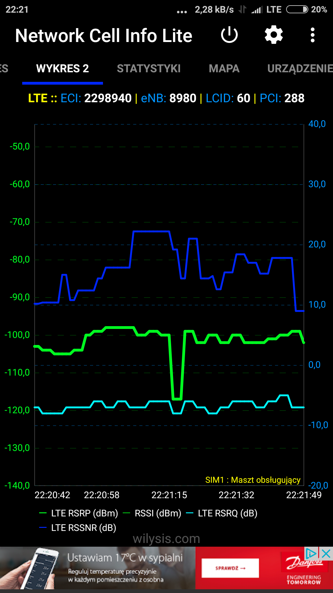

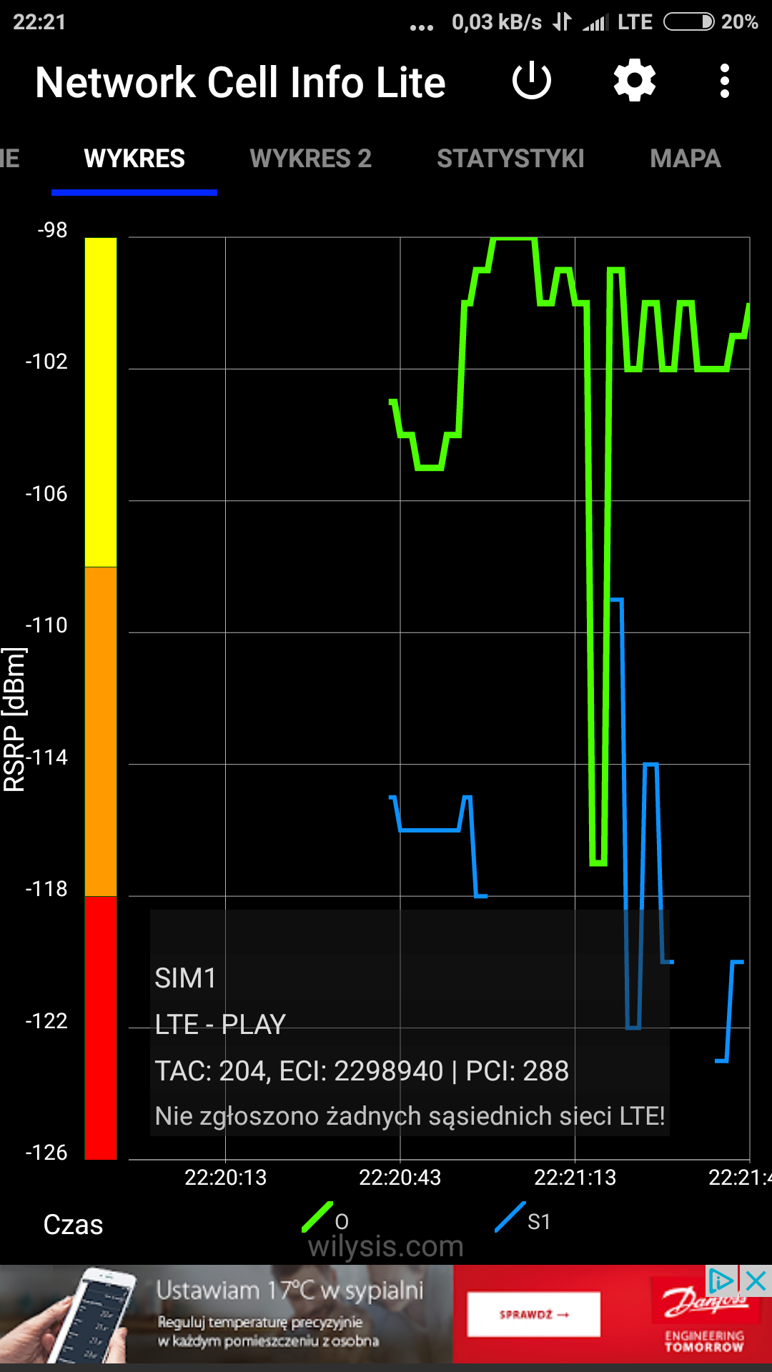

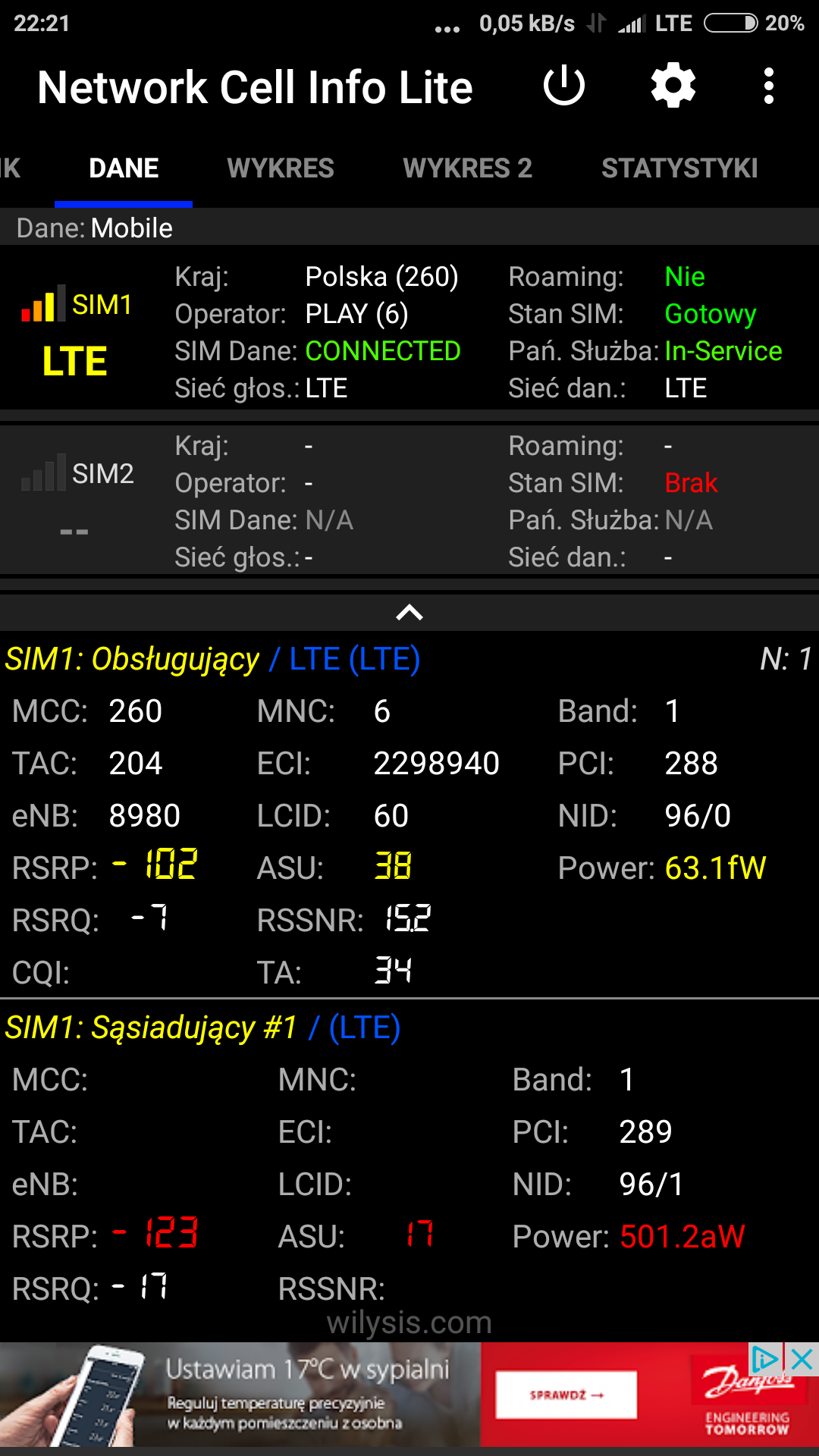

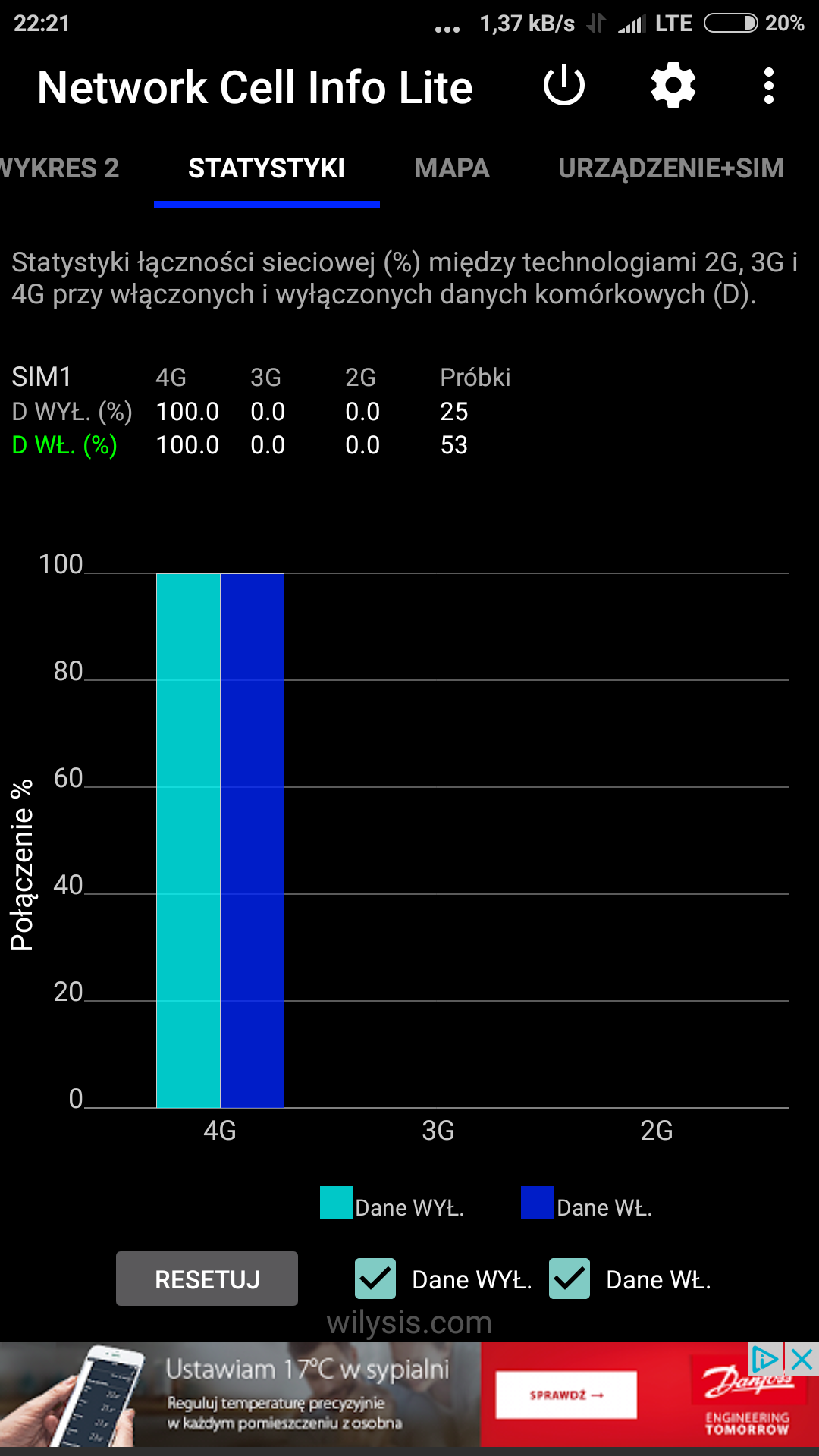

    Test at home on speedtest.pl, I have a yellow in play so it seems to me that it must connect only with play transmitters. And the best is only the graves or beans. I have a laptop modem and the homepage 192.168.0.1 I have modem settings and B20 800 writes to me at home or under the transmitter. So I deduced that it connects in the LTE 800 MHz band. So how do I check what bandwidth my modem is catching and where is the signal from? ? and which antenna would be the best?

    For me, the test at home and outside is important for you and in Grybów, Bobowa on the LTE phone with NCI and what the DATA tab will show. On LTE1800 Play it has 10MHz in MIMO2x2 and DL up to 75Mbps, on LTE800 half of it.

    Oh, I understand, I didn't know what's going on with this cell network. For now, I sent data from the house. Tomorrow I have a trip as soon as I get back on Friday I will send next photos from grybowa and bean from transmitters. I did not know that this is needed but all in all good ... Thank you for your help and thank you in advance for your future help. Although I do not understand yours despite 2x2 for 10 MHz or 1800 MHz will be better internet? Te lte with nci? I don't understand, I'm sorry ?

    On LTE800, Play has 5MHz bandwidth in MIMO2x2 technology which allows in theory for DL up to 37,% Mb / s. On LTE800 is twice as much. The range on LTE800 is greater. Real speeds depend on BTS load and signal parameters. NCI is Network Cell Info, an application for android and telephone. Shows the signal parameters and ECI, eNB BTS.

    Thank you for the answer on Friday I will try to send scriny with phone from NCI from grybowa, bean, home and near the house and I am curious myself what these charts from my phone show ?
