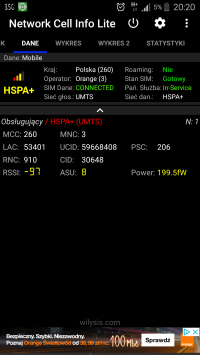

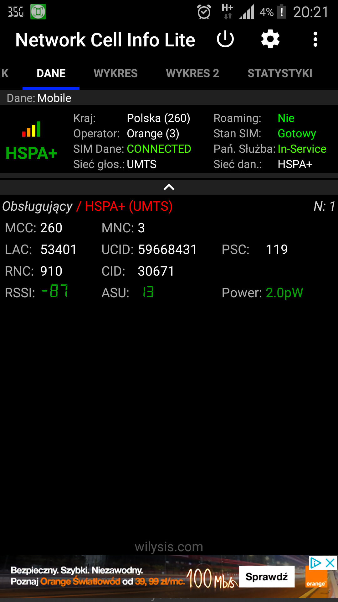

  • #5 16690910
    kamiljaw88
    Posts: 23
    At home :

    Does the phone support LTE? Connection shown with a free UMTS900 HSPA + NetWorks on BTS-Wojska Polskiego 2 or Grunwaldzka 275. Signal in the house is weak, better outside. On the latter is confirmed LTE1800NetWorks used by Orange. But this is still strange because on the chimney of Jaworzno II Orange Power Station has its own LTE800 and LTE1800NetWorks. MF286 is currently receiving FW updates that can enforce specific LTE bands. See if it's available to you. Get to know http://www.bez-kabli.pl/viewtopic.php?f=11&t=47687&start=480

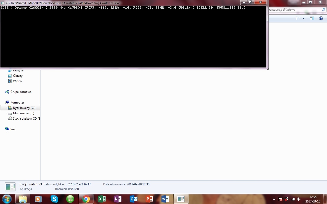

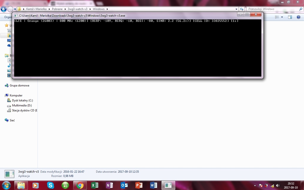

    To change to LTE only, disconnect your internet connection then the selection will be unlocked. LTE and individual LTE bands. Connection to BTS LTE1800 Networks at 275 Grunwaldzka. What speeds at these fairly weak signal parameters? Force MF283 + LTE connection and select LTE800 (Band 20) and do the same test.
  • #11 16692402
    kamiljaw88
    Posts: 23
    At LTE800
    Antenna Selection for ZTE MF283+ Router on Orange Network in Jaworzno ul.Energetyków Area
    By speedtest.net portal ping 22 ms download 11.24 Mbps upload 4.11 Mbps
    Added after 5 [minutes]:
    At LTE1800
    PING 31 ms, DOWNLOAD 7.15 Mbps, TRANSMISSION 0.96 Mbps

    Connection with BTS LTE800 Orange on the chimney of the Jaworzno III power plant. Better signal parameters and better speeds. Tests have shown that it is better to use LTE800 Orange with BTS at a power plant. You leave forced LTE800 and antenna on 800MHz. Recommended 2 pieces ATK-10 / 800-980 or 2 pieces ATK-20. two because LTE800 works in MIMO2x2, one set in vertical polarization, the other in horizontal http://www.dipol.com.pl/antena_gsm_10-element..._800-980_mhz_10_m_przewodu_wtyk_sma_A7017.htm
