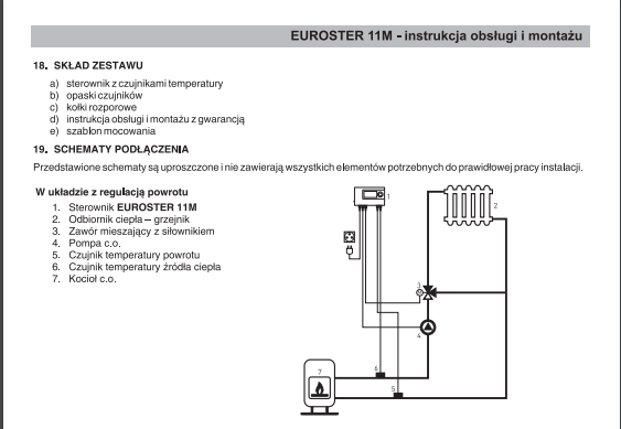

    Exiting the furnace and returning 2 ", hence my colleague gersik made me realize that for such an installation to work by gravity, I would have to have a 2" pipe before the 4d valve and it would be best without elbows or using a second pump for the boiler circuit, which would involve large expenditure on the pipe itself . Thanks to a colleague gersik I came up with the idea of protecting the return by using a 3d valve, I found an example of a return protection scheme on the Euroster website, I would like to ask you to check such a scheme. In this arrangement, I think I could use CU 28 pipes (which I had from the previous installation)

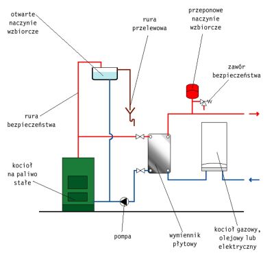

    When making two arrangements (closed and open) you do not need to mount the vessel in the attic. It can be in the boiler room. However, you must have an exchanger.
    http://3.bp.blogspot.com/-JaaTGPK1Pzc/TiLBHEz...AAAAAAAAMVY/HZ7p8OSsJYw/s1600/embed.php-5.jpg
    http://test5sdkfsdf.blogspot.com/2011/07/raz-na-wegiel-raz-na-gaz-dwa-zroda.html

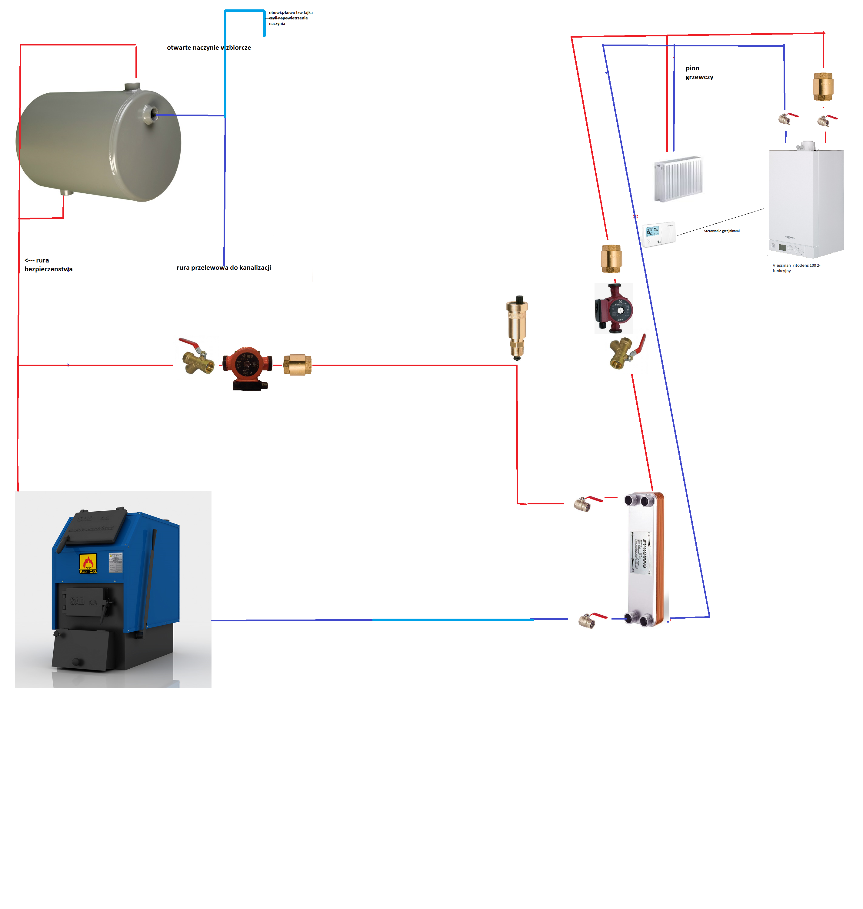

    Well, I was just reading the truth, in fact I already had 2 installers "passers-by" and as I prompted, they did not mention anything about the exchanger - ahh those professionals :not: . Returning to the subject of the scheme, as for me, a great overflow vessel I was left with, I thought it would no longer be useful. Installation in such a system would be the simplest and cheapest for me. In this case, it shows its diagram, as I wrote after leaving the furnace, pipes reduced to CU 28. In the installation there will be about 150 l counting both stoves and water in the pipes and radiators, so the overflow expansion vessel 15l is probably just right. 19kw gas furnace, coal 8-10 kw, so 20 KW heat exchanger will be good? And the assumption of burning in a coal furnace is that the shut-off valves from the gas furnace must be open, the furnace has a built-in diaphragm vessel and a safety valve. Last request to check the installation pattern

    This is how it should look like. You must agree with the contractor.
    Modernizing Boiler Room: Adding Coal Stove to Gas Furnace in Closed System
    And if you want to protect the return to the boiler it should be a little different. pump with a 3d valve on the return in an open system before the exchanger.
    You can also do it with the pumps by regulating their power.

    The contractor is me for now :) With such an exemplary scheme, it will not be difficult to make it, generally speaking I have a scheme for installations without return protection, I am asking for assessment with return protection using a 55 degree thermostatic 3d valve.
