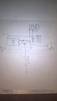

    I am asking someone who is knowledgeable in the subject to assess the correctness of the attached scheme of the CO + CWU installation
    Open installation, all-flammable boiler (mainly coal, walnut and wood) 25kW. Boiler room in the basement, heated ground floor + part of the 1st floor, a total of approx. 140m2. Everything on radiators, without a floor.
    The main part of the installation (all 'thick' lines in the diagram) is 28mm copper. From manifolds to 16mm PEX radiators.
    The expansion vessel will be open about 5-6m above the boiler.
    Basic questions:
    1. Would the installation be safe?
    2. Is something missing / too much?
    3. Are the pipe diameters in the installation appropriate?
    4. Which version will be more correct and why? In the first version, the pump and the differential valve are connected to the same four-way valve output, in the second version the differential valve is before the four-way valve, and the pump at the four-way valve output.
    I will be grateful for your help :)

    Differential valve as in version 1. Why two pumps? One on a common central heating and domestic hot water circuit without a four-way valve. No pump control after reaching the right temperature on the boiler. The tube for the dish from the highest point and can be thin. The boiler is supplied from the central heating pump before the manifold. I think the boiler is too big.

    1. Installation is secure. Only the safety pipe is to be connected from above with an empty space of the expansion vessel, and from below the vessel well. So there must be a tee on the RB and the joint must be connected from the bottom and top of the vessel.
    2. Check valves are to be behind both pumps. There is no need to bypass the pump on the radiator system because the system is made of manifolds (no gravity).
    3. If there is no boiler pump, the installation in the boiler circuit and the 4d valve must be the same size as the boiler outlet. Certainly not 28. If you want to make a circulation and a 1 "valve, there must be a pump between the return from the 4d valve and the boiler.
    4. Second version only without differential valve.

    Two pumps because if I turn the four-way valve so as to cut off the radiator circuit (summer), then the boiler circuit + DHW circuit will remain, and thanks to the pump the water will actually go through the DHW tank, and not on the shortest route on the boiler circuit itself. If I'm wrong and CWU works the same way, please correct me.
    I can't get rid of the four-way valve, I care about the right temperature to return to the boiler.
    The control of both pumps will of course be, perhaps the four-way valve itself, I have not only placed on the controller diagrams.

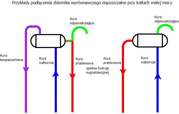

    Central heating installation - the diagram to be checked - Please check the diag .
    it's the version on the right. If this is incorrect or complete nonsense then please correct me :)
    Could you explain why? I care about understanding the topic.
    One more question - will it be warm enough there without an additional pump?

    https://www.is.pw.edu.pl/~pawel_kedzierski/ZabezpieczenieNWotwarte.pdf
    Because gravity will not work on such a small diameter of the boiler circuit, and there will be no return protection. This topic is rolled out all the time, just look.
    http://sas.busko.pl/pl/images/stories/sas/pro...rty_zamkniety/uklad_otwarty/ukl_otwarty_1.jpg
    This is how the vessel should be connected.
