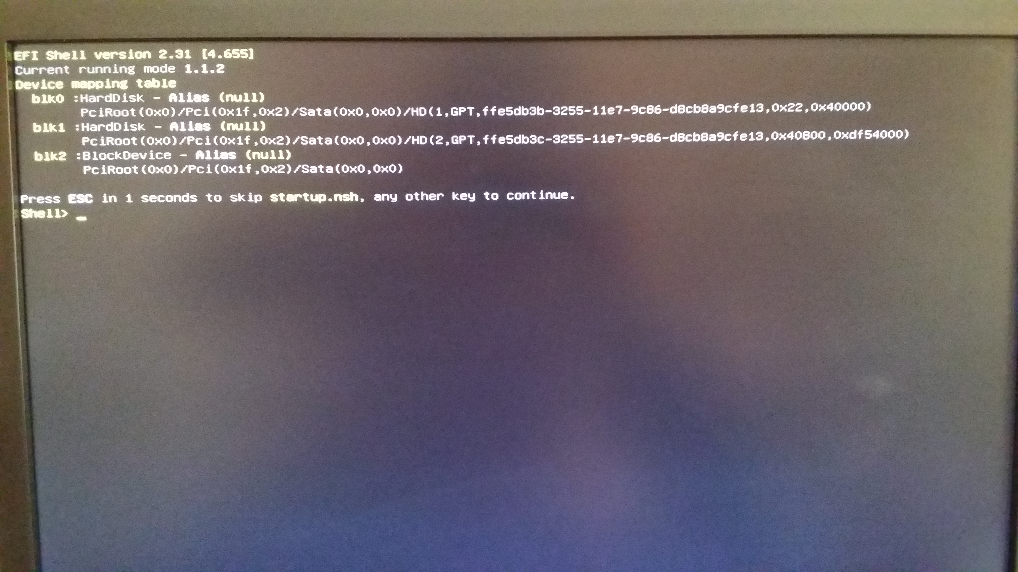

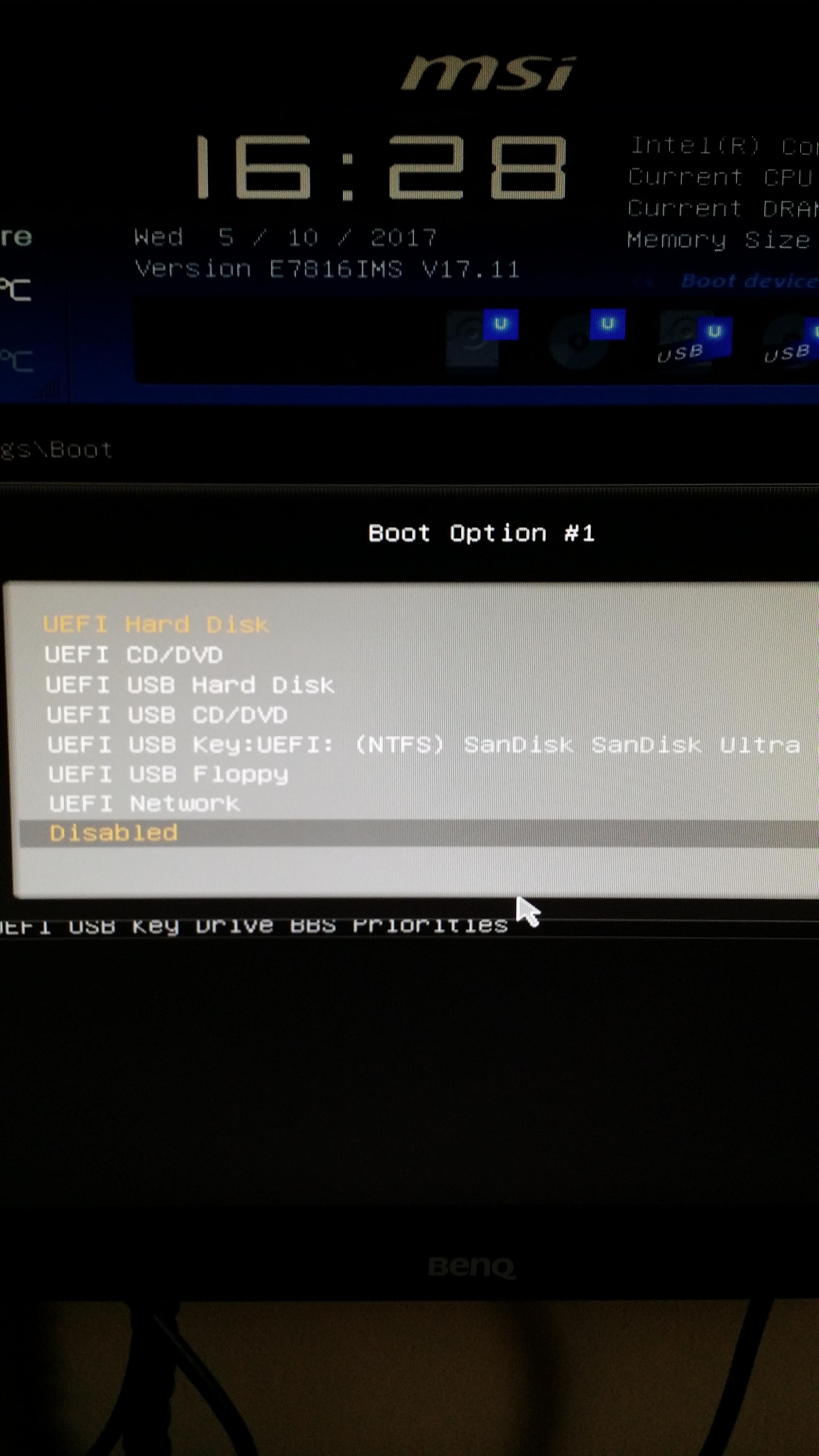

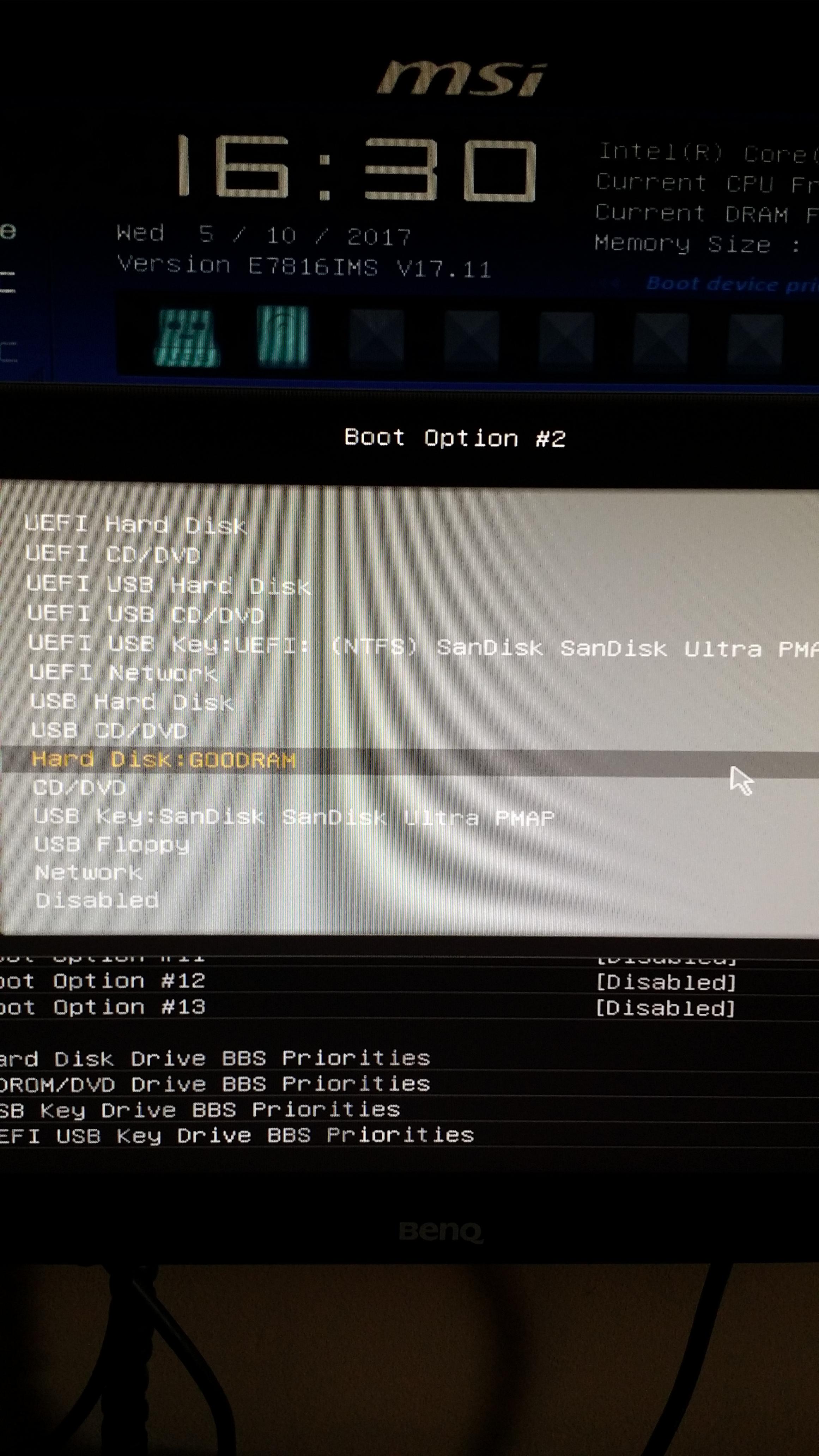

  • #7 16467906
    lukasz151111
    Posts: 37
    When you turn on only UEFI you can see it like in the first picture. How do I enable Legacy + UEFI then I see the SSD drive.

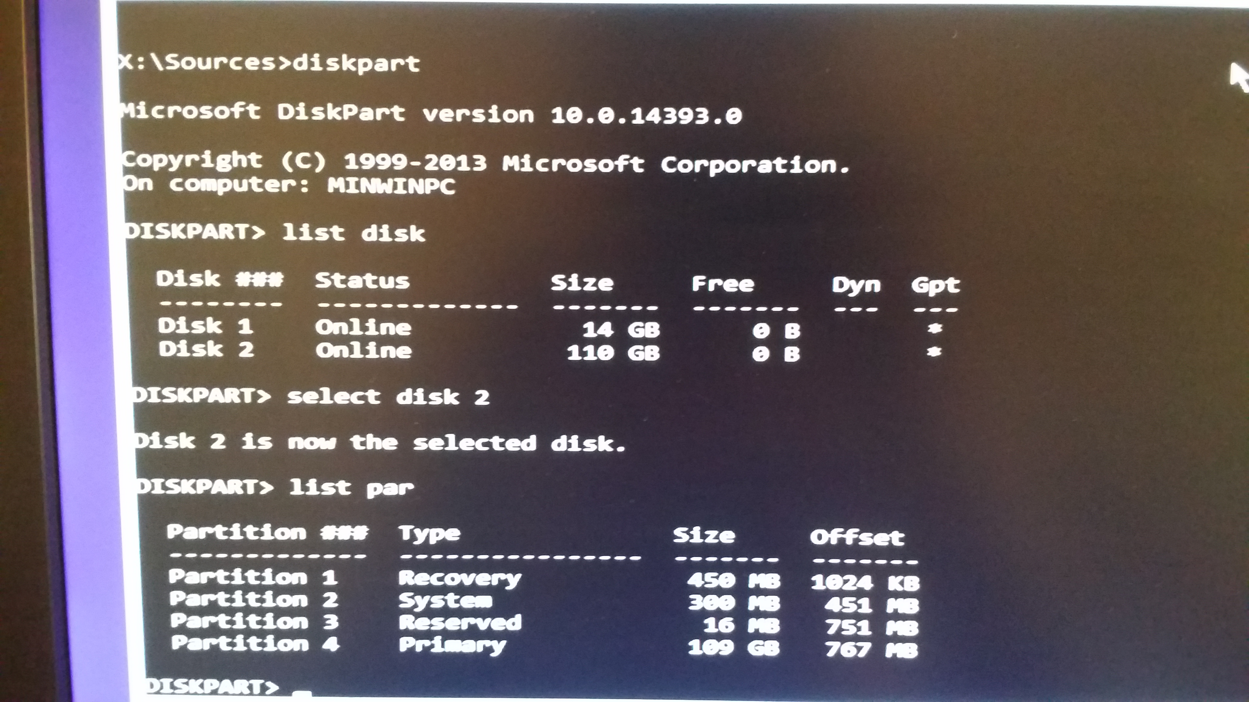

    Run the installer after installation, press shift + f10, enter diskpart, list disk, select disk X (in place of x ie last SSD number), pairs list Paste the picture from what will be displayed.
  • #11 16469923
    lukasz151111
    Posts: 37
    According to the instructions done (I mean only the disk in the diskpart ssd was visible only when I came to choose the partition in the installer). I paste the photo. I will add that when the SSD starts, a new error arises.
