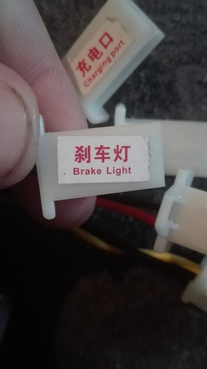

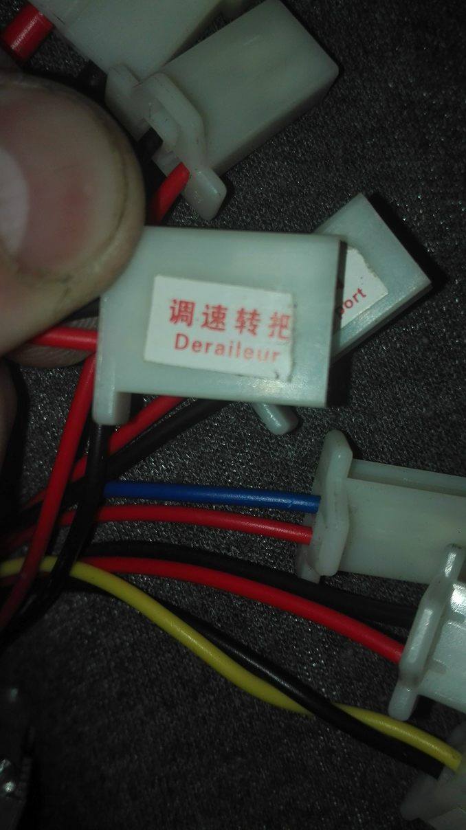

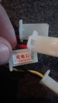

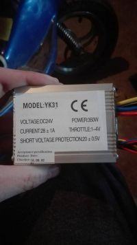

  • #7 16468151
    dawid1502
    Rate: 11
    24V 350W Electric Scooter Engine Unresponsive: Replaced Handle, Batteries & Driver - What's Next? 24V 350W Electric Scooter Engine Unresponsive: Replaced Handle, Batteries & Driver - What's Next? 24V 350W Electric Scooter Engine Unresponsive: Replaced Handle, Batteries & Driver - What's Next? 24V 350W Electric Scooter Engine Unresponsive: Replaced Handle, Batteries & Driver - What's Next? 24V 350W Electric Scooter Engine Unresponsive: Replaced Handle, Batteries & Driver - What's Next? 24V 350W Electric Scooter Engine Unresponsive: Replaced Handle, Batteries & Driver - What's Next? 24V 350W Electric Scooter Engine Unresponsive: Replaced Handle, Batteries & Driver - What's Next? 24V 350W Electric Scooter Engine Unresponsive: Replaced Handle, Batteries & Driver - What's Next?
    two large cubes (one from the battery the other from the engine)
    smaller wider (deraileur) -smaker
    five of the same that can be sought after subtitles
