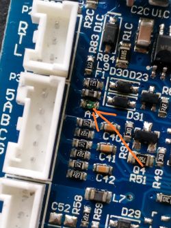

  • #22 20198905
    jarroQ
    Posts: 2092
    Help: 170
    Rate: 629
    To check that the 5V line is not sticking anywhere. If not, check the polymer fuse in DRV - F2.
  • #23 20201087
    Pontikos
    Posts: 4554
    Help: 321
    Rate: 1007
    Buddy, the symptom is quite characteristic - remove the controller, remove the transparent cover, in the lower left corner of the plate, find the green element labeled F2.
    It would have to be replaced (it loses its properties over time), but if you solder a 0.1mm wire jumper there, it will also work and will probably not damage anything ;-)
  • #24 20201099
    kangyooni
    Level 21  
    Posts: 515
    Help: 14
    Rate: 100
    Thanks a lot! I will try only in two weeks, let me know if it helped.
  • F2 fuse replacement with 0.1 mm wire jumper
    #25 20203663
    keseszel
    Level 26  
    Posts: 4105
    Help: 54
    Rate: 558
    On what do you base your observation that F2 loses its properties over time? I am asking out of curiosity, because I have similar symptoms, this fuse is hmm .. rather difficult to get. And I am surprised by the proposals to replace it with a wire. I would rather suspect that when too much current flows, this fuse "creates resistance". After the current drops, it has little resistance again. Thanks to this, you do not have to constantly dismantle the platform.
  • Polymer fuse loses current rating over time
    #26 20203813
    jarroQ
    Posts: 2092
    Help: 170
    Rate: 629
    It is very good that you paid attention to this. I put in an ordinary 500mA smd fuse.
    In fact, the original polymer fuse loses its properties. Its maximum forward current drops.
    Unfortunately, this phenomenon occurs in many devices equipped with such fuses. I used to repair the autoboss v30 diagnostic tool. Same situation.
  • Blown F2 fuse bypass restores scooter power

    #29 20235498
    keseszel
    Level 26  
    Posts: 4105
    Help: 54
    Rate: 558
    kangyooni wrote:
    Thanks, it helped right away. I soldered a jumper made of a thin wire.
    Unfortunately, the kick is still no longer there, but it is already 4 years old and has traveled 1500km. However, it works evenly and is suitable for jumping to the store. Thanks!
    Should I also have to be interested in him? This F2 .. Mine also has similar symptoms, I was also tired of them here. I ended up driving with an extra lamp.
    The Xiaomi m365 electric scooter is driving, but it has no power. The Xiaomi m365 electric scooter is driving, but it has no power.
    The speed I got on the scooter. And here zonk .. The speed was after ... the jump when the wheel broke off the ground.
    Holding the front wheel up for a few minutes, the counter showed the distance traveled a few hundred meters more. And another curiosity - the maximum speed that he later indicated was about 27 km / h. When the scooter was standing and the wheel was raised.
  • Blown F2 fuse causing unstable hall sensor voltage

    jarroQ
    Posts: 2092
    Help: 170
    Rate: 629
    Replace the fuse F2 and after the problem. After inserting the jumper at the smallest overload of the 5V converter, it becomes dead.
    As for the engine speed, it is unstable if the engine is not loaded (only at higher engine revolutions).
    The PID controller is often unable to maintain the set speed and in the application you may see the wrong or unstable speed.
    If you have damaged F2, it also affects the voltage of the hall sensors in the engine. If it is unstable or much lower than recommended, the max speed will be lower.
