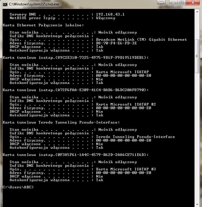

    Here's the screen with ipconfig

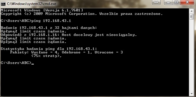

    Enter router addresses?
    ping the gateway 192.168.43.1 and upload the results

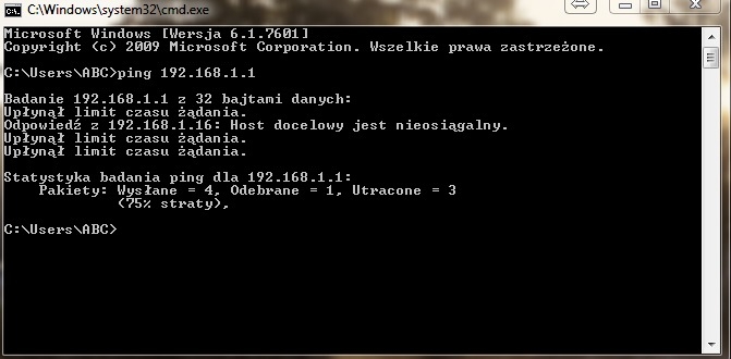

    The main router has 192.168.1.1 set also has an address reservation so 2 router has only 192.168.1.5 or even 15
    PING 192.168.43.1
    - 3x request timeout has passed
    - 1x "Response from 192.168.1.16: Target host is not reachable"
    Screen would be longer to throw

    what's the screen ip config in the first post? when you're connected to wi-fi or sharing with tel?
    Connect to your wi-fi network and do ipconfig and ping 192.168.1.1

    The screen address is 192.168.43.1 and your router is 192.168.1.1
    And that's completely wrong. Over-reset the routers and laptop, the address must be from the 192.168.1.1 pool

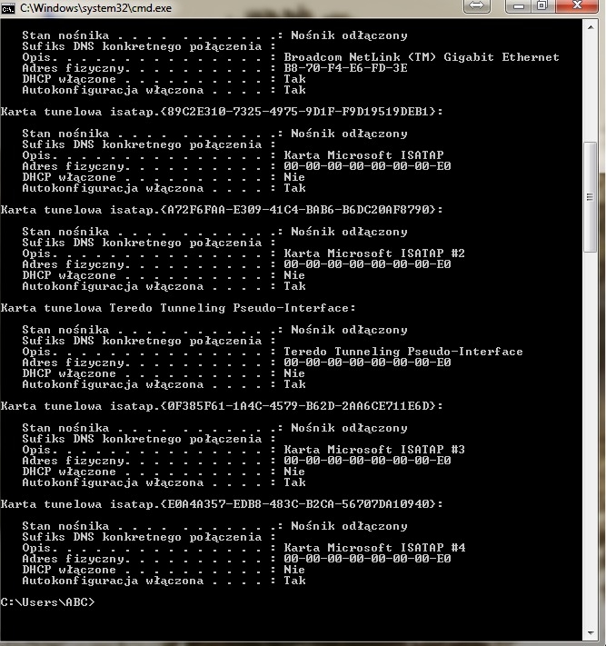

    I do not know why probably through my rush but apparently 1 screenshots from ipconfig all are from the phone; /
    Here, after resetting everything and waiting for the correct connection to the router, I made a new iponfig all and everything that could be improved

    For interesting information I noticed switching on a laptop between networks that there is a moment when WIFI from Router works properly and even for 2 seconds I had a stationary net, but that was a single freak for now

    The last screen is the most important and is good, you should have internet.
    It works?
