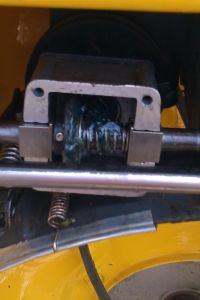

    You could have repaired the NAC W510 VHY mower drive --- my teeth have formed in the transmission - I put in a repair kit and nothing turns on the spring drive of the cable and the transmission gear put on correctly, a new wedge belt was put on. Maybe the rope is stretched because the adjustment on the cord does not give anything.
    Is the distance between the disc wheel and the attacking roller too long, even at maximum pressure the teeth do not engage?
    NAC W510 VHY - The mower drive does not work
    How do you have such a transmission give a photo or diagram how to properly assemble the whole because it looks like something is missing here?

    This transmission has no internal clutch. The gear teeth (the attacking roller and the disk wheel) are fixed. The clutch's role is played by the angle of inclination of the gear relative to the mower housing. When the engine is running without the drive engaged (the drive lever on the mower handle is not pressed), the gearbox is slightly inclined towards the mower housing and does not tighten the V-belt. When the drive lever is pressed, the cable pulls the transmission from the mower housing. This results in tensioning the V-belt and transferring the drive from the engine to the transmission and further to the wheels.
    An important element of this clutch system is the state of so-called "half-cylinders" on the inside of the plastic belt cover. In the case of excessive rubbing of these half-carriers, the belt may not be loosened in the right way, which may lead to faster wear and also to destruction (overheating) of the transmission's plastic pulley.

    I give the order of the elements in the transmission (from the left side as in the photo you place):
    1 / sleeve with flange;
    2 / round washer: internal diameter = the diameter of the axle, outer diameter = the diameter of the disc wheel hub, i.e. the part of the wheel through which the disc wheel is attached to the axle by means of an expansion pin;
    3 / disc wheel;
    4 / needle bearing thrust bearing;
    5 / outer raceway of the thrust bearing;
    6 / spring;
    7 / sleeve with flange.
    The pos.2 pad in my opinion regulates the distance between the teeth of the disk wheel and the shaft. Its thickness does not exceed 1 mm. The attack roller is mounted permanently - its position in the housing and at the same time in relation to the disk wheel are determined by the segera rings (external on the shaft and internal in the gear housing.

    Therefore, the pad (in your No. 3) has to be translated to the left side of the wheel.
    In the newest picture, you showed the surface of the disk wheel, to which the thrust bearing (wreath with needles) adheres. This wreath should have its "shield" on the spring side. The spring can not directly touch the needle pins. This "cover" is just the outer race of the bearing. Has an outside diameter comparable to the diameter of the bearing. It looks more or less like this ] Link .

    Generally, it's getting better. As for the question about point 4, I will answer indirectly. The surface on which the bearing needles move must be flat. Otherwise, the needles would be damaged.
    The washer No. 2 has, according to me, a large diameter. It may interfere with the installation of the lower gear cover. Essentially, this washer should have an outside diameter such as the diameter of the adjacent element - where the dowel is stuck.
    The pin should not protrude - it should have a length equal to the diameter of the circle in which it is stuck. If you can not drive it to the end, you have to remove it, hold the axis and turn the wheel 180 degrees and try to drive it in this position.
    It seems that the axis with the wheel is lowered. These flanged bushes should form a uniform surface with the housing. Match them lightly and check the meshing. You can also screw the bottom cover.
    An additional pad on the left may be necessary.
    I understand that the attack roller is mounted correctly - for a peace of mind, it can be easily tapped on the side of the plastic V-belt.

    Kosiara is walking :) two washers, smaller diameter I inserted, I also exchanged sleeves with a collar - in addition I made a pear-shaped washer under the gear cover because the original was too thin and the toothed wheel rubbed from the inside now has not shortened yet the link to the transmission gears because too much stretched but it's no longer a problem a stronger spring I used inside the transmission itself and I replaced the bearing at the attacking shaft because it had a slight beating. The gearbox, generally wrongly assembled by the mower of the lawnmower, was replaced in the opposite direction, the lack of washers contributed to the wear of the sprocket and the attacker's shaft. I think about the subject as closed :) :) if you have any questions, I will answer :)
