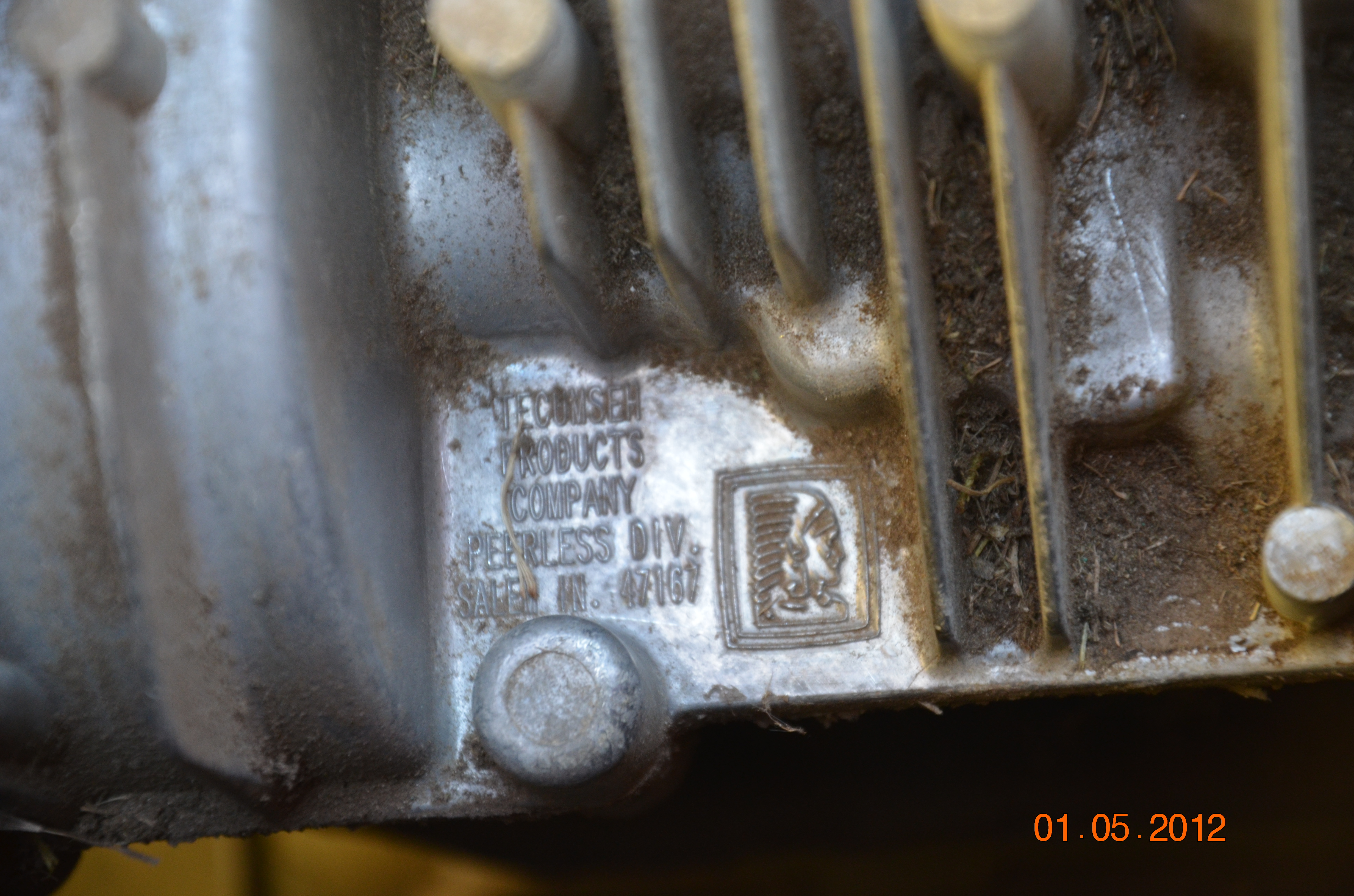

    I found such an inscription engraved on the case: Tecumsech Products Peerless DIV Salem in 47167. And one more thing I fired up the mower today and checked how it drives and interestingly enough the backward drive even went up a fairly steep hill, now I recall that the problems with the reverse drive are exacerbated after prolonged operation (something with the oil?) I looked all around the box and it seems to be dry everywhere.
    I also took some pictures but this is the first time I'm posting on the forum so I don't know what will come out.

    I accidentally found your problem, the answer is lack of cooling of the box. You have damaged fan blades (the one above the transmission shaft pulley).
    After 15 minutes I suspect that it loses power and there is nothing to move, reverse will hardly work for lack of power (after reverse you feel the lack of power the most, you may have a problem even with a slight bump) . The oil in the box loses its density by which and efficiency. Use a leaf blower (strong) and all the blower directed at the hydrostatic transmission - remove the flap over the transmission and aim the air there ), you will see that the tractor will work like new all the time as long as there is good cooling - if you turned on the blower on the unheated transmission.
    Another problem and a similar diagnosis is the "harmonica" in the box responsible for allocating space in the box for heated oil (as is known then increases its volume), often breaks through which a hole (on the left - sitting - side side visible after removing the side flap) flows out. It is possible to unscrew the plate, clean and glue the diaphragm, but this is a way for the short term.
    This problem manifests itself similarly but you can also smell the oil.
    If you have been driving without oil then it probably lost irretrievably (unless you fix it yourself) a couple of nice percent of performance.
    If you find a leak or oil under the box then replace it, it is not difficult but laborious and tedious to do it yourself.
    If I found the cause then write, write an answer, in this model it is worth installing an expansion tank.
    Hope this post will also help others.

    Under the pulley should be a fan, check that the blades are whole.
    In this box it is difficult to check the oil level because there is no expansion tank. The easiest way is to change the oil, as I remember correctly according to the instructions is 5w50, I myself have such poured.
    To change:
    Under the box (you have to remove the scythe) you have a rubber plug, when you pull it will spill oil.
    On the right side in the box you have a screwed plate with a hole unscrew it (you need an asterisk with a hole in the middle)
    When you remove the plate a diaphragm will appear (harmonics as I wrote earlier)
    Remove it clean (outside and inside) carefully check that it is tight.
    Now you will need someone to help, unless you can do it yourself ;)
    Tilt the tractor so that the opening is as horizontal as possible (be careful because fuel may flow out of the tank)
    When you manage to set the tractor so that the opening is as horizontal as possible, pour in oil so 3/4 (you can turn the pulley), insert the diaphragm (it may spill a little).
    Tighten everything up, wipe it down and do a test drive.
