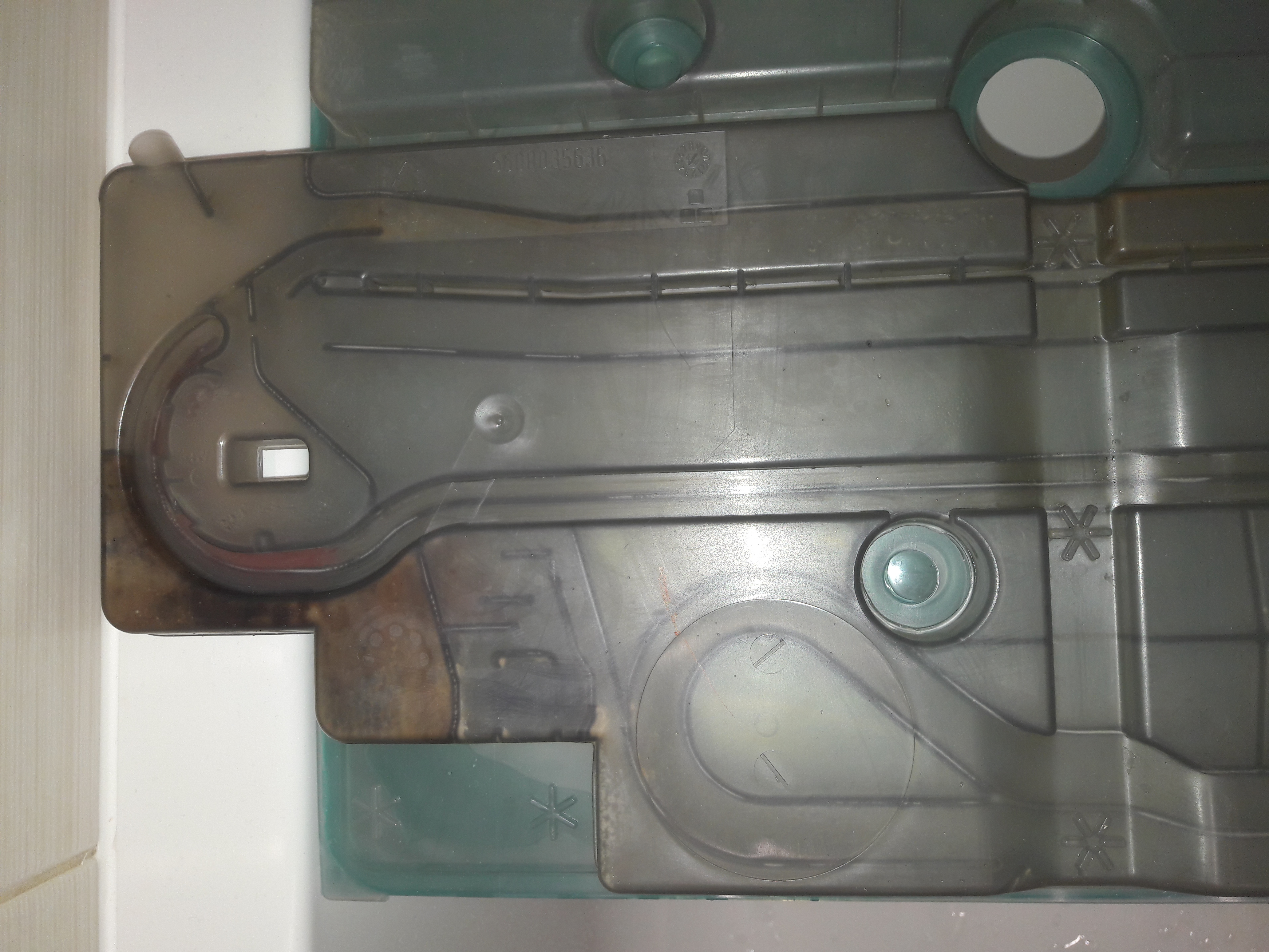

    Hello, I have a question about how to clean the water jacket in the dishwasher. A few days ago stopped working while washing up just stopped. From the forum I learned that the hydrostat, solenoid valve and water jacket must be cleaned. I did it outside the water jacket. The dishwasher has done 1 cycle and again the problem does not end washing display shows 1 min to the end but does not end as I added water to the dishwasher manually it showed 33 min display and finished washing, dishes clean dry and hot. I will add that the dishwasher is not liquid anything has no traces of even something before it was to some water evaporated. The problem is probably that it does not get water because it is a dirty, stony water jacket. A new PLN 549, so I would rather purge but what to do to not damage it. People on the forum wrote that citric acid, but the first trials of the acid did not help, there is no way to get there. As I turn on the program, it takes up little water and nozzles to pee with water, and as it adds up, the pressure is very strong in the dishwasher's compartment. So what agent can be poured into the coat to clean it and not destroy it because I assume that this is the reason for not taking water. If someone did it, let them share knowledge, maybe I will save on buying a new coat which at the moment costs as much as 40% of the new dishwasher.
    And this is how the hydrostat looked after and after cleaning on the attached photos. I do not have a photo of the coat because I sprained the dishwasher, it will be dismantled under the counter on Monday and I will start to fight with stone and dirt.

    The hose from the hydrostat to the bowl cleaned?
    The water jacket is not really (I personally did not have such a case in this type of dishwasher).

    It depends on the size of the hand. I take out and put on this hose without unscrewing the dishwasher (only disassembled coat + hydrostat). The hose is pressed (it has gaskets at the ends). Before assembly, lightly brush the washing liquid.
    As in this condition was a hydrostat, it was probably a snake covered with shit.

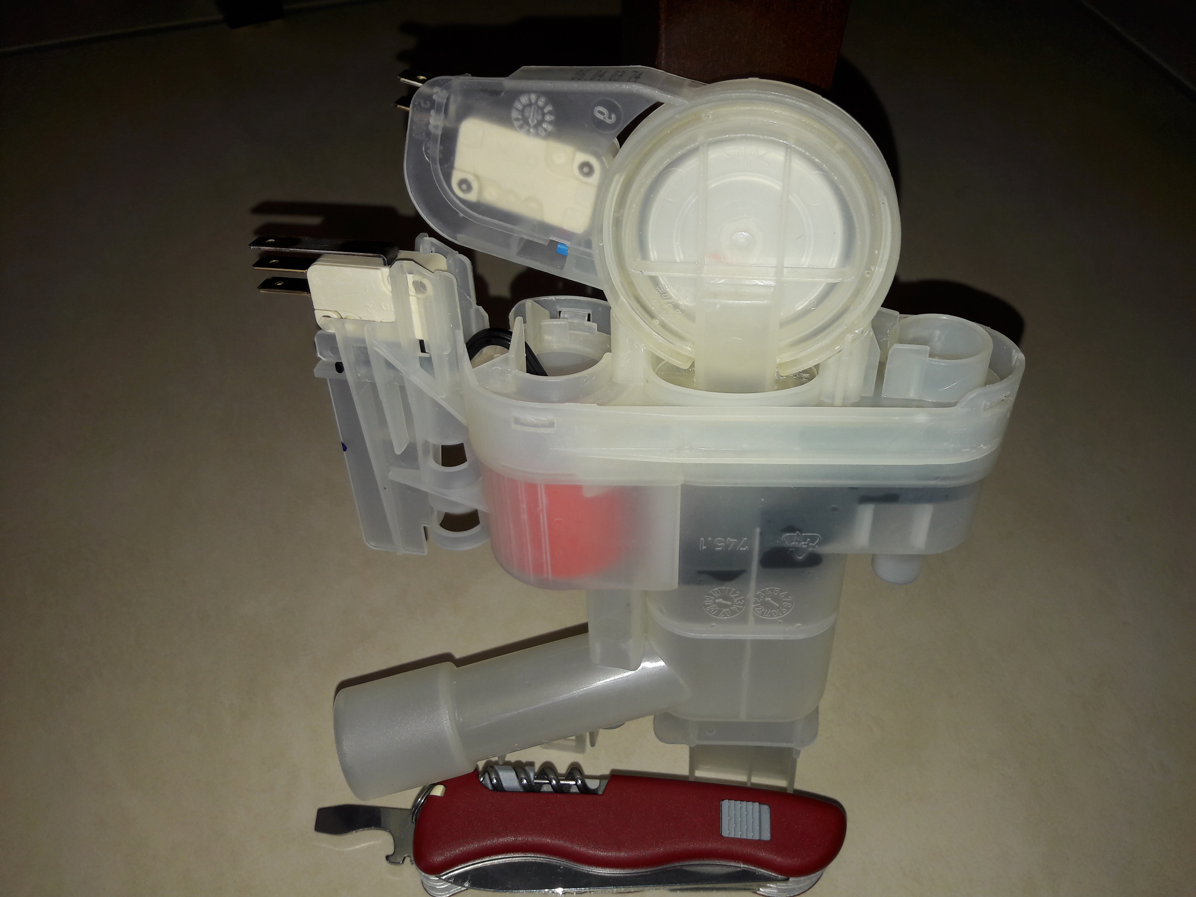

    Take a look at the picture with a yellow selection, what is this element blue and red for what it suits because I noticed that earlier this red button has dropped and now it stutters and is in the upper position or can it be responsible for not getting water?
    Of course - to replace the micro-switch.

    Thanks but I moved the switch upside down and probably everything ok the water began to download I have not done the washing cycle yet and another problem arose. When closing the door, the latch broke like in the picture. Now the display does not light I see that such a latch can also be bought in this linked shop. But look, maybe you know how to replace it or do you have to crank it up again? There are no screws with the latch, or is it forcefully stuffed out?

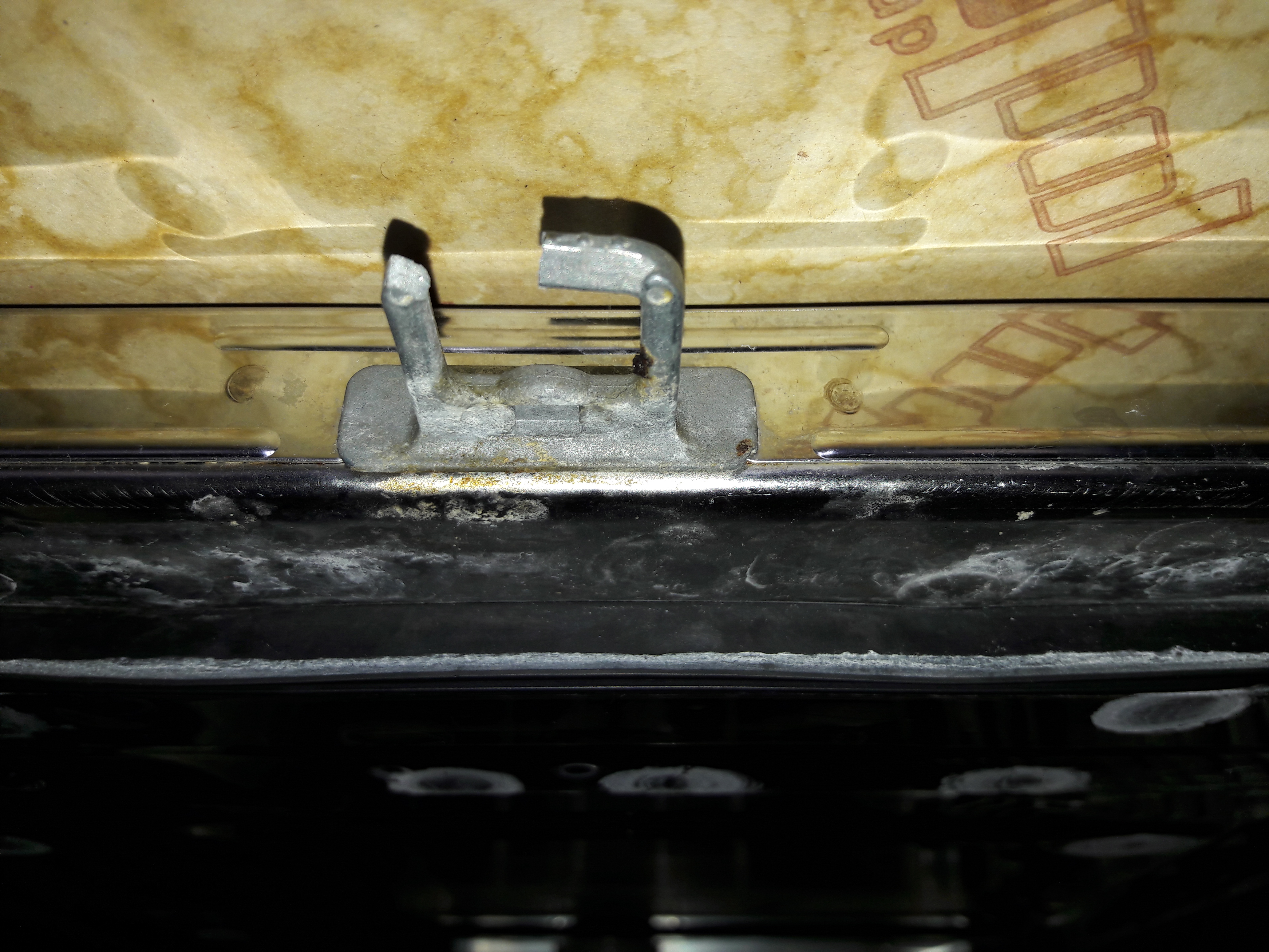

    The hook I bought was supposed to be tomorrow maybe the day after tomorrow. Maybe someone, if possible decently explain how to open the lock I wrote in Google, but I did not find much.
    And the hook I bought this has to fit into the dishwasher only how to mount it?

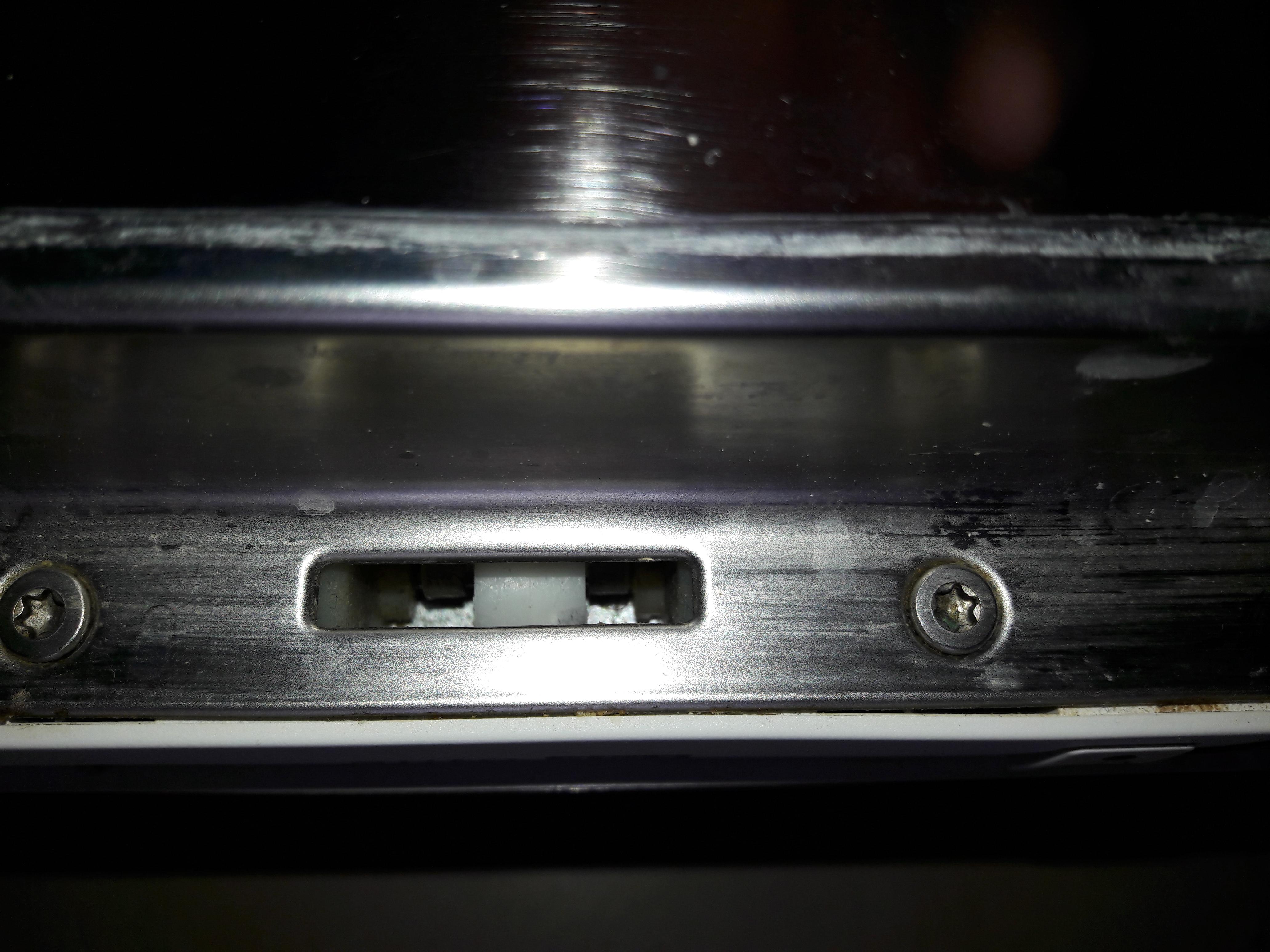

    What to the lock:
    After unscrewing the mask you have the following:
    Bosch SRV45T13EU / 41 - How to clean the water jacket The dishwasher does not dr
    To remove the zipper, you have to bend down and down:
    View of the open lock:
    Bosch SRV45T13EU / 41 - How to clean the water jacket The dishwasher does not dr Bosch SRV45T13EU / 41 - How to clean the water jacket The dishwasher does not dr Bosch SRV45T13EU / 41 - How to clean the water jacket The dishwasher does not dr Bosch SRV45T13EU / 41 - How to clean the water jacket The dishwasher does not dr
    View of the closed lock:
    On the penultimate drawing, the white element is pressed gently and with a small screwdriver we help to jump over the open positions.
    I do not know how to replace the hook itself. The others I know, I never mentioned that.

    Thanks for the pictures of the lock, how I got it started, it turned out that it is in a closed position, the pictures with the description when open and when the lock is closed helped a lot. I assembled and everything is ok because the display is lit and does not turn on when the door is open. Has a problem with the hook know someone how to mount it? I would like to thank everyone for the advice so far.

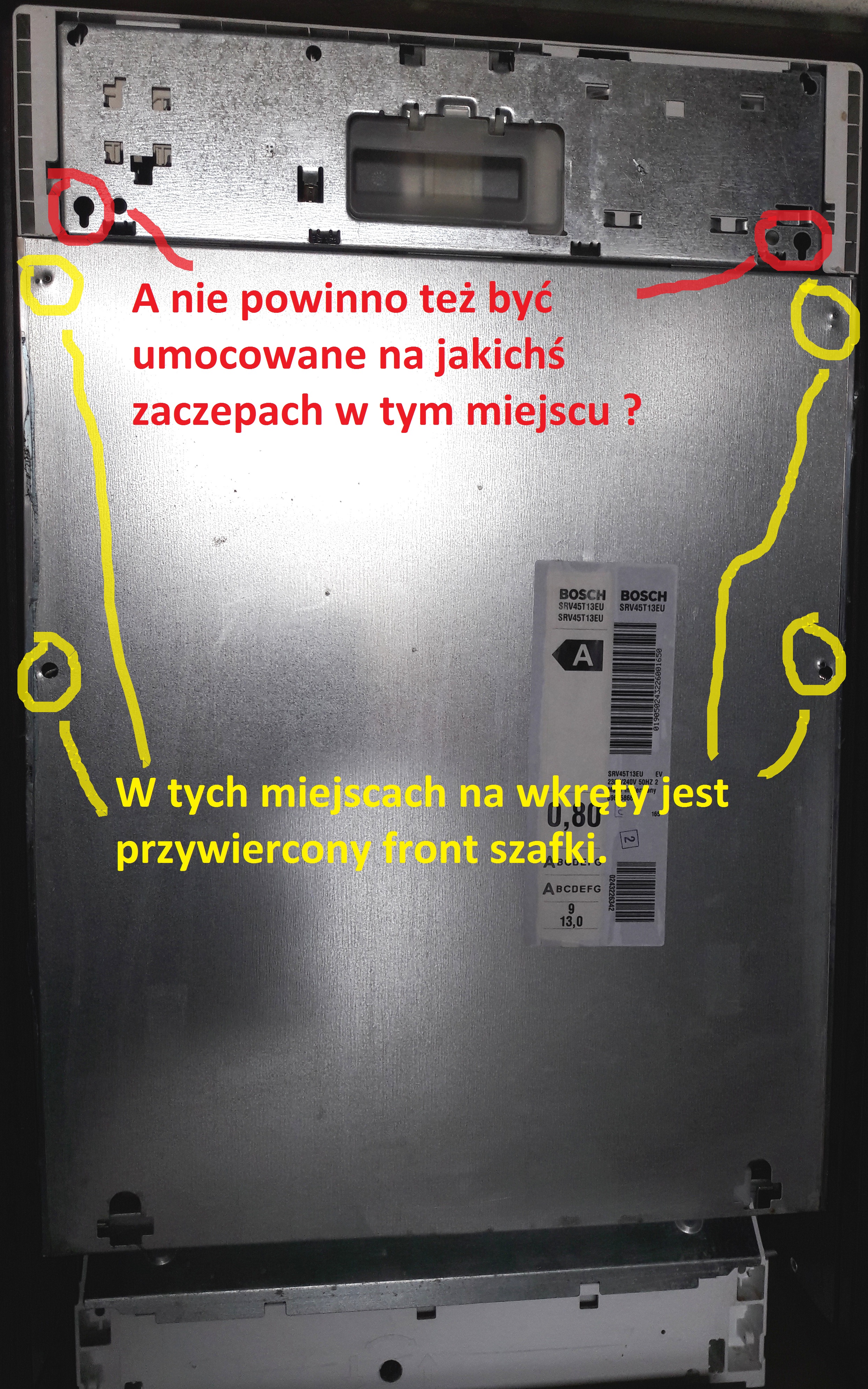

    When mounting the front I noticed that the furniture front is screwed to the dishwasher for 4 screws as you can see in the picture in yellow, and should not be on those hooks what I marked with red? The point is that the plate is already drilled in these places and I do not know if it will stay screwed up again and after that it will be hard to find the same place in the same places. How can this be solved, if these points are actually marked in red with the option of fixing the plate to the face of the dishwasher, how to mark them to make it even out? I mounted the door as it was so out of date, but there will still be a problem with disassembly and assembly of the new hook, I add a photo of a hook, maybe someone did it and if it looks, it will remind him how to dismantle it? I tried to undermine from the front but another piece broke down probably does not come out forcefully and no screws are missing. They did not have any instructional videos in the north.pl store, but they said if there is a part, it can be replaced and they contacted the service.

    And now I can say 99% of what was the cause of getting a small amount of water or not at all. In the picture, as you can see, this red spit after being pressed did not return to the starting position and it was blocked and it caused lack of water. I turned on a few washes and, while screwing it with a screwdriver, I pressed it to interrupt the water intake. So if someone has a similar problem, after purging everything that is possible, let them pay attention to this element.
