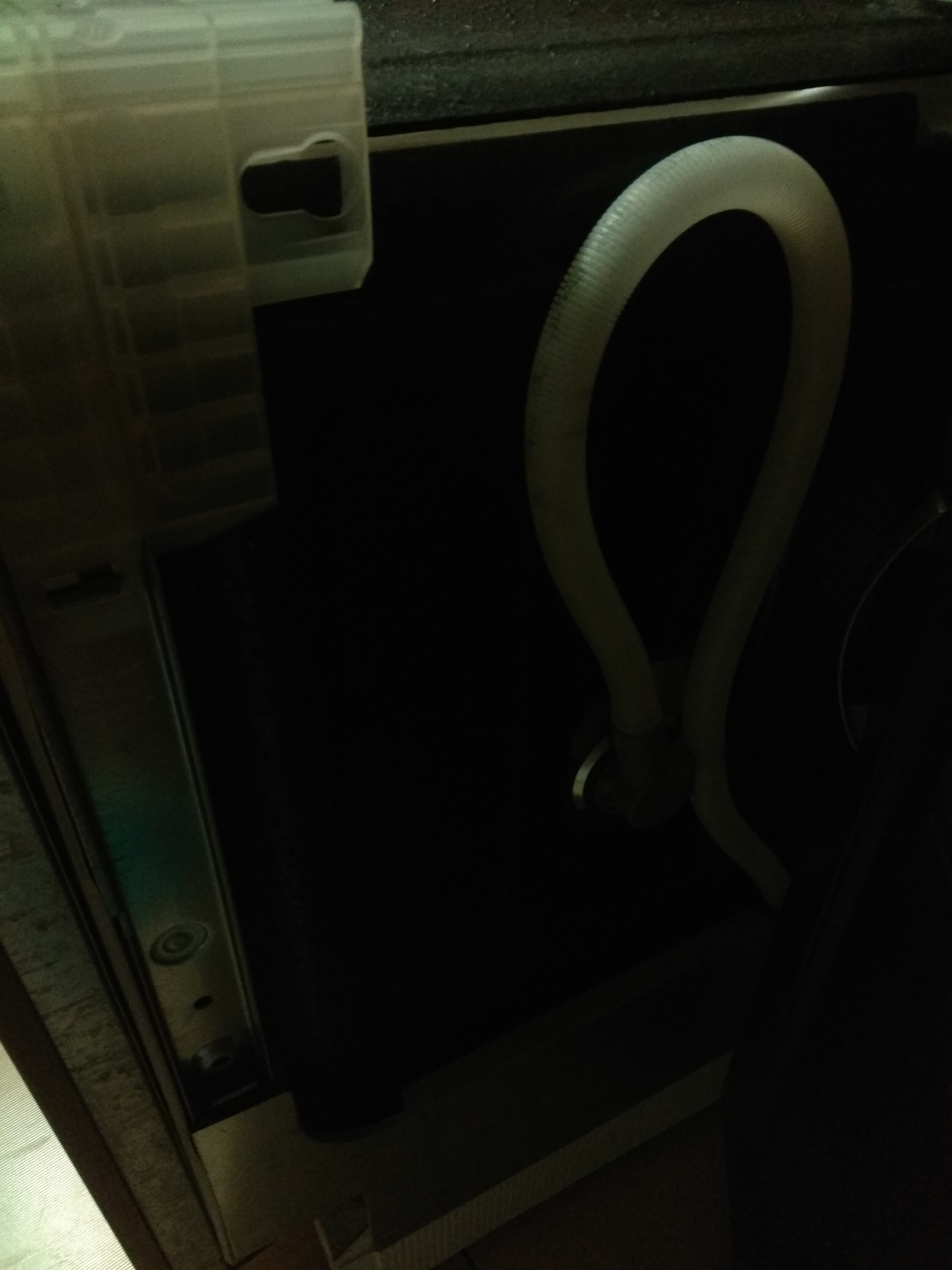

    However, I noticed that after starting the program water does not run through the pipe, which is on the right side of the dishwasher (photo). From what I can see it feeds water to the sprinkler on the right wall of the washing chamber. I did not follow the entire program, but stopped it after about 15 minutes when it was still pouring cold water, so maybe it is only later that the water is delivered through this pipe? How is this with it?

    This is a pipe to nowhere, venting the washing chamber. The distribution and emptying of water in this construction is carried out only through the water jacket and its arrangement.

    Ok, everything is clear :) I thought water was going to flow that way :) Thanks for the help!
    Dishwasher cleaned. Works as before.
