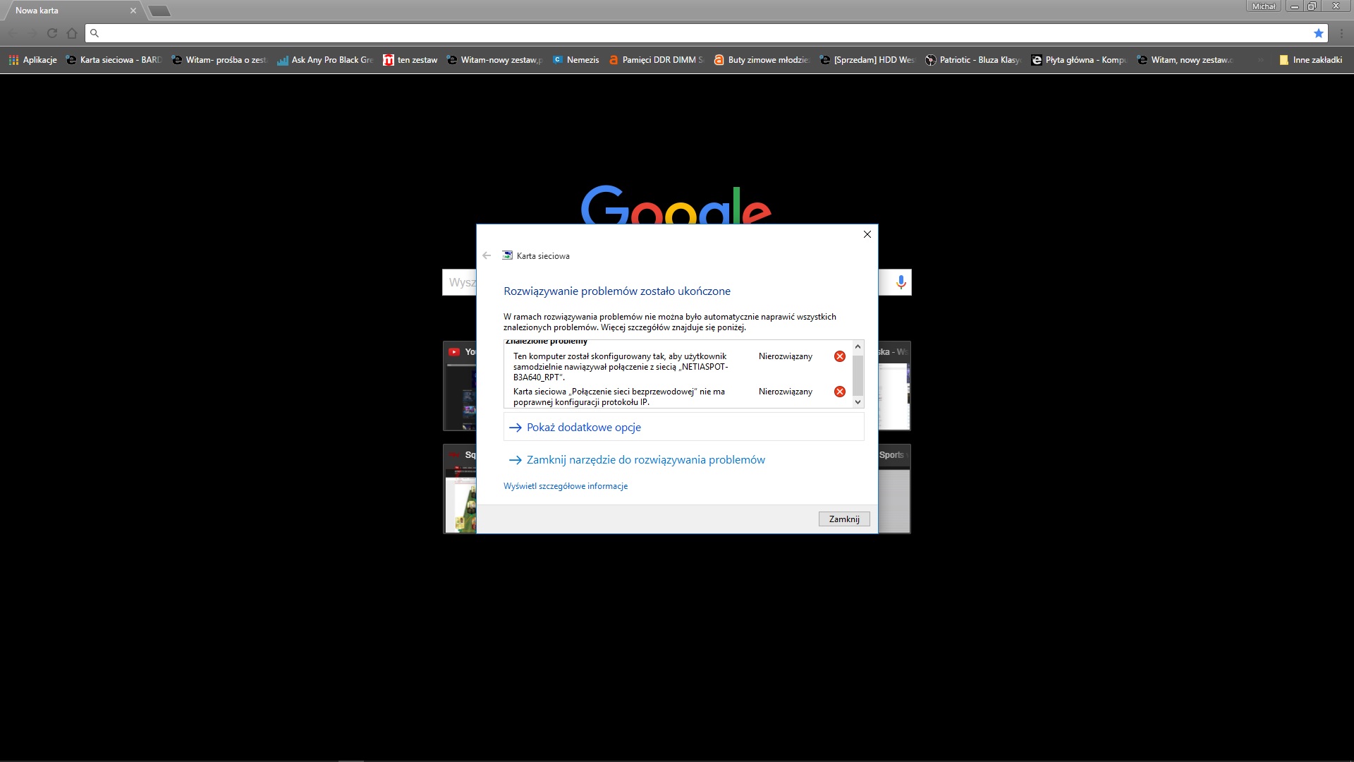

    Good morning,
    Maybe first I will present my configuration, i.e.
    Intel Core I5-4460
    MSI Z97SLI Krait Edition
    Nvidia Geforce GTX 750Ti
    Crucial 2x4GB DDR3
    Seagate 1TB
    Win 10Pro x64
    And yes, I use TP-LINK WN721N to connect to my home network (router netia spot).

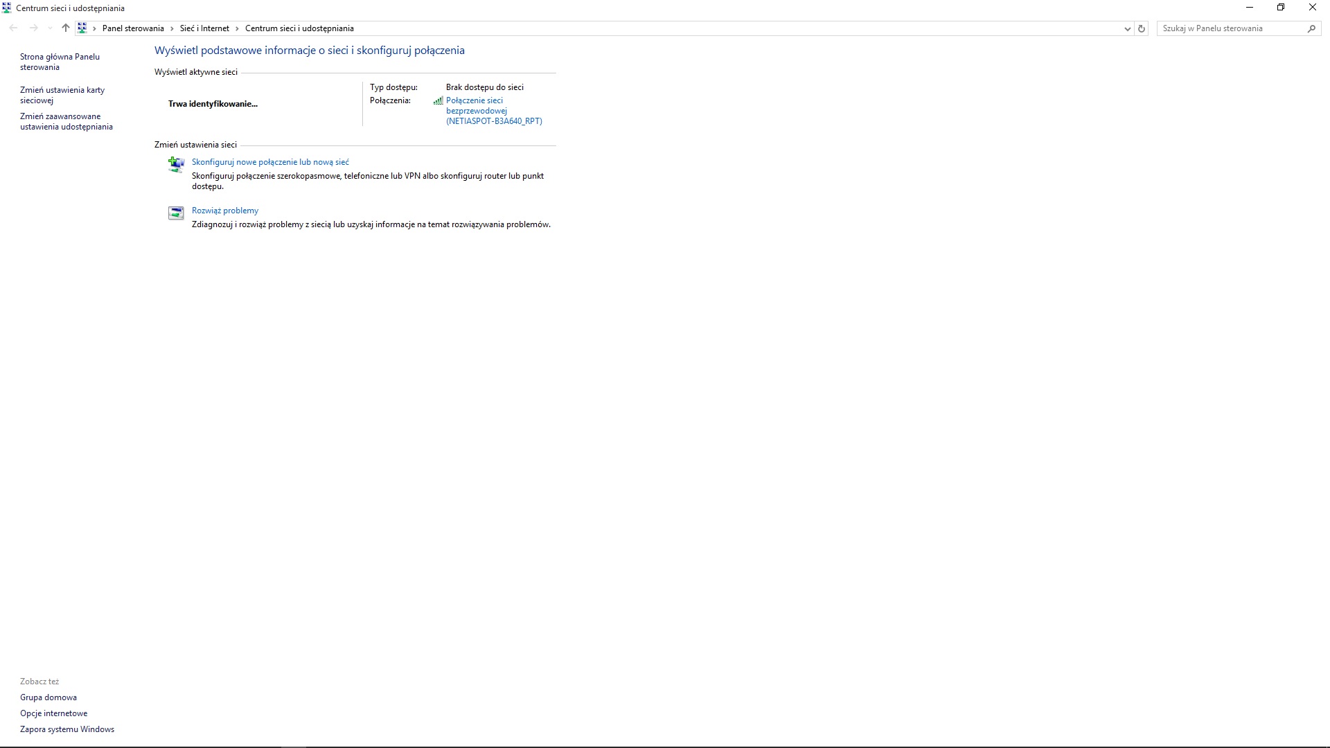

    Generally speaking, my equipment is farthest from the router and I have poor signal range. Normally I can use the network, i.e. facebook, youtube, all kinds of movies in hd online, games like FIFA17 etc - but when someone from other household members joins the network, they start listening to something on Youtube, or watch a movie or play an online game, it becomes impossible for me to play online automatically. Facebook, youtube and movies are no problem, but playing becomes virtually impossible due to high delays.
    I read a bit on the net, and decided to buy Acces Point. I bought the Asus RP-N12 Wireless-N300. I read the instructions, and at the beginning I tried the first method, i.e. configuring the network using WPS. Everything went well. On the computer, I detected a new network from the AP, connected and at this moment there is a problem that a warning about limited access to the network appears. In short, the computer is unable to identify it.
    So I reset the AP, and tried the second method, i.e. running ASUS and manually connecting it to the router and configuration.
    The effect is the same, i.e. the configuration is successful, and when I want to connect to a new network with a computer there is a problem with its identification.
    I put two screenshots in attachments. ASUS RP-N12 Connection Issues: Computer Unable to Connect to AP with TP-Link WN721N & MSI Z97SLIproblem...jpg (117.78 kB)You must be logged in to download this attachment. ASUS RP-N12 Connection Issues: Computer Unable to Connect to AP with TP-Link WN721N & MSI Z97SLIproble..jpg (172.75 kB)You must be logged in to download this attachment.
    Please help.
    Do you have any ideas?
    I would like to find a solution.
    What for? If the coverage is still poor, it won't change much - you had to buy a PLC and have peace of mind.

    bravo991 wrote:
    However, I would like to try to do something with this AP.
    If the PLC does not suit you so, connect it with a cable to TP-LINK WN721N, i.e. use as an AP and not as a repeater.

    You use the Tp-Link as a router, after connecting with an Asus cable you will use it as an AP, but the PLC is just to prevent the cable from pounding around the apartment.

    Topic finished, everything works. Thanks for the help.
