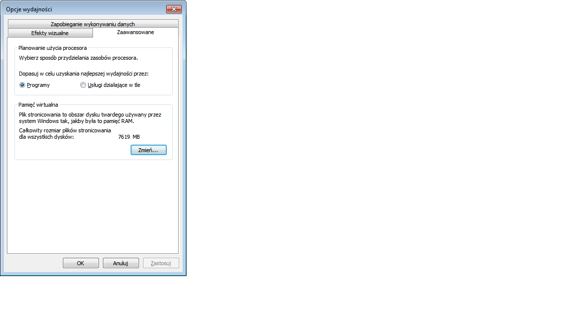

    I only know this from theory :( The point is to reserve as little SSD as possible for memory, how will the RAM run out?

    It's best to set a fixed size and not one controlled by the system, I now have 500MB because I have a lot of headroom but I never set it to be controlled by the system or turn off because it can't be turned off completely.
    The last one was about the swap because the RAM and RAM occupation dependent hibernation and it would be a big nonsense to set the hibernation on the HDD where it is about the speed of writing / reading from the SSD and not inhibiting the HDD.

    I have 8GB of RAM, no movies, sometimes short on YT, no games, mostly I navigate the web + webinars.
    Probably enough RAM for such needs? Do you have to increase by swap?
