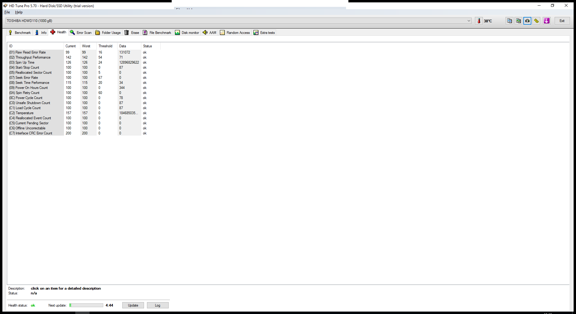

    Please provide a smart disk.

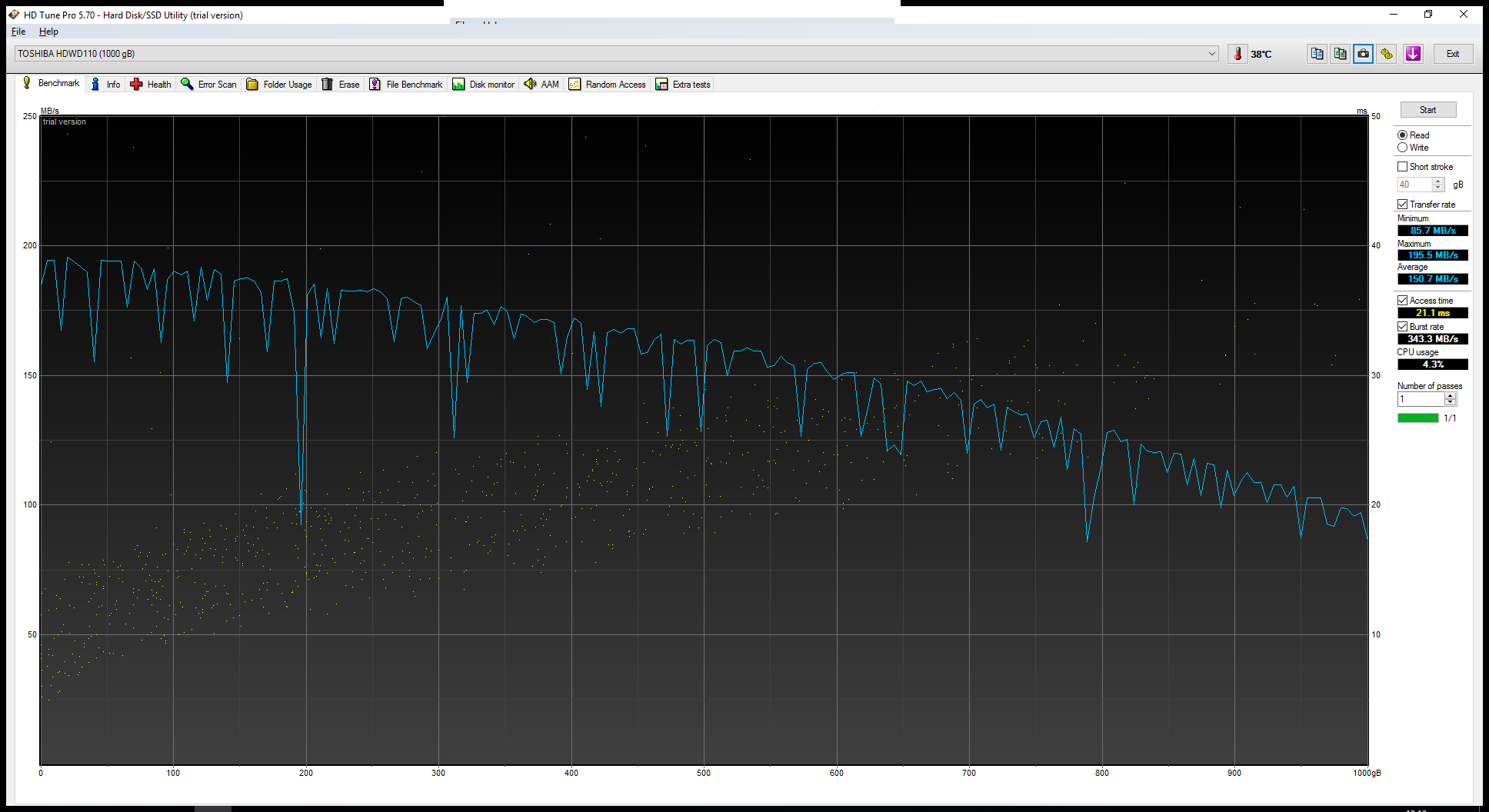

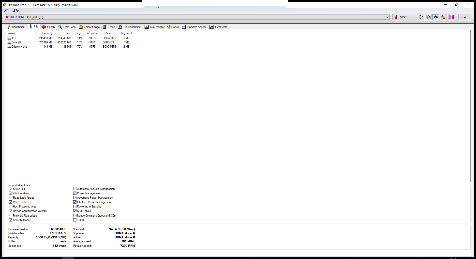

    Can it be with HDtune PRO?
    For now SSD is not an option because I have no money for it
    Added after 8 [minutes]:
    New i5-7600K, GTX 1060, Gigabyte Z270X Ultra Gaming PC Slow: Chrome Startup & HDD Noise Issues New i5-7600K, GTX 1060, Gigabyte Z270X Ultra Gaming PC Slow: Chrome Startup & HDD Noise Issues New i5-7600K, GTX 1060, Gigabyte Z270X Ultra Gaming PC Slow: Chrome Startup & HDD Noise Issues

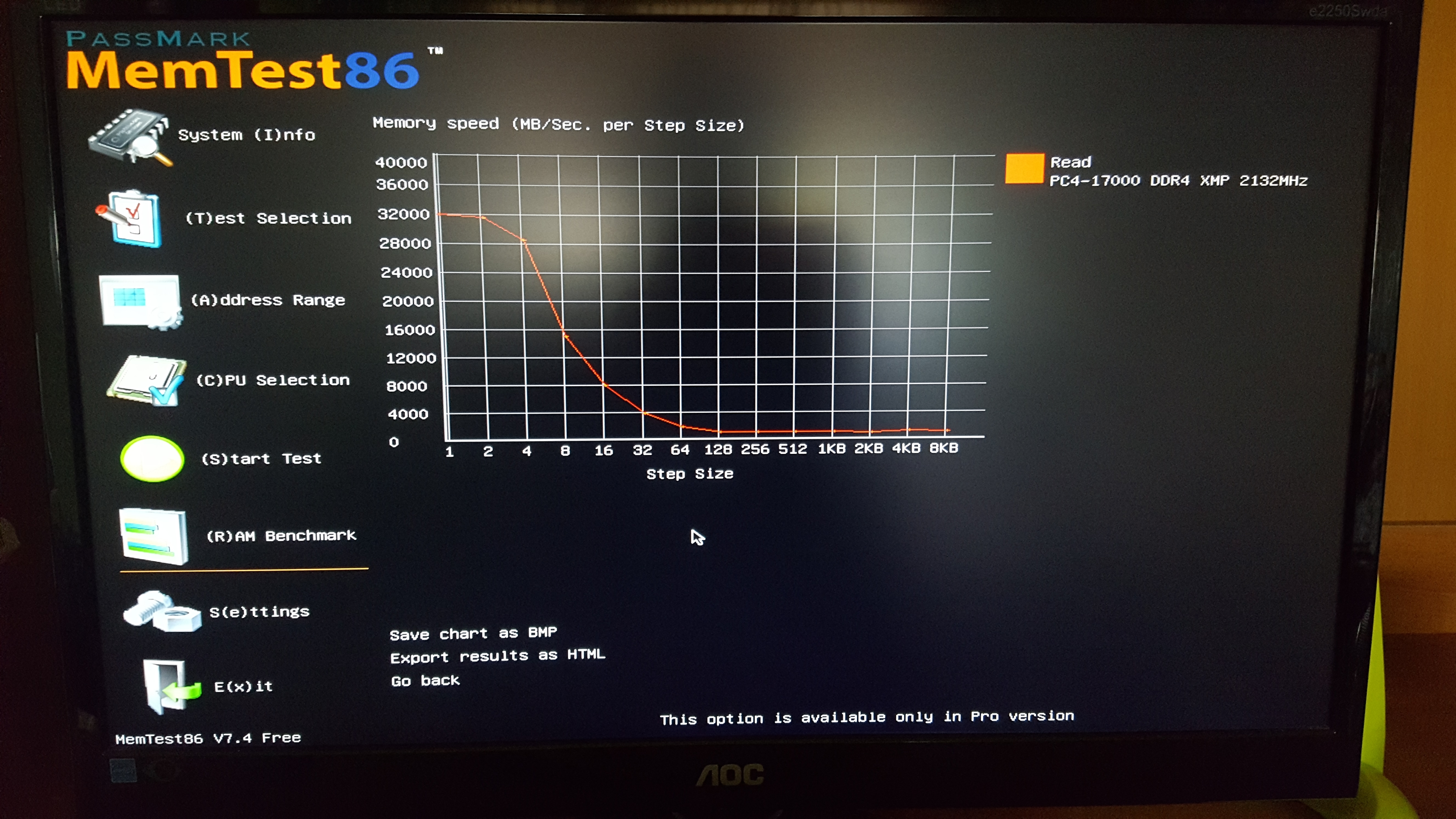

    You could test the memory with the "memtest" program.
    https://www.memtest86.com/
    Burn it best to CD, dvd, because with pendrive there are sometimes problems with booting and booting settings, I have it.
  • #10 16716012
    KrOmX
    Posts: 15
    I don't have a CD right now, I'll try on a USB stick
    Added after 33 [minutes]:
    That was it ?
    Added after 10 [minutes]:
    SMART status-OK

    That's not it, but everything works exactly as it should. The disk drive for Windows 8 and Windows 10 teaches patience. If your colleague expects chrome to start in 2 seconds, it's now time to collect for SSD. The disc disk is functional and everything works exactly as it should.
    There was no point in spending money on illuminated boards. By the way - what values has your CPU turned up to? Since a colleague has added so much hay to the K version and to a nice album, then this is probably a spectacular result? Rather, he did not overclock his memory too much, seeing after that the memory dedicated to the previous generation (DDR4-2133) was chosen, but the processor probably strongly overclocked?
