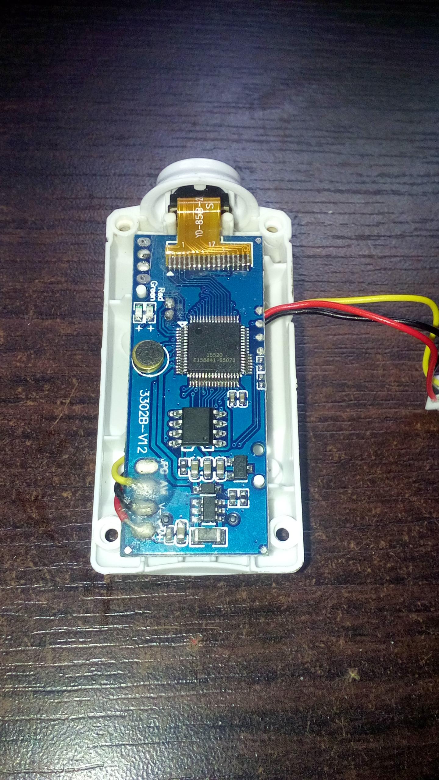

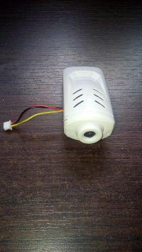

    it is a camera from a drone that has an SD card slot how to connect it directly so that it can record the image on the SD card itself there are three cables as per photo Connecting Drone Camera to Record Directly on SD Card - 3 Cables, SD Card Slot Connecting Drone Camera to Record Directly on SD Card - 3 Cables, SD Card Slot

    Is the camera in the same housing?
    {Nothing happens after powering up?

    Beczka 56
    the camera is in the same housing, there is no reaction after applying the same voltage

    Give photos of the whole, preferably from both sides, without housing.

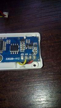

  • #5 16475503
    Beczka 56
    Added after 47 [seconds]:

    And where is this card reader?
    It looks like a regular analog camera that you can connect to at most TVs now.

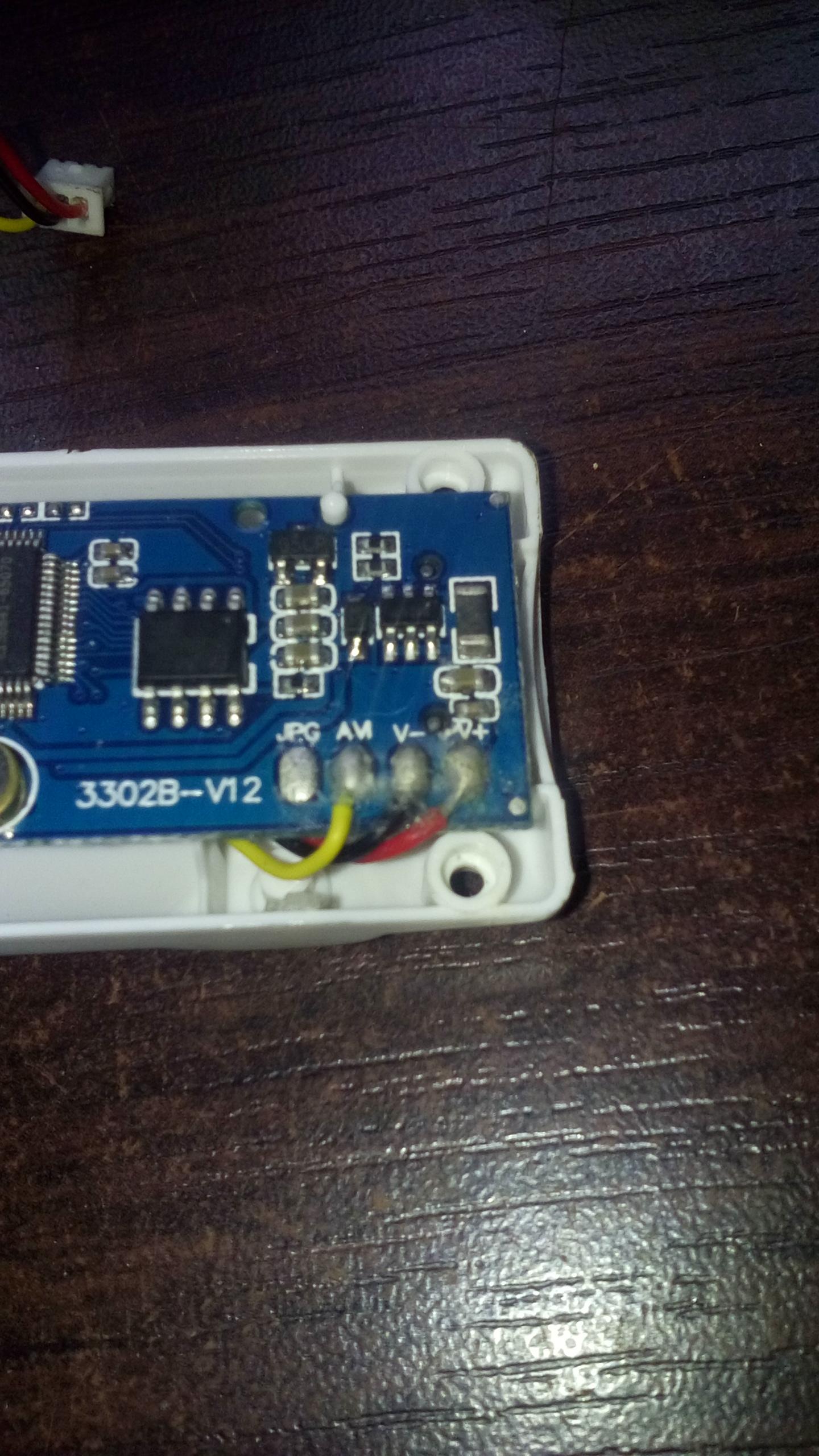

    The control is a yellow wire (A / V). Next to it is a place for an additional cable (JPG) on the board and controls taking pictures.
    This was the case in 2 cameras for Chinese drones, which I repaired.

    Ok. The yellow wire is the control. But what do you give the control - "+" or "-" or something else? Is it supposed to be just an impulse, e.g. for photos, and continuous for movies?
    Added after 9 [hours] 43 [minutes]:
    https://translate.google.pl/translate?hl=pl&s...php%3F2325987-WLtoys-V686G/page51&prev=search
    For the camera with SD card I connected (according to the link above):
    - black - minus
    - red - plus
    - yellow - for a moment to the minus - takes a picture, for a longer time (say, for more than 2-3 seconds) starts recording, once again - stops recording.
    It works for me :-) Connecting Drone Camera to Record Directly on SD Card - 3 Cables, SD Card Slot
