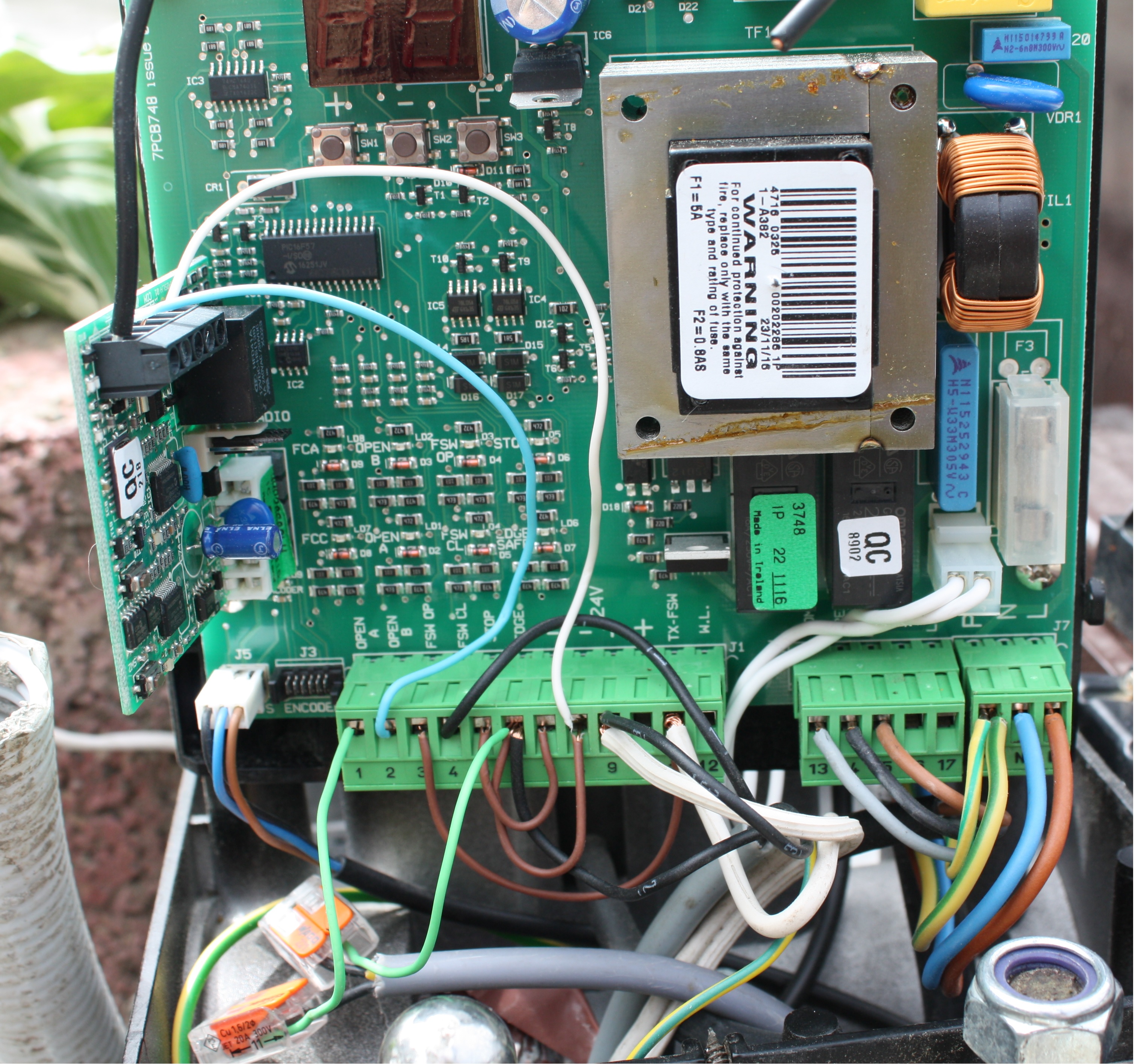

Why do my photocells click and turn off their LED when interrupted but still fail to stop a Faac 740D gate drive?

    Bama works as it should except for photocells.
    What can be the reason that photocells "click" when they are interrupted and the diode goes off but they do not interrupt the drive?

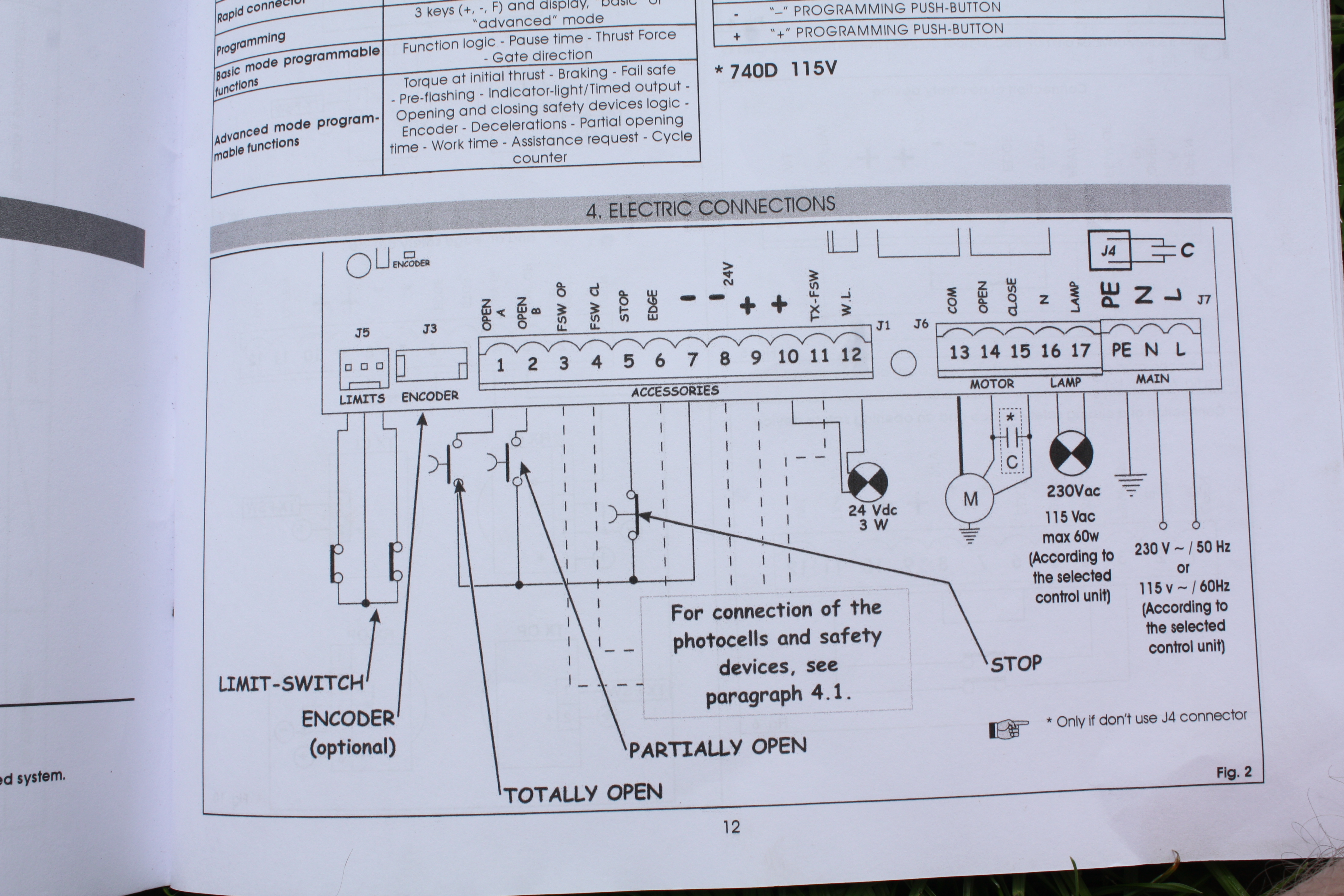

    Yes, they do not work on closing or opening.
    https://www.youtube.com/watch?v=yJxPp1PsuPk
    I connected the gate according to this scheme and it works. The pilot also works.
    In 50s the author gave a scheme for connecting photocells - it does not work.
    I tried to connect these photocells in two ways: according to the scheme from the manual and according to the scheme from YouTube. Does not work.
    If it adds FSW CL on the control panel goes out when the beam is cut, the photocells are connected correctly.

    draco1701
    I replaced this drive parameter, it doesn't work either. The photocells continue to "click" but do not stop opening or closing the gate.
    Maybe I connected something wrong?
    I marked the current connection of photocells in red. Photocells do not stop the gate, Faac 740D + Connection diagram

    draco1701
    In the diagram there are numbers 1 2 3 4 5, in the photocell itself there are numbers 2,3,4,5. Photocell clicks but I will try to remove this bridge and see if it works.

    #9 16616813
    Marek J.
    Posts: 2368
    Help: 526
    Rate: 951
    The diagram you marked and took as a jumper is a symbol of the internal contacts of the NC photocell relay ...
  • #10 16616843
    draco1701
    I took off my bridge and it works :)
