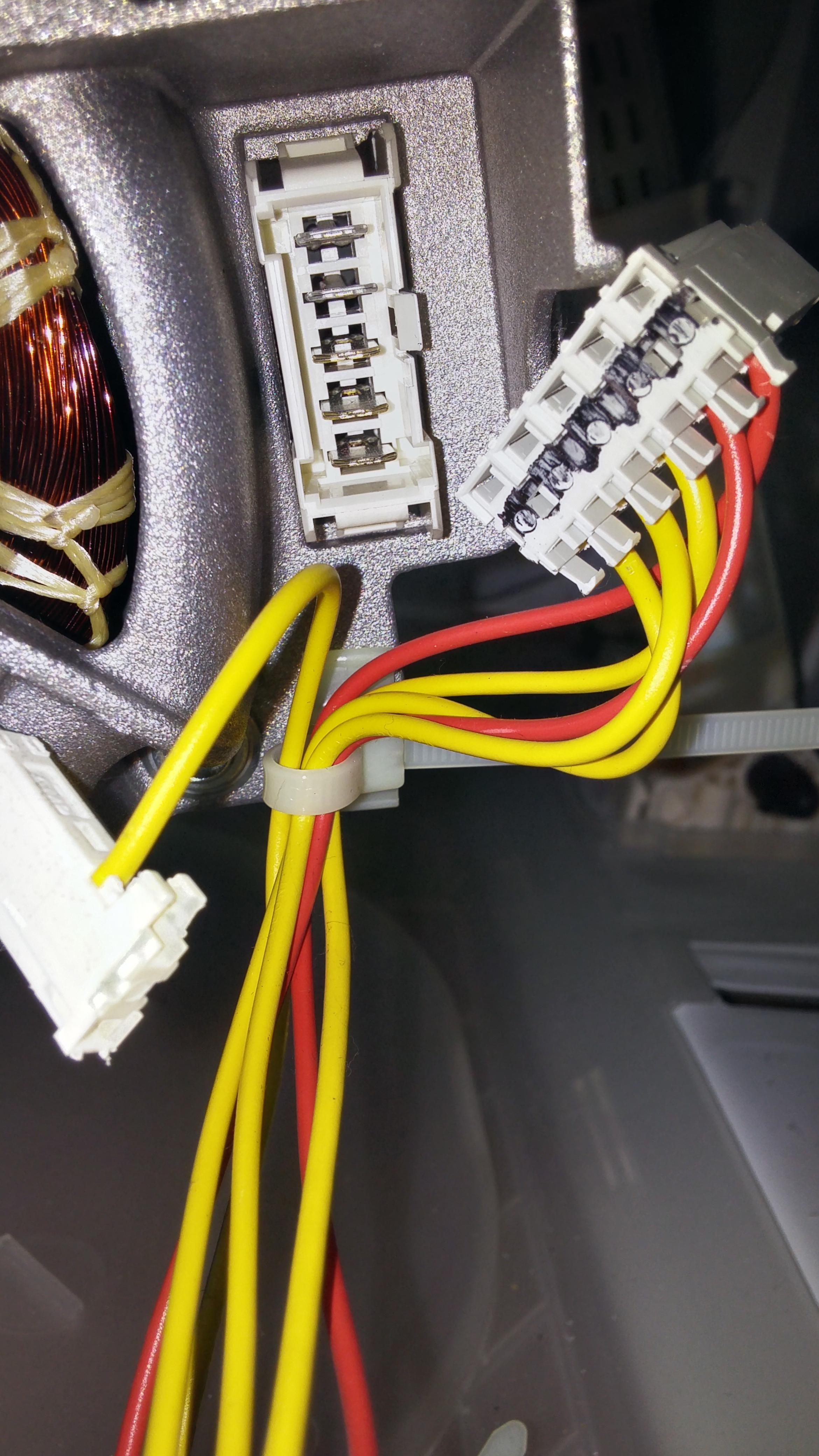

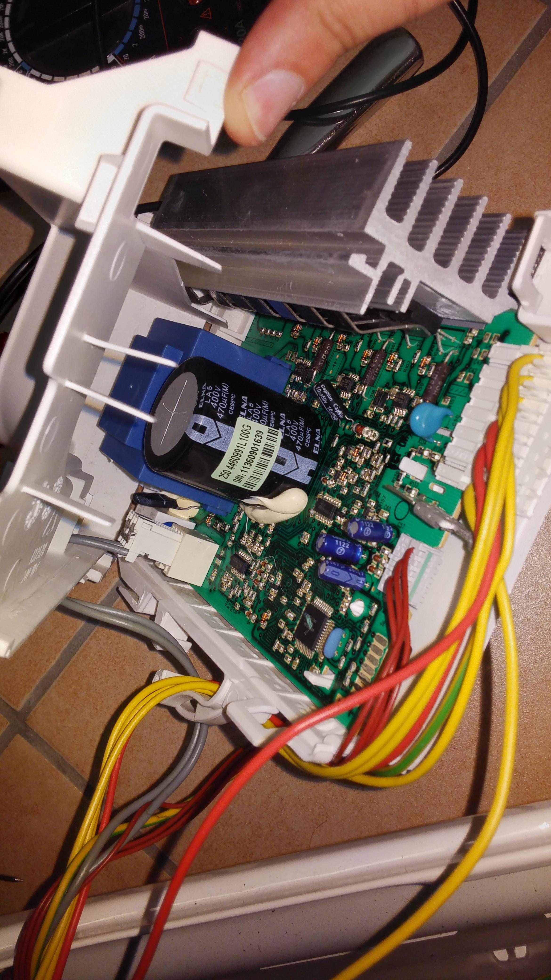

    Today I got to the washing machine.
    I attach photos of the engine and its driver. I measured the resistance of the motor windings from the ankle (the photo shows a 5-pin):
    1-2 = 118?
    1, 2 - 3, 4, 5 = ?
    3-4 = 5.8?
    4-5 = 5.9?
    3-5 = 5.8?
    Doesn't it seem strange that there is always a similar resistance between pins 3, 4, 5? Are they linked into a star?
    What can I check and how to find the fault?

    How do you think these winding resistances are not low? Maybe some short circuit? The windings have the same value, whether this would be the case during a short circuit, and I am surprised that the measurement shows as if they were connected in a triangle.

    The inverter is probably damaged.

    Motor looks BLDC. Defective motor controller called "don't know why" inverter. Second photo. Without functional electronics, the engine itself is a pile of scrap. :cry:

    You can learn something all the time :) I ordered the driver, however, I am tempted to try to repair the old one, but I would need a schematic of it. Challenge big, complicated circuit, but maybe checking the power elements, maybe checking the circuit under voltage, maybe I would conclude something. Does anyone of yours have a schematic of such or a very similar driver? Is this 118? winding some feedback for the system or some compensation? Another additional question, is there a fuse that cuts off the engine power system?

    The motor does not have magnets. It is a three-phase motor with delta connected windings and the fourth winding is a tacho. Replacing the motor power supply has revived the washing machine.
