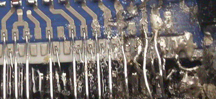

  • #12 16508066
    goblins
    Posts: 454
    Rate: 51
    Thank you for your answer and drawing. Yesterday I soldered and I think everything is fine, I will have to go on a longer route and check if everything is well after heating. I soldered a few points from the fan, I soldered the point green marked. I also send a photo of the soldered entire connector. February is darker for 2 years ago. Thank you very much for your help. Experiencing Intermittent Power Steering Failure on 2003 Opel Astra G Z14xe - Insights?
  • #13 16508676
    inot
    Posts: 3613
    Help: 449
    Rate: 818
    Cool. Soldering the entire connector is really a lot of work. Did you do it yourself? The worst thing is to remove the sticky gel, because at the same time still functioning connections can be damaged very quickly (they break off very quickly).
  • #14 16509529
    goblins
    Posts: 454
    Rate: 51
    It even turned out nice as you write :) a lot of work, but you shouldn't break it that often. I soldered myself as I wrote from 2 years ago (you can see darker February on the left) and now the split and the fan are supported, but the wires are not broken, but February is gone. When soldering, I did it so that I cut one wire, then soldered the next one, so as not to make a mistake because there are unused pins and you can make a mistake. The original cables are very soft and break easily. I sold all the pins to new wires because I had enough of the ECU every few months because some pin broke.
