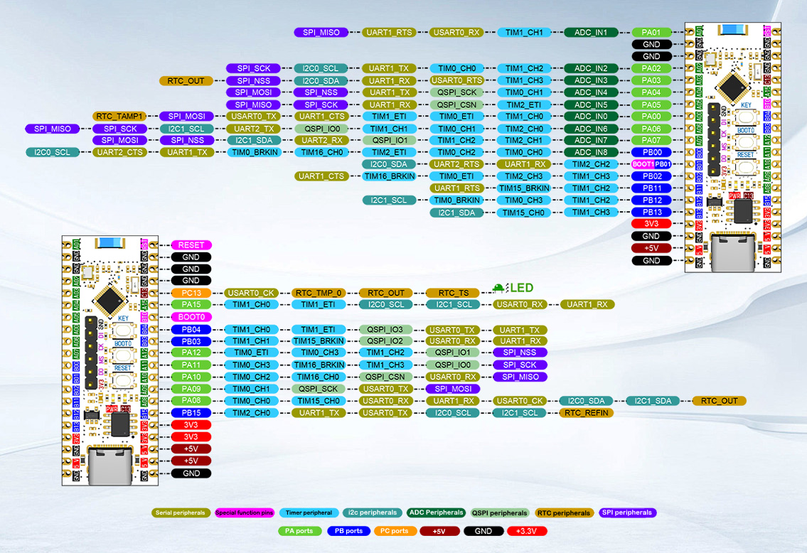

  • GigaDevice’s GD32VW553 is a Wi‑Fi 6 + Bluetooth LE 5.2 combo MCU family built around a 32-bit RISC-V core running at up to 160 MHz.
  • The board work pairs a specs roundup with a hands-on flash-and-boot test on an LCSC GD32VW553HMQ6 board using GigaDevice’s all-in-one programmer and OpenGD32VW553 firmware.
  • The tested chip identifies as GD32VW553HMQ6 with 4096KB flash, 320KB SRAM, and no external flash; the family also offers 2 MB and 4 MB variants.
  • OpenGD32 boots successfully, the AP appears as expected, and the LCSC board maps the user button to PA0 and the LED to PC13.
  • At the time of posting, the MCU is mostly seen on development boards, and no commercial product using it had been identified yet.

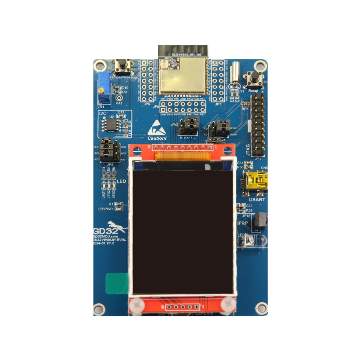

    At time of posting, GD32VW553 is mostly seen on development boards. I don't believe we've identified a commercial product using this MCU yet.

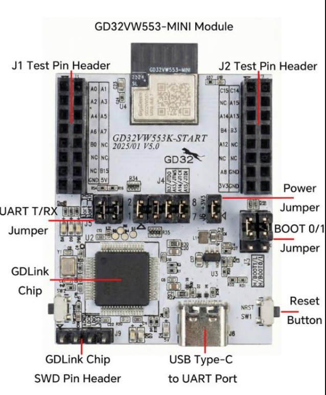

    Official GigaDevice EVAL board
    https://gigadevice.eu/products/gd32vw553h-eval
    LCSC GigaDevice GD32VW553 Datasheet - WiFi 6+BLE 5.2, 4 MB, 160Mhz MCU - OpenGD32 Firmware
    Official GigaDevice START board
    https://www.gd32mcu.com/data/documents/applic...20GD32VW553%20Quick%20Development%20Guide.pdf

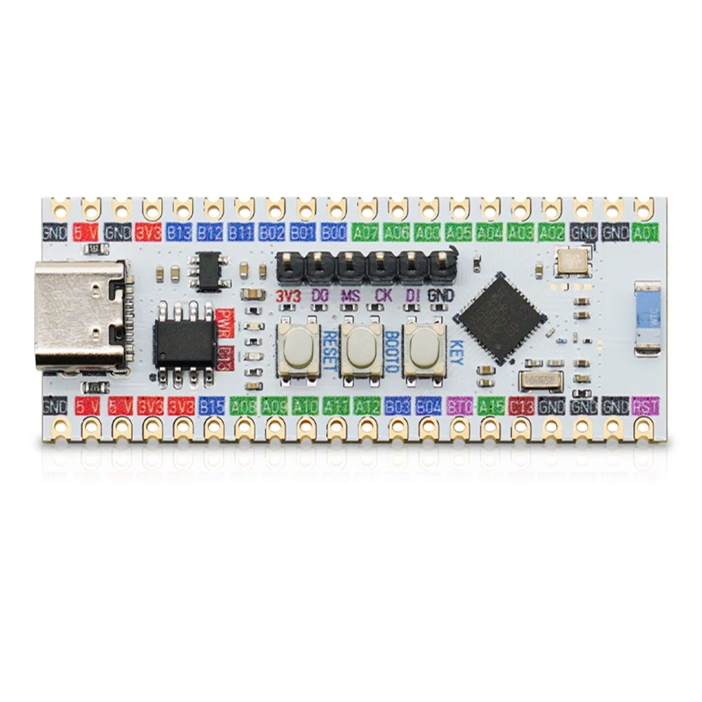

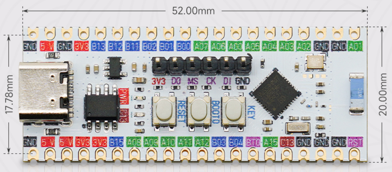

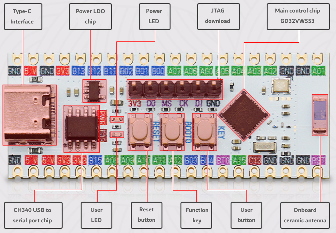

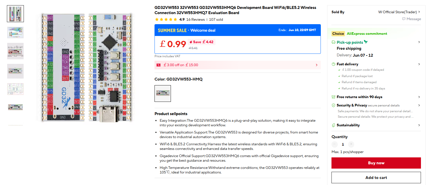

    LCSC-boards LCKFB-GD32VW553-HMQ6
    https://www.lcsc.com/product-detail/C49304632.html

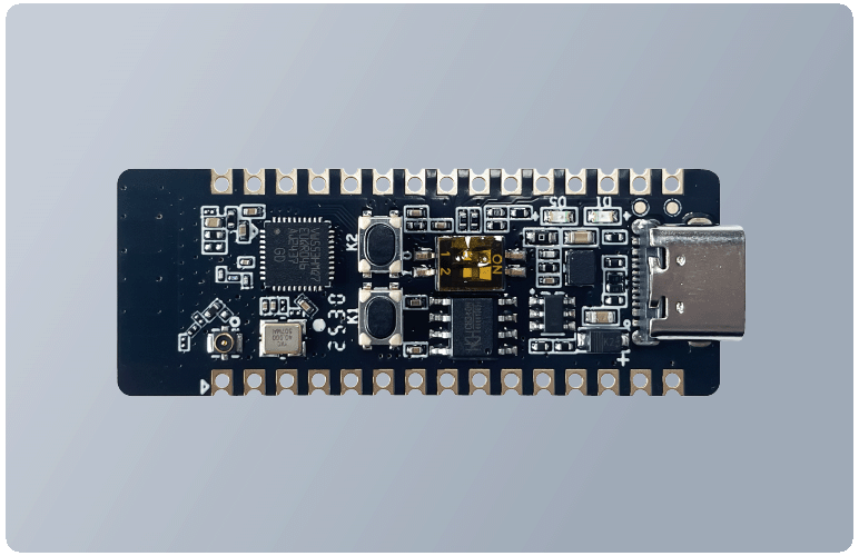

    Firefly Workshop GD32VW553-IOT-V2
    https://www.cecport.com/en/solutionsDetail?id=123
    undoubtedly others.
    I bought the GD32VW553HMQ6 LCSC board from Ali Express for £5.14 delivered https://www.aliexpress.com/item/1005009723659760.html
    It seems to be eligible for Welcome Deal pricing at the moment

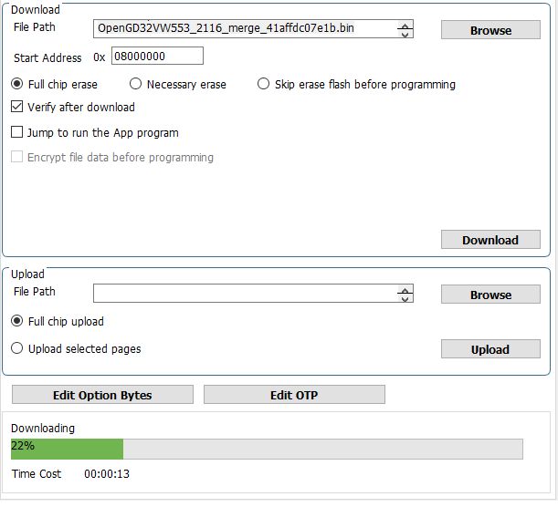

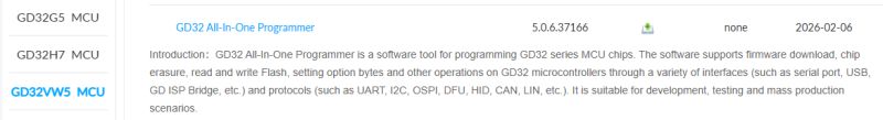

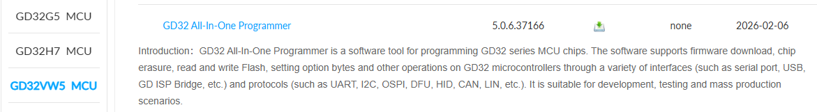

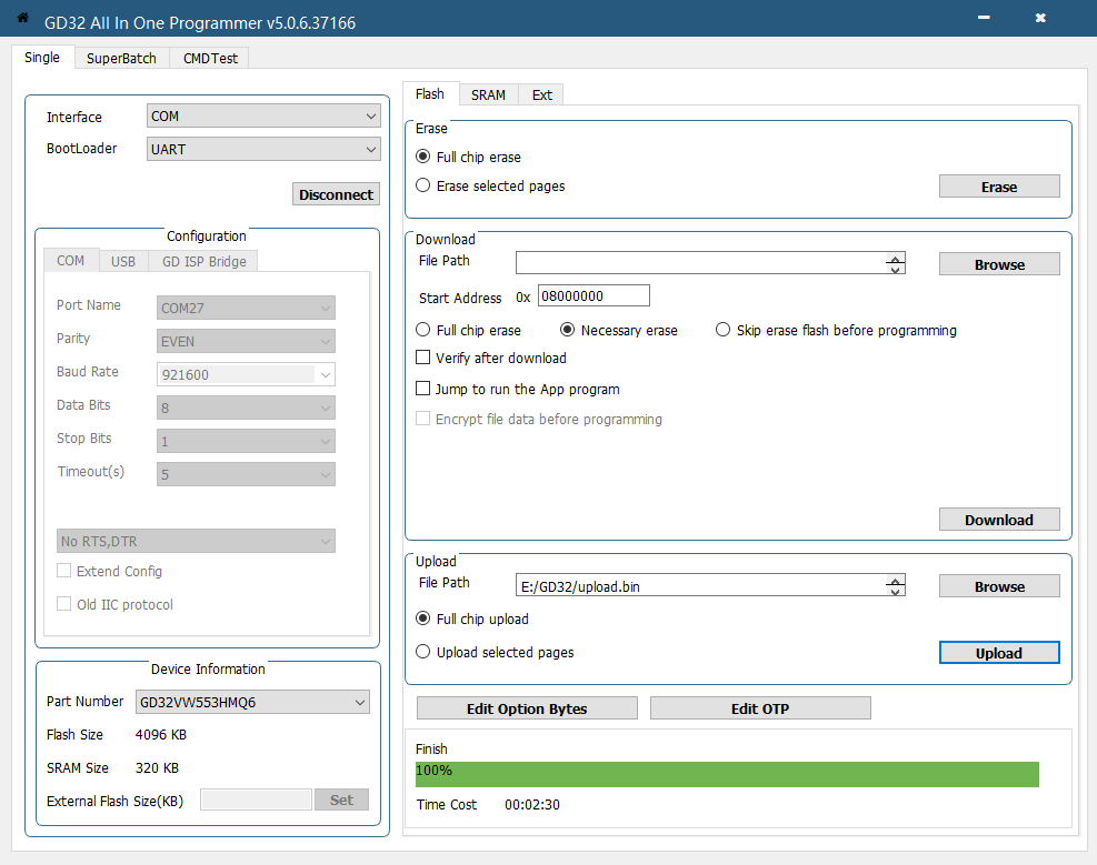

    GigaDevice supply an all-in-one programming tool for the GD32VW5
    https://www.gd32mcu.com/en/download/7?kw=GD32VW5

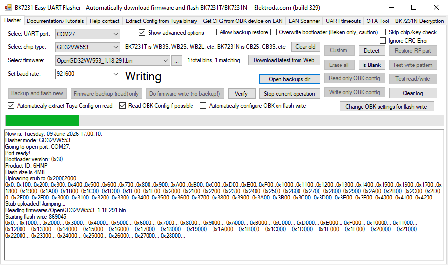

    The 7z download seems to contain English documentation, xmodem stub files, flash and efuse option xmls

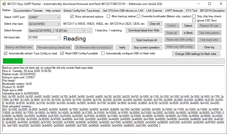

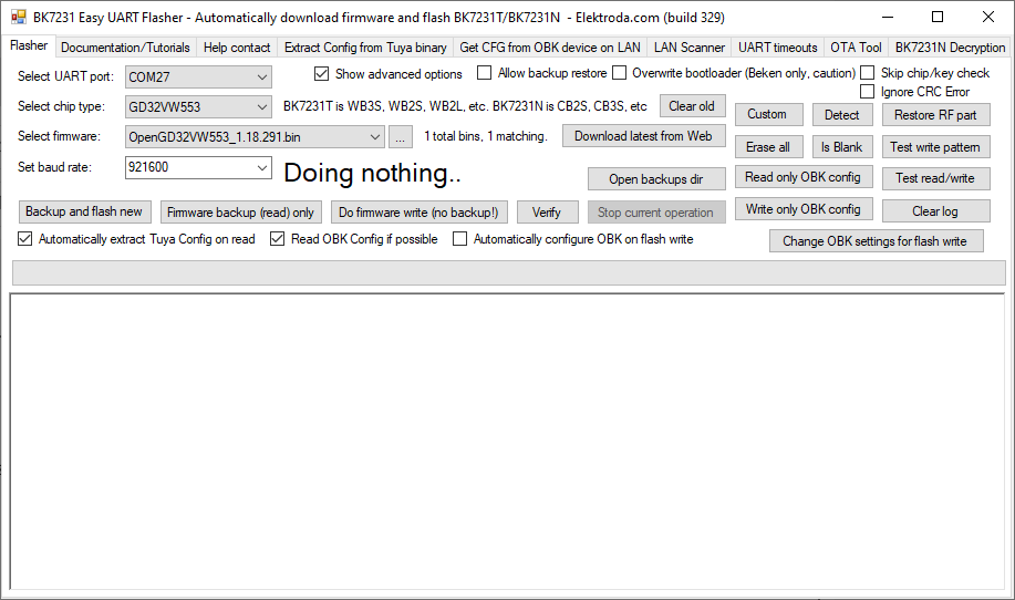

    First, a dump of the factory flash content to file. Hold BOOT0 button down (pulls PC08 high) and RST to get into programming mode.
    Connect
    UART button in GD32 AIO app.
    My chip is detected as GD32VW553HMQ6, 4096KB flash and 320KB SRAM, no external flash.
    Save full chip flash to file with 'Upload' section (upload to your PC, to a file), after specifying destination file name and location.
    At boot, factory firmware from PA06 (UART2_TX) @115200 baud prints:
    and from PB15 (UART1_TX) simply:

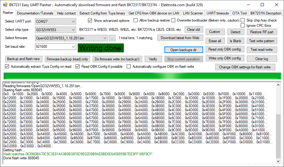

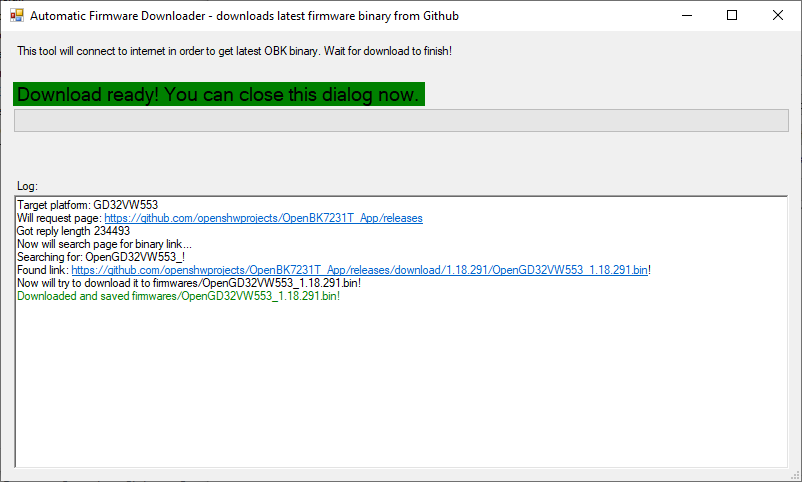

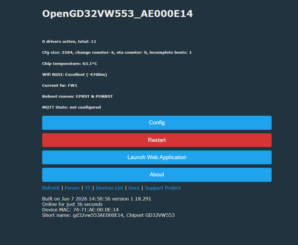

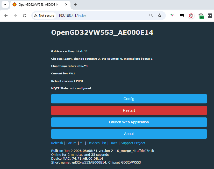

    Now to download (to the GD32) @insmod's OpenGD32VW553 port - the latest development build from https://github.com/openshwprojects/OpenBK7231T_App/actions/runs/26806809717
    OpenGD32 boot log from PA06 at 1500000 baud
    and AP is seen as expected
    Screenshot of OpenGD32VW553 status page with Config, Restart, and Launch Web Application buttons
    The user button on the LCSC is PA0. The LED is PC13.

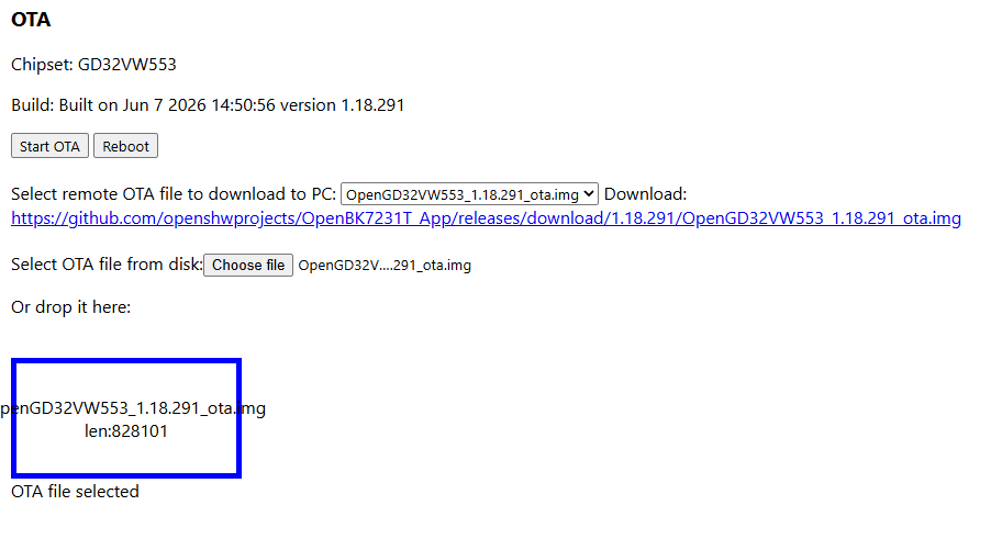

  • OpenGD32 runs 2.5 days stable with 4 MB flash support
    #3 21914654
    insmod
    Posts: 1430
    Help: 168
    Rate: 455
    2.5 days online without any crashes.
    I've tried to implement as much as possible, and i think i've more or less succeeded in it.
    All basic and advanced features i had thought about are supported, except for pin deep sleep. Even log port switching is supported.
    Dev board has a very wonky antenna, it may experience the same problem as ECR6600 if not aligned to router properly (up to disconnecting and failing to reconnect). I’ve encountered that issue, even though I’m only 2–3 meters from the router.
    I considered developing a custom stub for easier flasher integration, but i failed to upload anything to sram via programmer tool.
    SDK is configured for 4MB flash, but there are 2MB variants.
    1500000 baud rate was my decision to squeeze out a little more performance (UART is polling, i think, not DMA). Changeable via second argument of logport command. First argument can be -1 to restore default log port.
    I guess ceramic antennas are maybe not so great. I didn't know they were a thing tbh.

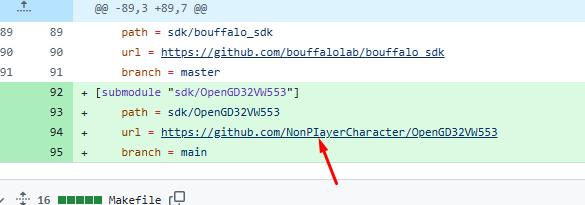

    Btw, I've spotted something interesting. I didn't notice that's the correct way to spell this username:
    Screenshot of a Git diff adding a submodule entry, with a red arrow pointing to a GitHub URL
    Some fonts can spoil things too quickly.

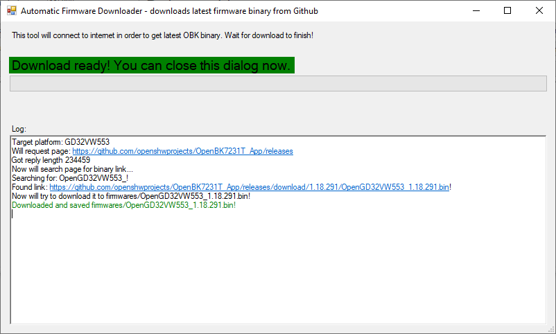

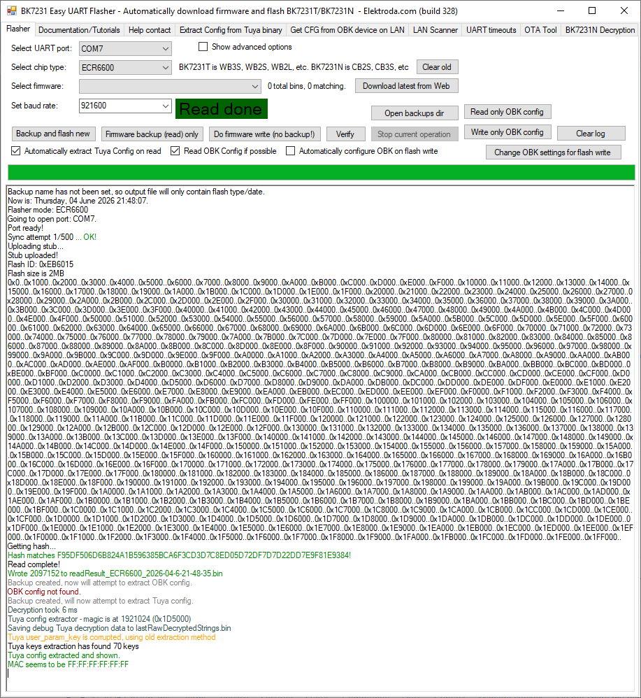

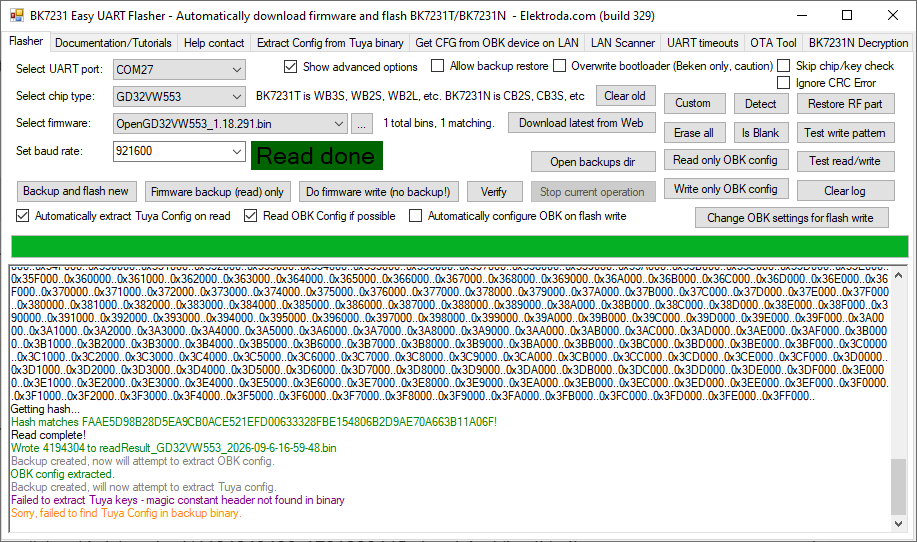

    Flasher mode: GD32VW553
    Going to open port: COM7.
    Port ready!
    Bootloader version: 0x30
    Product ID: 7HMP
    Uploading stub to 0x20002000...
    0x0..0x100..0x200..0x300..0x400..0x500..0x600..0x700..0x800..0x900..0xA00..0xB00..0xC00..0xD00..0xE00..0xF00..0x1000..0x1100..0x1200..0x1300..0x1400..0x1500..0x1600..0x1700..0x1800..0x1900..0x1A00..0x1B00..0x1C00..0x1D00..0x1E00..0x1F00..0x2000..0x2100..0x2200..0x2300..0x2400..0x2500..0x2600..0x2700..0x2800..0x2900..0x2A00..0x2B00..0x2C00..0x2D00..0x2E00..0x2F00..0x3000..0x3100..0x3200..0x3300..0x3400..0x3500..0x3600..0x3700..0x3800..0x3900..0x3A00..0x3B00..0x3C00..0x3D00..0x3E00..0x3F00..0x4000..
    Stub uploaded! Jumping...
    Flash ID: 0x000016
    Flash size is 4MB
    0x3F1000..
    Getting hash...
    Hash matches BC6B1E3E5D6005A657BD21992BD5F32CBF469E1940972D09FF7AD6C434652519!
    Read complete!
    OBK config loaded. You can now view it by clicking 'Change OBK settings' button.
    You can also edit it however you want.
    You can also use 'Write OBK config' button to write it back with your changes.
    Could've been done without stub, but read/write is faster with it. Stub code is ported from ECR.
    Still, erase is very slow. Might not be possible to restore backups yet.
    Flash id is fake.

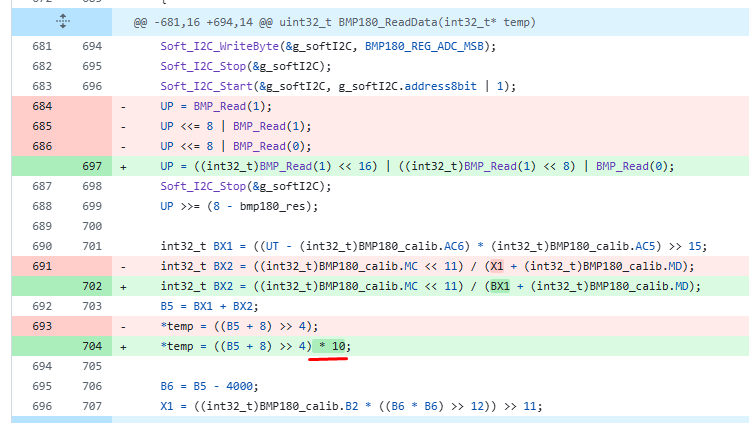

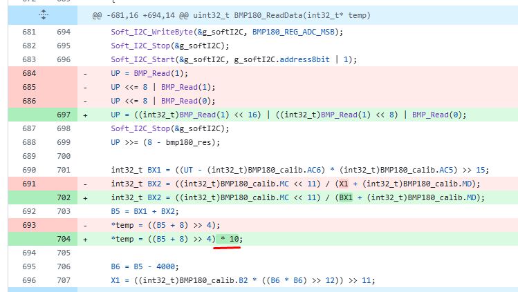

    Edit: was there a bug?
    Screenshot of a C code diff: UP calculation changed and temp assignment multiplied by 10.
  • #12 21915357
    insmod
    Posts: 1430
    Help: 168
    Rate: 455
    Yes, but only for BMP180

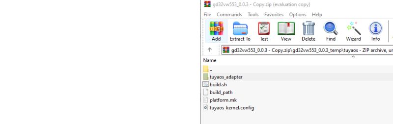

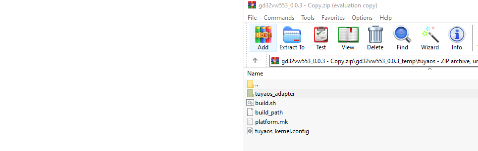

  • Lists additional TuyaOS SDK archive URLs

    not much. delete the toolchain folder and the zip is then 500k
    these pruduct zips are mainly only the toolchain side, the SDK side is needed to compile for any of the platforms I think.
    I only know of these SDK zips, not posted these before.
    https://images.tuyacn.com/smart/sdk/b679f97d19afb983f00ab8e1935b81f4cfb15910.tar.gz - TuyaOS-3.8.31
    https://images.tuyacn.com/smart/sdk/5a2aba8c411c9a23fefd557c4fa9ce5b90f206d8.tar.gz - TuyaOS-3.11.31

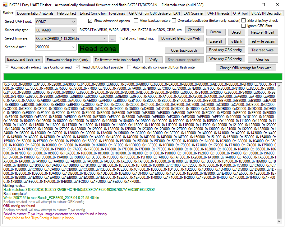

    insmod wrote:
    moved a lot of ECR functions to a base class, and didn't test if ECR still works.
    Screenshot of BK7231 Easy UART Flasher showing read logs and the green “Read done” message. Screenshot of BK7231 Easy UART Flasher showing “Writing done” and a flashing log panel Screenshot of BK7231 Easy UART Flasher showing firmware read log and a large hex data panel.
    seems OK reading and writing still. no erase completion notice up top or log, but it reads back as empty
  • #17 21916009

    @divadiow since you have HMQ6 chip, what is the product ID it reports in the flasher? 7HMP for HMQ7.
  • #20 21916356
    Posts: 5195
    Help: 446
    Rate: 913
    >>21916353
    Product ID: 6HMP
    Added after 5 [minutes]:
    GD32VW553KIQ6 -> 6KIP
    GD32VW553KMQ6 -> 6KMP
    GD32VW553HIQ6 -> 6HIP
    GD32VW553HMQ6 -> 6HMP
    GD32VW553KIQ7 -> 7KIP
    GD32VW553KMQ7 -> 7KMP
    GD32VW553HIQ7 -> 7HIP
    GD32VW553HMQ7 -> 7HMP
    apparently there are 1,319 (!) part-number records in GD_MCU_DLL.dll
    • GD32AllInOneProgrammer_GD_MCU_DLL_partno_pid_map.csv (65.44 KB) You must be logged in to download this attachment.

    Ok, you're welcome. Autodownloader works?

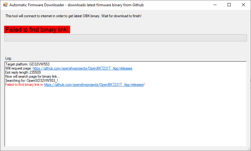

  • #26 21918214
    Posts: 14743
    Rate: 12839

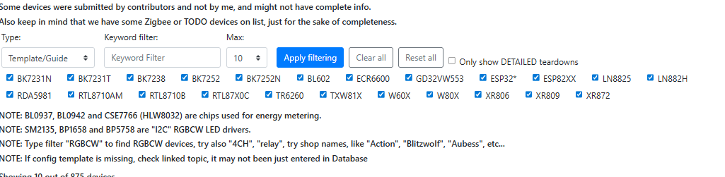

    Hey @divadiow , have you checked how well OBK sensor drivers are working with GD32? Can you also share some screenshots from GD32 in our flasher? I'm working on a video, so it could be really helpful.
    We also need GD32 entry here: https://openbekeniot.github.io/webapp/devicesList.html
  • GD32 platform filter and dev board support added
    #27 21918224
    Posts: 5195
    Help: 446
    Rate: 913
    I haven't actually tested much.
    some EF grabs
    LCSC GigaDevice GD32VW553 Datasheet - WiFi 6+BLE 5.2, 4 MB, 160Mhz MCU - OpenGD32 Firmware LCSC GigaDevice GD32VW553 Datasheet - WiFi 6+BLE 5.2, 4 MB, 160Mhz MCU - OpenGD32 Firmware
    read in progress
    read complete
    write in progress
    write complete
    plain home
    will do some other bits. brb
    Added after 21 [minutes]:
    add GD32 platform filter https://github.com/divadiow/OpenBekenIOT-weba...mmit/6d0e573e14a5dc30a20c779c8baa98bd12afa075
    Screenshot of a webpage with keyword filters and a checkbox list of chip/device names.
    add LCSC dev board https://github.com/OpenBekenIOT/webapp/pull/283
    ota https://github.com/OpenBekenIOT/webapp/pull/281
