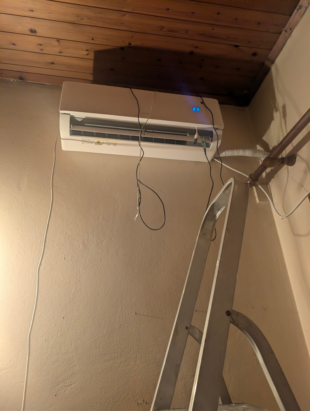

    Hello!

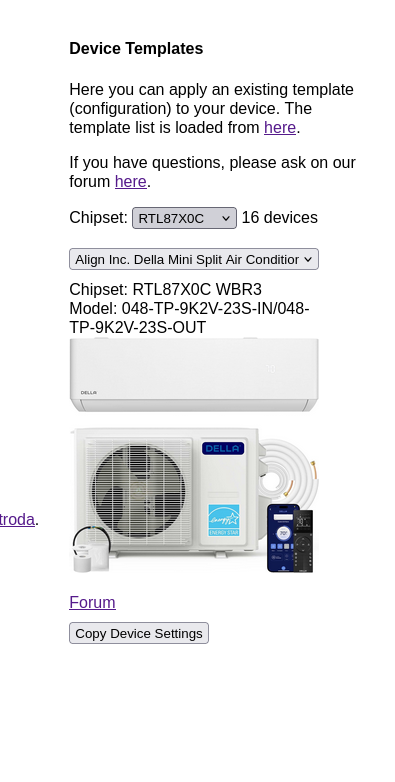

    I just got an AC installed 2 days ago and found it very similar to the Della Minisplit (see https://www.elektroda.com/rtvforum/topic4119999.html ). The app was some smarthome TCL thing powered by tuya so it matched even further what was documented on that forum post. It seems like this model is available in some places in the Balcans and Iberia including Greece.
    Pictures make it seem very similar inside too.
    Here is a Greek Marketplace where you can find retailers that sell this Unit.
    https://www.bestprice.gr/item/2163894640/nord...tu-a-plus-plus-plus-a-plus-plus-me-wi-fi.html

    It has a TCWBRCU1 WiFi Module inside which I backed up the firmware for(not sure if this applies to all modules but my module was able to enter bootloader mode shorting rx and A0 together) and for me it is currently running openbeken (Built on Jun 7 2026 14:50:01 version 1.18.291).
    I followed the guide from https://www.elektroda.com/rtvforum/topic4125928.html
    However I am stuck figuring out how to configure this. Specifically I cant do it from the webui and I needed to make a autostart script and I have startDriver TCL in it.
    The current driver seems to turn on the ac but isnt able to set temperature or read it? I also have not figured out how to connect it to home assistant. When setting temperature it seems to do a double beep and turn off.
    So I need to figure out how to read serial from the driver RX on openbeken and how to correctly load in the device drivers. Then once all signalling issues have been fixed a guide along with documentation can be written for this adding one more AC to the device compatability of openbeken.
    Any help would be appreciated!

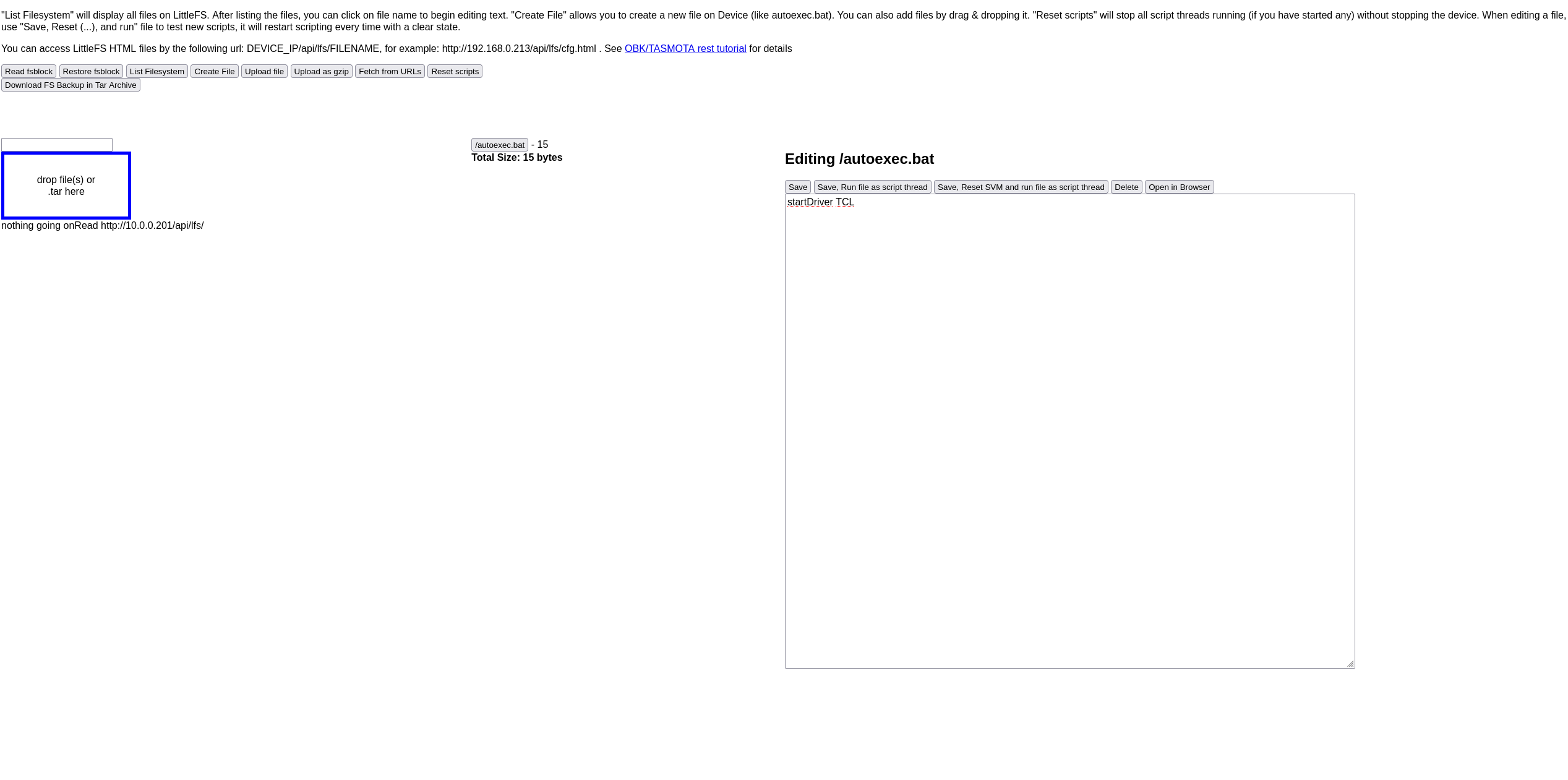

    Attached are all the files I got.
    What I can't do from the webui is press the copy device settings and make it do something
    [WIP] Nordstar AC TN-X NORX-10CHSD/ZA31 - OpenBeken TCL driver
    I remember reading that I need to do something with GitHub Actions, but I haven't figured out what I would need to configure in the files of the repository in that case.
    I think the TCL driver works because setting ACMode 1, it goes into cooling mode at 16 C( mentioning this in case it is relevant since I haven't figured out what is the default value it sends to the AC. If it does send something) At least based on my understanding, I found this reverse engineering of the TCL protocol and the 0x03 command seems the same since power and buzzer and display work correctly (based on the documentation at https://github.com/adaasch/AC-hack whiles yes this isn't openbeken it still somewhat seem to be the same thing), so my idea that the TCL driver could work is that it works partially.
    What seems different is that Tuya seems to have had exposed 0.5 C target temperature steps. I haven't still figured out what my AC reports back since I don't see any raw serial messages in the logs.
    The only configuration I was able to make is my home SSID and the autoexec.bat as follows

    we can already see a difference. the tcl driver is fixed at 9600 baud but your dump is expecting 115200
  • ACmode works at 9600 but not 115200
    #6 21917547
    notupus
    Level 4  
    Posts: 9
    That I also noticed and I wanted to change the baud in the driver to test it out but before that ACmode 1 turns the ac to cooling mode at 16C so maybe the controller has autobaud in rx? It's quite confusing to me right now since it shouldn't work but it works to some extent. But thanks for reminding me since when I parsed the 2MB file and when I did the tests there was a bit of time in between so I forgot that this was a discrepancy.
    Is there a way to dump incoming serial to logs and set baud from commands? Ignoring the TCL driver for now until I figure out how to compile with custom baud and some debug output?
    Added after 1 [hours] 14 [minutes]:
    At 115200 baud ACmode does not work but it does in 9600.

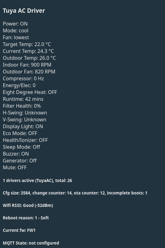

    I am going to go though every temperature and every mode to try and see how this works. What is very odd is that TCL driver got display and buzzer working aswell as ac mode.
    Added after 42 [minutes]:
    Someone got the binary and is kicking me off the ac in tuya, anyway I got most of the properties Dongle to AC mapped
    Packet Structure Overview:
    Header: A5 01 01 (Sync & Direction)
    Source: 21 (Dongle to AC) or 23 (AC to Dongle)
    Sequence: 1 Byte (increments per packet)
    Padding: 00 00
    Length: 1 Byte (Total packet length)
    CRC/Checksum: 2 Bytes
    Payload Start Marker: 0A 0A (Dongle) or 0C 0C (AC)
    Payload: Consecutive key-value pairs (Property ID + Value)
    Decoded Property Matrix:
    Property ID Name Length Values (Hex to Meaning)
    00 01 Power 1 byte 00: Off, 01: On
    00 02 Target Temp 4 bytes Celsius * 100 (e.g., 00 00 0A 28 = 26.0°C)
    00 03 Current Temp 4 bytes Celsius * 100 (Read Only)
    00 05 Fan Speed 2 bytes 0000: Auto, 0100: Lowest, 0200: Low, 0300: Mid-Low, 0400: Mid, 0500: Mid-High, 0600: High, 0700: Turbo
    00 0E Horiz. Swing 1 byte 01: Auto, 02: Left, 03: Middle, 04: Right, 09: Fix Left, 0A: Fix Mid-Left, 0B: Fix Mid, 0C: Fix Mid-Right, 0D: Fix Right
    00 11 Vertical Swing 1 byte 01: Auto, 02: Up, 03: Down, 09: Fix Above, 0A: Fix Mid-High, 0B: Fix Mid, 0C: Fix Mid-Low, 0D: Fix Down
    00 12 Mode 2 bytes 0000: Auto, 0100: Cool, 0200: Dry, 0300: Fan, 0400: Heat
    00 15 Health 1 byte 00: Off, 01: On
    00 1E Display Light 1 byte 00: Off, 01: On
    00 22 Sleep Mode 1 byte 00: Off, 01: Standard, 02: Aged, 03: Child
    00 25 Beep/Buzzer 1 byte 00: Off, 01: On
    00 2D Generator 1 byte 00: Off, 01: Level 1, 02: Level 2, 03: Level 3
    00 73 Mute 1 byte 00: Off, 01: On
    00 DF Eco Mode 1 byte 00: Off, 01: On
    00 0C V. Motor Status 1 byte 00: Stopped, 01: Moving (Read Only)
    00 0D H. Motor Status 1 byte 00: Stopped, 01: Moving (Read Only)
    Now I have to map AC to dongle using the IR remote and that should have all the statuses right?

    >>21917673 >>21917709 Did you figure out anything interesting? I have found so far everything but
    1780941418.982 | AC (ACM0) | [Raw: 0064000002c6]
    - [?] UNKNOWN PROPERTY (0x64). Remaining Payload: 000002c6
    1780941423.189 | AC (ACM0) | [Raw: 00c00000000c]
    - [?] UNKNOWN PROPERTY (0xc0). Remaining Payload: 0000000c
    I think this might be power metering, but I have to validate it.

    #16 21917762
    notupus
    Level 4  
    Posts: 9
    >>21917751
    Here is the parser and CRC and whatever I have found, along with a bit of data (including startup from power off, IR control, Tuya control, and a reset (pressing display multiple times) and then reprovisioning in Tuya.
    https://github.com/Notupus/tuya_capture/
    Added after 16 [minutes]:
    https://github.com/Notupus/tuya_capture[postid:7b92c8239d]21917762[/postid:7b92c8239d]
    I think this is fully decoded!
    Now a driver will have to be made based on this parser and the data, and we can have one more device freed from Tuya. Anyway, I am flashing OpenBeken again since everything but the timers have not been captured (but again, who wants AC timers?), also I can't sleep with this mess above my head.
    Wall-mounted air conditioner showing “23”, with hanging wires and a ladder leaning against the wall.
  • Parser still mislabels fan and mode enums

    Added after 2 [hours] 57 [minutes]:
    “Tuya AC Driver” screen listing air conditioner settings, readings, and system status
    Not bad for first day
