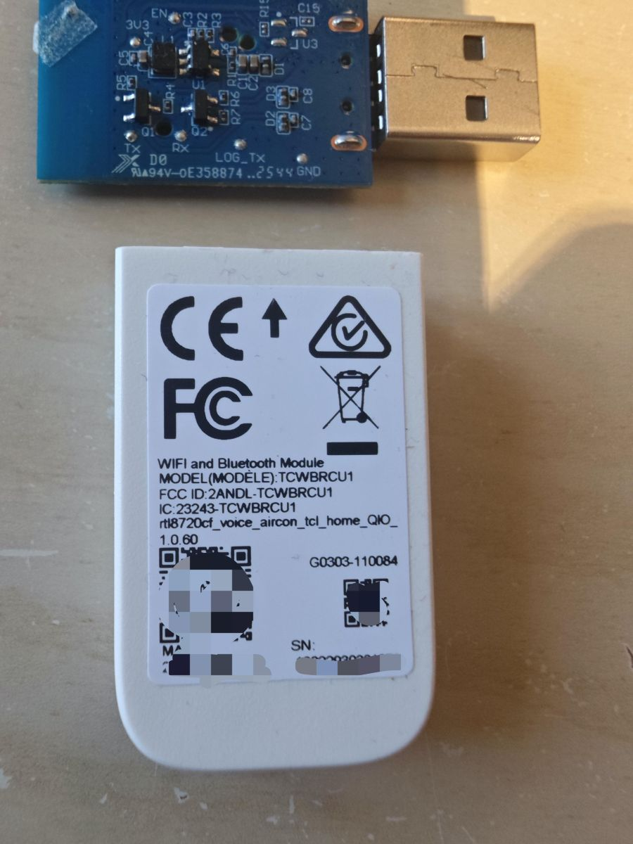

    USB plug circuit board next to a white Wi‑Fi/Bluetooth module label with certification marks
    From the description of the USB module it says:
    WIFI ad Blutoth ModuleMODEL(MODÉLE):TCWBRCU1
    FCC ID:2ANDL-TCWBRCU1
    IC:23243-TCWBRCU1
    rt18720cf_voice_aircon_tcl_home_Ql0_1.0.60G0303-110084
    Inside as expected the same WBR3 module. I added it to the tuya app, and I get to extract from the cloud api the DPIDs, model and all relevant information. I have also as suggested extract a boot log from the TX0_LOG in the original firmware, and also I have captured some traces form the UART that is sent to the AC from the WBR3.

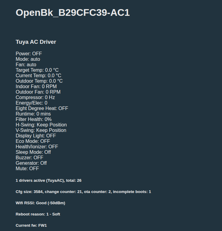

  • TuyaMCU driver unsupported; use Notupus OpenBeken build
    #2 21919462
    Posts: 5200
    Help: 446
    Rate: 914
    despite having different schemas, your Daitsu DOSM-21KDT shares 77 dpIDs with @notupus's Nordstar NORX-10CHSD.
    Yours has 18 unique IDs.
    Nordstar only dpIDs
    dpidcodeaccesstypemeaning
    157anti_directblowrwboolAnti direct-blow
    158widearea_windrwboolWide-area airflow
    159encircle_windrwboolEncircling wind
    160zone_windrwboolZone airflow
    161left_ht_directionrwenum 0-18Left horizontal airflow direction
    162right_ht_directionrwenum 0-18Right horizontal airflow direction
    163wind3d_switchrwbool3D wind switch
    164wind3d_typerwenum 0,13D wind type
    165solar_powerrovaluePV input power
    166grid_powerrovalueGrid input power
    167solar_electricityrovaluePV energy
    168solar_stateroenum 0,1PV operating state
    169openadr_eventlistrwstringADR event parameters
    170openadr_switchrwboolADR switch
    171openadr_statusrwboolADR status
    172openadr_requestrwenum 0,1Request DR task
    195virtual_ai_timerovalueCloud-only AI eco runtime
    196virtual_ai_saverovalueCloud-only AI energy saving

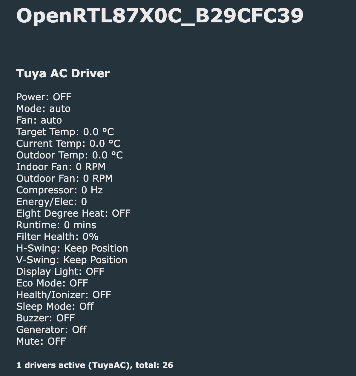

    Nauttor wrote:
    I did some diggings with Gemini and based on his replies I tried to configure the Openbeken to send thru channels the basic ON/OFF sequences but I failed badly to get any result. I was getting all the time:
    The TuyaMCU driver will be of no use for this device. @notupus's work-in-progress build seen in their fork here https://github.com/Notupus/OpenBK7231T_App will need to be flashed - either by UART or OTA to it. The build files are under the actions here https://github.com/Notupus/OpenBK7231T_App/actions and require you to be logged into GitHub to download.
    However, as it's in development, maybe it's not ready. Only notupus will know I guess. And even then their build may not cater for the additional dpIDs seen in your device.

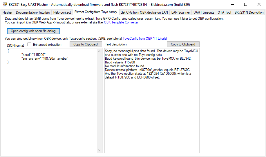

    not really sure. maybe yours is different enough that the TuyaAC driver is still not the right fit. Maybe it is and yours is a different baud?
    Did you run your backup through Easy Flasher Tuya config extractor to see what baud it shows, if any?
    Screenshot of BK7231 Easy UART Flasher showing JSON output and a message about missing pin data

  • Power cycle fixed AC board hang and restored telemetry
    #12 21922082
    Nauttor
    Posts: 17
    I loaded the new version, and...
    Status screen for “Tuya AC Driver” showing AC parameters, mostly OFF and 0 values.
    Pretty much the same result just a list of things that show 0 or Off like is not reading. I started the driver with the command startdriver tuyaac but nothing.
    Also I don't see any reaction on the LOG when i send commands with the remote neither, not sure if it is expected.
    Well when I load the driver I see this
    Info:MAIN:Starting tuyaAC.
    Info:TuyaAC:TX UART: LEN=13 CRC=0x0805 A5 01 00 21 03 00 00 0D 08 05 00 00 01
    Info:TuyaAC:TX UART: LEN=14 CRC=0x0257 A5 01 01 21 04 00 00 0E 02 57 0B 0B FF FF
    Info:MAIN:Started tuyaAC.
    but nothing afterwards. just wifi messages. That HEX with the FFFF should ask the machine to send back the parameters to fill the UI info, but that is clearly not happening,
    UPDATE!!!
    Added after 49 [minutes]:
    Well, you will not believe it, same happen again, my AC was hanged, the internal board I guess, so I was not seeing anything.
    I did a complete power off and on again, that rebooted the AC board, and all of a sudden on a fresh boot:
    Screenshot of “Tuya AC Driver” showing air conditioner status settings and temperatures.
    So that was success.
    Now I get almost all parameters, at least all relevant ones. I have detected a minor error, Fan Mute is detected as lowest, instead of mute, and mute detected as lowest, they are exchanged.

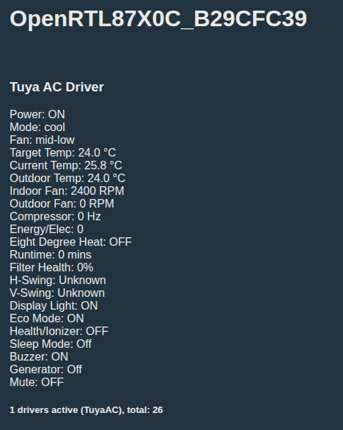

    >>21922082
    Added after 23 [minutes]:
    OK I tested back Notopus version and it seems to work, with some caveats, like the fan modes not matching 100%, and other parameters.
    This is what I see in the Log:
    Info:TuyaAC: - [0x0001] Power: On
    Info:TuyaAC: - [0x0002] Target Temp: 23.0 C
    Info:TuyaAC: - [0x0003] Current Temp: 20.3 C
    Info:TuyaAC: - [0x0005] Fan Speed Mode: auto
    Info:TuyaAC: - [0x000C] Vert Motor Status: Stopped
    Info:TuyaAC: - [0x000D] Horiz Motor Status: Stopped
    Info:TuyaAC: - [0x000E] Horizontal Swing: Unknown
    Info:TuyaAC: - [0x0011] Vertical Swing: Unknown
    Info:TuyaAC: - [0x0012] AC Mode: cool
    Info:TuyaAC: - [0x00DF] Eco Mode: Off
    Info:TuyaAC: - [0x00C9] Regular Reporting: 1
    Info:TuyaAC: - [0x0017] Unknown: 0
    Info:TuyaAC: - [0x001E] Display Light: On
    Info:TuyaAC: - [0x0227] Temp Set Fahrenheit: 73
    Info:TuyaAC: - [0x0148] Unknown: 0
    Info:TuyaAC:RX UART: LEN=91 CRC=0x970D A5 01 01 21 A2 00 00 5B 97 0D 0C 0C 00 22 00 00 25 01 00 27 00 00 2D 00 00 35 00 00 38 00 00 5C 00 00 07 6C 00 39 13 02 03 07 08 09 0B 0C 0D 15 17 1C 1F 21 22 24 27 28 2A 30 00 5E 00 00 60 00 00 09 C4 00 64 00 00 00 00 00 65 00 00 00 00 00
    Info:TuyaAC: - [0x0022] Sleep Mode: Off
    Info:TuyaAC: - [0x0025] Buzzer/Beep: On
    Info:TuyaAC: - [0x0027] Unknown: 0
    Info:TuyaAC: - [0x002D] Generator Mode: Off
    Info:TuyaAC: - [0x0035] Unknown: 0
    Info:TuyaAC: - [0x0038] Error Code Raw: 0
    Info:TuyaAC: - [0x005C] Indoor Fan Speed: 1900 RPM
    Info:TuyaAC: - [0x0039] Unknown (20 bytes)
    Info:TuyaAC: - [0x005E] Unknown: 0
    Info:TuyaAC: - [0x0060] Outdoor Temp: 25.0 C
    Info:TuyaAC: - [0x0064] Outdoor Fan Speed: 0 RPM
    Info:TuyaAC: - [0x0065] Compressor Frequency: 100 mins
    Info:TuyaAC: - [0x0013] Unknown: 0
    Info:TuyaAC: - [0x0072] Indoor Fan Speed: 0%
    Info:TuyaAC: - [0x0073] Mute: On
    Info:TuyaAC:RX UART: LEN=72 CRC=0x4F77 A5 01 01 21 A3 00 00 48 4F 77 0C 0C 00 74 06 00 95 00 00 00 00 00 15 00 00 A4 00 00 BD 00 00 00 00 00 BE 00 00 00 00 00 BF 00 00 00 00 00 C0 00 00 00 00 01 47 00 02 21 00 00 06 40 02 22 00 00 0C 1C 02 24 00 02 25 00
    Info:TuyaAC: - [0x0074] Internal or Reserved: 6
    Info:TuyaAC: - [0x0095] Internal or Reserved: 0
    Info:TuyaAC: - [0x0015] Health/Ionizer Mode: Off
    Info:TuyaAC: - [0x00A4] Filter Health: 0%
    Info:TuyaAC: - [0x00BD] Unknown: 0
    Info:TuyaAC: - [0x00BE] Outdoor Fan Tarspeed: 0
    Info:TuyaAC: - [0x00BF] Outdoor EEVTAR Opendegree: 0
    Info:TuyaAC: - [0x00C0] Compressor: 0 Hz
    Info:TuyaAC: - [0x0147] Eight Degree Heat: Off
    Info:TuyaAC: - [0x0221] Lower Temp Limit: 16.0 C
    Info:TuyaAC: - [0x0222] Upper Temp Limit: 31.0 C
    Info:TuyaAC: - [0x0224] High Temperature Wind: 0
    Info:TuyaAC: - [0x0225] Cool Feel Wind: 0
    One strange thing, or maybe is mapped incorrectly in notopus UI, is that in the log it says:
    which is correct, but in the Wen UI it is shown as
    Fan: mute

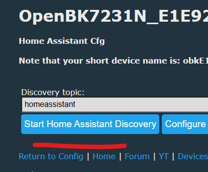

    but did you do HA discover again?
    Screenshot of a Home Assistant configuration page with device name, “Start… Discovery” and “Configure” buttons.
  • Auto mode misreported as fan mute in MQTT UI
    #18 21923021
    Nauttor
    Posts: 17
    Auto discovery does not work.
    I did it manually. That way it works, but as I said, when I hit auto it shows fan mute, and mute ON instead of auto. When I choose mute it is identified as lowest, fine, but the auto is not recognize as there is a bug in the Web UI and mqtt get that sends mute for auto.

How do I extract the UART baud rate and Tuya config from a WBR3 backup using Easy Flasher Tuya config extractor?
Run the saved WBR3 backup through Easy Flasher’s Tuya config extractor and check whether it reports UART settings. In this thread, that step was suggested specifically to confirm whether the AC used a different baud. The original firmware boot log later confirmed read baud rate 115200, so the extractor is useful as a fast cross-check before changing driver assumptions. [#21919984]
Why does the TuyaAC UI stay empty and log repeated "Garbage RX: 00" messages after starting the driver?
The usual cause here was a hung AC indoor board, not a dead WBR3. After one flash, the UI stayed blank and logged repeated Garbage RX: 00, but a full power cut to the air conditioner restored communication. On the next cold boot, TuyaAC began receiving status and populated most fields. If the UI is empty, power-cycle the whole AC first, then retry startdriver tuyaac. [#21919752]

How can I control ACMode, FANMode, TargetTemperature, and ACPower over MQTT in @notupus's TuyaAC firmware?
Use command topics, not /set state topics. The working format was cmnd/devicename/FANMode with payloads like mid, and the code currently implements only four commands: ACMode, FANMode, TargetTemperature, and ACPower. A direct test using nameofdevice/mute/set failed and was ignored, but mosquitto_pub -h x.x.x.x -t "cmnd/devicename/FANMode" -m "mid" worked. [#21922082]
