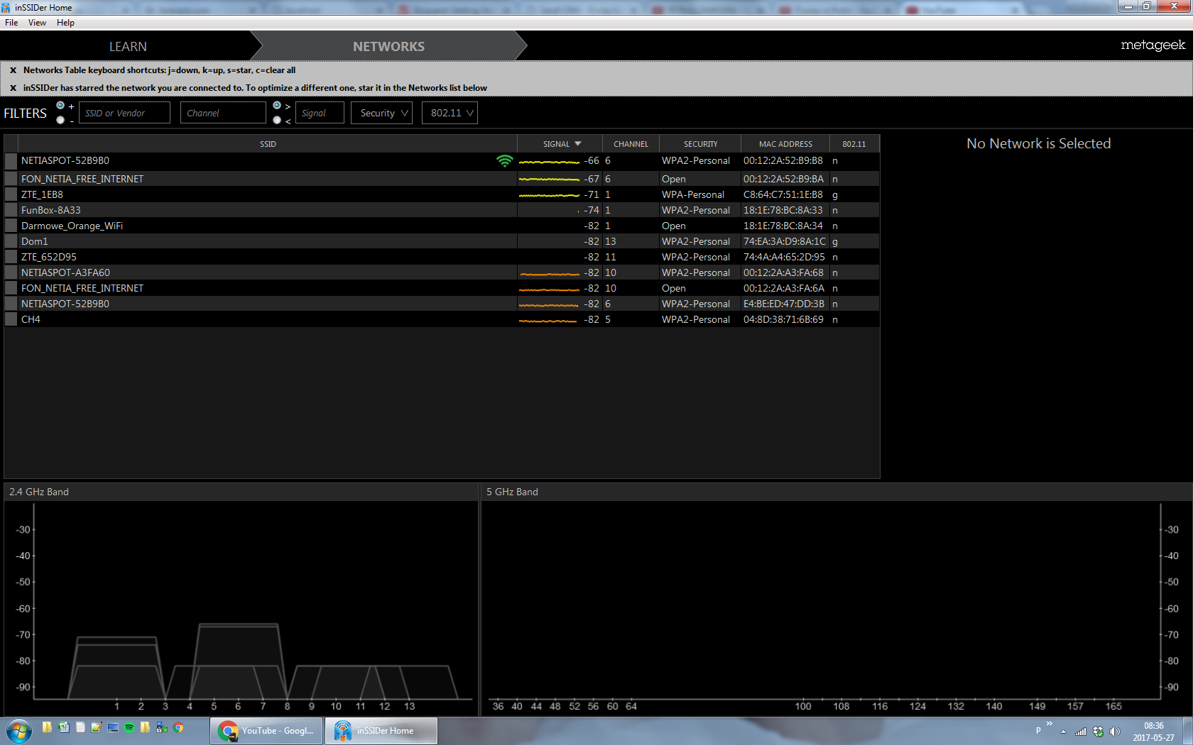

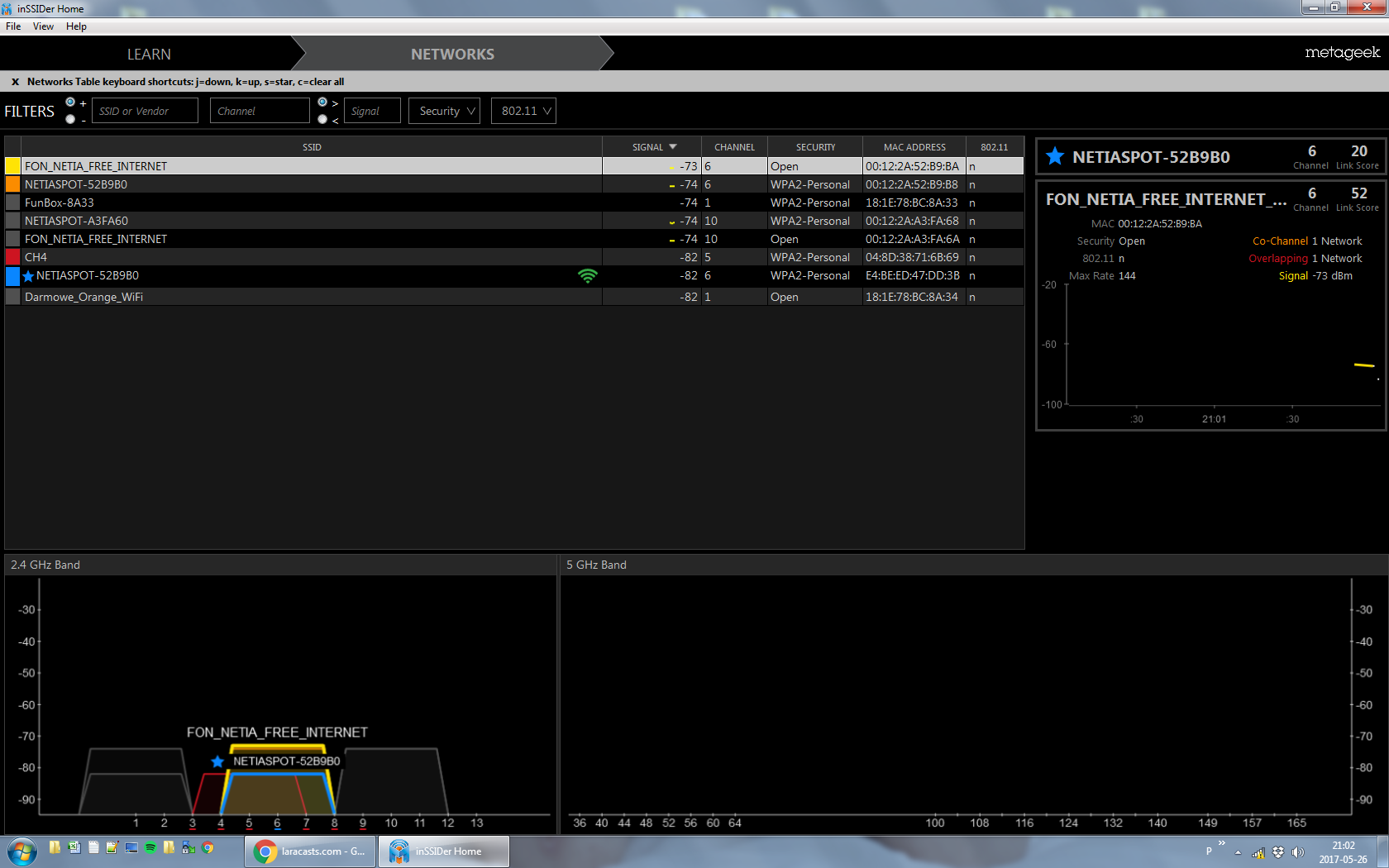

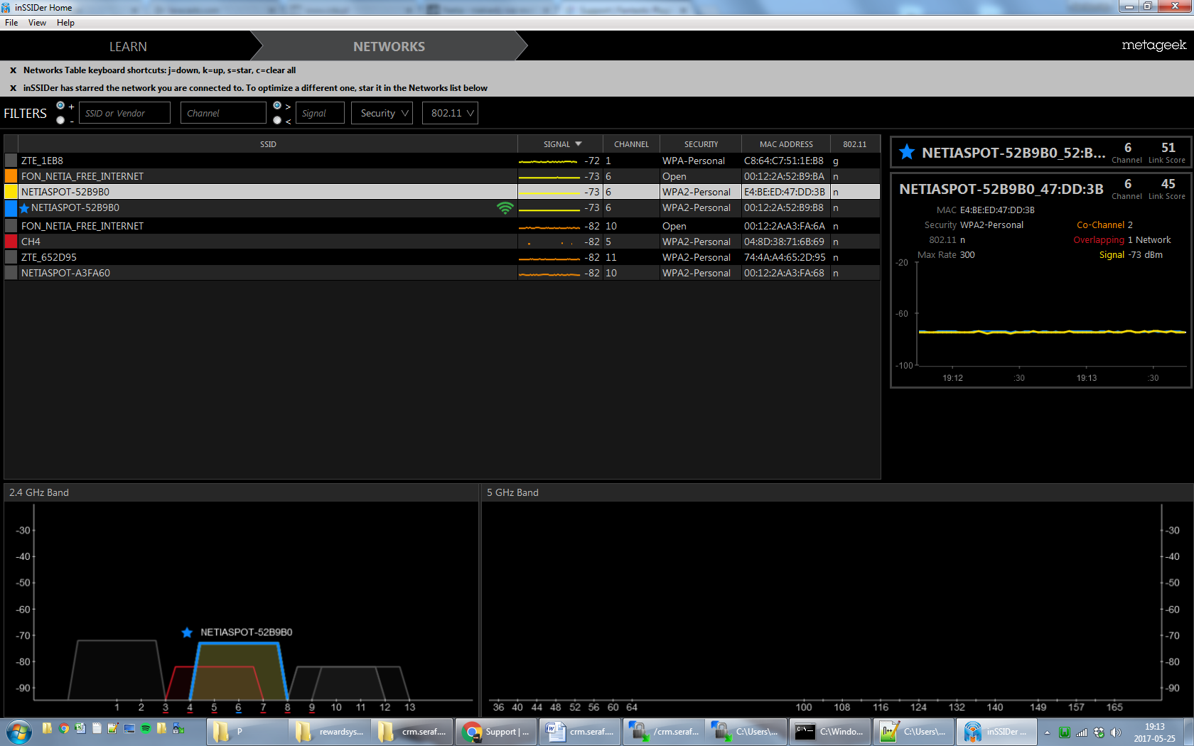

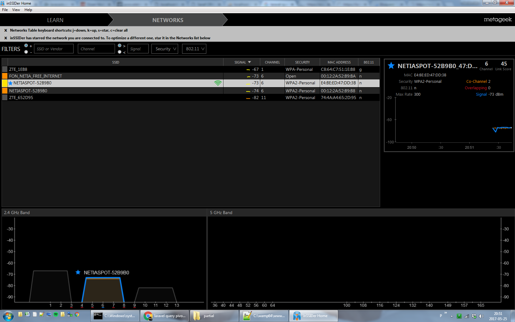

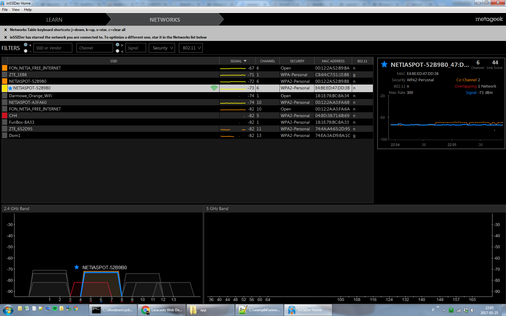

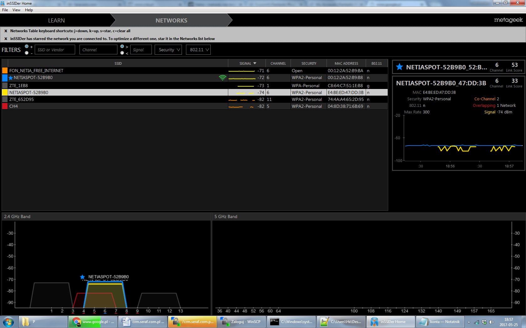

    1. Paste screenshots of router wifi configuration and line parameters.
    2. Install and run InSSIDer. Then paste screenshots of its operation here.
  • #3 16497833
    wizjo
    I do not know if this was exactly what it was about, but I tried to connect to the router via the cable to enter its settings through the browser. Unfortunately, it was not successful. I connected to the ETH2 and ETH3 ports and in both cases to no avail. I have the ETH1 port occupied by the aforementioned repeater. In addition, there is also a WAN port, but I once remembered that Netia's hotline recommended not to use it.
    Pinging the address 192.168.1.1 also showed no host address. At that time, only one device (other than the one with which I tried to connect) was working at home.
    I am enclosing below a few made at different intervals, because I do not know what exactly should be presented on them. One of them shows a situation where it shows that the Internet is properly connected, but in practice there is no connection.

    1.
    wizjo wrote:
    Deafult Gateway. . . . . . . . . . : 192.168.1.254
    DHCP server. . . . . . . . . . . : 192.168.1.254
    Try this address.
    2. Try to adjust the wifi channel to 11. It seems less crowded
  • #5 16503089
    wizjo
    Thank you very much, it works flawlessly. But I wonder why you chose channel 11? On any of the screenshots you can not see that any of these channels is occupied at all: 2, 3, 4, 7, 12. It is true that 11 also does not appear too often, but it is better to choose a completely free channel?
    #6 16503161
    jprzedworski
    Posts: 5366
    Help: 758
    Rate: 827
    As you select a channel, you select the entire band. As you look at the pictures, you have, for example, channel 6, but you are practically 4 to 8. The spacing should preferably be 3 channels. So e.g. 3-6-9-12 Never adjacent.
