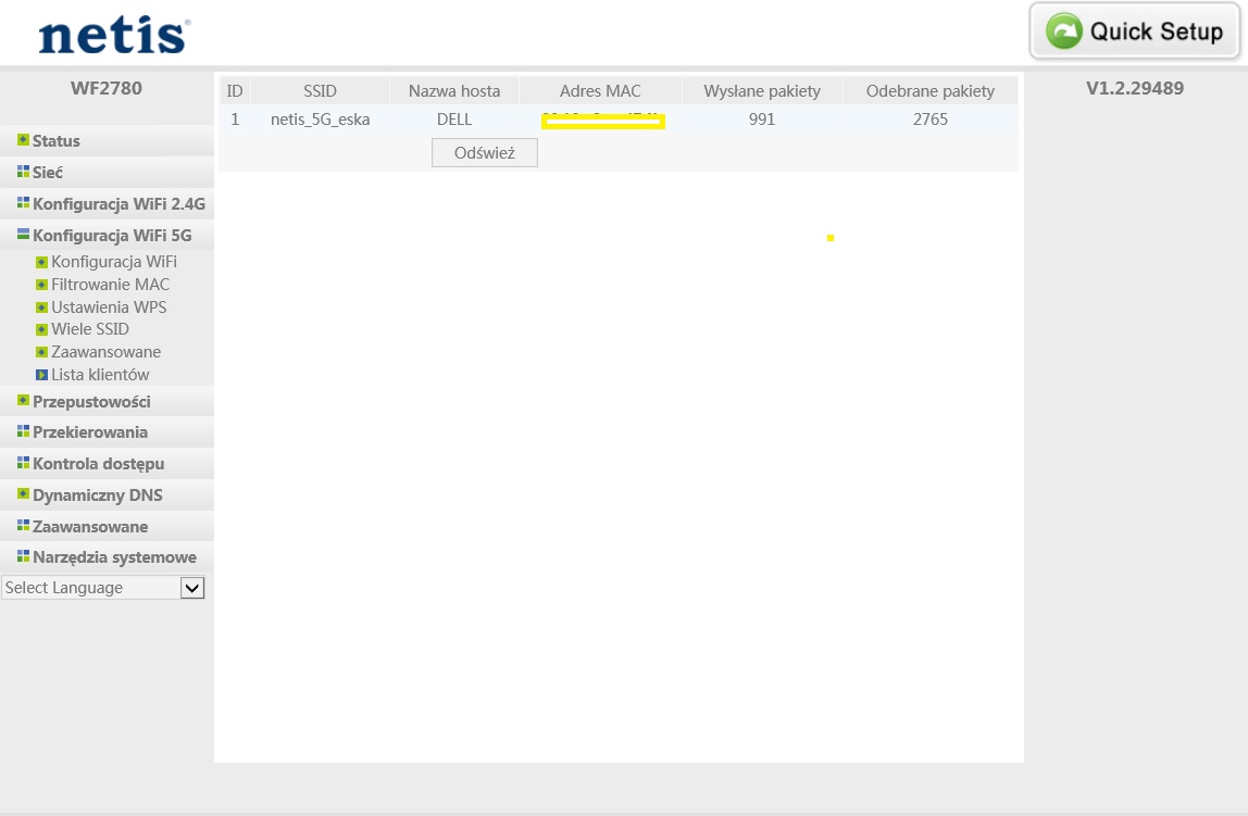

    How to properly configure Netis WF2780 as a WiFi repeater / repeater.
    Is it possible to name the amplifier the same as the Huawey router, in my case the network name B593-9493? Wifi 2.4G or 5G?
    Could the pool addresses 192.168.1 be used. ... ..? So that the mobile device sticks to one network name. Below I have pasted screenshots of my configuration.
    Works as a bridge.

    For the future, you don't need to take screenshots of everything, because almost every router manufacturer has something like a simulator available. http://www.netis-systems.com/en/Support/1607.html " target="_blank" rel="nofollow noopener ugc" class="postlink inline" title="" > http://www.netis-systems.com/en/Support/1607.html
    And to the point:
    2.4G or 5G, if your main router supports 5G then go for it, especially if you live in a block of flats and have lots of other routers. I understand that the address of the main network is 192.168.1.0/24 Perhaps the address of the main router is 192.168.1.1/24? It's best to start with a factory reset of your amp. So when it comes to configuration, in the network-> WAN you change to "Wireless", you do not enter the name of the router! just search and select with your finger. Select the type of security for your network. All security type settings must match those of the main router (repeat everything must be the same! That's important!). In the WAN settings you change to "static IP" and type:
    ip address: e.g. 192.168.1.254
    mask: 255.255.255.0
    default gateway and DNS: 192.168.1.1 (i.e. the address of the main router)
    network-> LAN
    mask: 255.255.255.0
    DHCP is turned off (IP addresses are assigned by the main router)
    network-> operating mode select "bridge" and "static ip address"
    mask: 255.255.255.0
    in plants:
    2,4-> wireless network
    5-> wireless network
    you set:
    radio type: amplifier (repeater)
    configuration: automatic
    you search for your root router and enter the password below
    It should be everything. The rest of the options are of no interest to you, because everything is taken care of by the main router. This amplifier will only serve as an additional range-enhancing antenna. In case of problems, write to me.] Link [/url]

    Several days have passed. The equipment does its job. Thank you to my colleague @ kamil.ck13 with remote support. He did a great job. We tried the method that Kamil described earlier. But something was not working.
    We changed the encryption method on the main router 192.168.1.1. WPA2-PSK remained unchanged, but we changed the WPA encryption to the recommended AES.
    In Netis, we started by setting the Network >> Work mode as Bridge. We changed from DHCP to Static IP and entered the settings below:
    Netis WF2780 - How to correctly configure it as a repeater / repeater
    Then in 2.4G WiFi Configuration >> Turn on, Connection Mode >> Repeater. Press the access point scan and after searching for our network, enter the password and OK, confirm. We already have a 2.4G network
    5G WiFi setup is similar. The difference is in access point scanning. It looked for nothing for me. I typed (copy / paste) the access point and password. I approved and everything.
    We have this status:
    One more beer for Kamil :spoko: . Thanks a lot.
