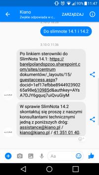

  • #12 17065607
    cmaciej
    I had the same problem with the model SlimNote 14.1+ Kiano Polska actually responds to facebook and provides drivers on request, a package for SlimNote 14.1+:
    drive.google.com/open?id=16a_3GyYAHOuZGPxkL5oX_pwySPAb7Pv2

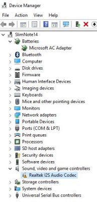

  • #14 17229177
    Vadam
    Since Windows upgrade to version 10, I have the following windows problem on Kiano SlimNote 14.1
    Problem 1. no sound, complete (neither built-in speaker nor headphones).
    Problem 2. no battery charge indicator
    Unfortunately, I accidentally removed the previous version of windows (well, the laptop has a tiny disk).
    Problem 1 (lack of sound) Attempts to repair;
    1. Problem 1 (No sound): standard windows troughleshooting .. no results
    2. Problem 1 (No sound): Device Manager? / Scan for hardware changes ... no result
    2. Problem 1 (No sound): Device Manager / Sound, video and games controllers. It shows one item: Realtec I2S Audio Codec. An attempt to update / install drivers removed from the links provided by flanelcia and kuba14git. When trying to update, windows: Windows encountered problem installing the drivers for your device appears. Realtec I2S Audio Codec. Driver is not intended for this platform.
    Problem 2 (no battery status indicator). The point is not that the icon has disappeared. The problem is that after the upgrade to Windows 10, the system is unable to control the battery status and inform it.
    1. Device Manager (Device Menderer?) / Batteries / Microsoft AC Adapter. Nothing else occurs under Batteries. And it should also be: Microsoft ACPI-Compliant Control Method Battery (or something similar).
    Kiano SlimNote 14.1 Laptop: Searching for Windows 10 Video Card & Micro SD Card Drivers Online
    I do not know what to do here.
    I would like to ask for 'łopatologiczna' help (sorry, I am not an IT specialist or a computer geek).
  • #15 17406604
    nomadpl
    Posts: 294
    Rate: 30
    It is best to write to Kiano - they have easily made available to me drivers for 14.1 and 15.6. You can also test it with a program that will show you what's inside. They have repeatedly explained to me that when I restore the computer to factory settings, then the drivers should load automatically. And a clean installation is known that no Kiano guarantee is lost.
