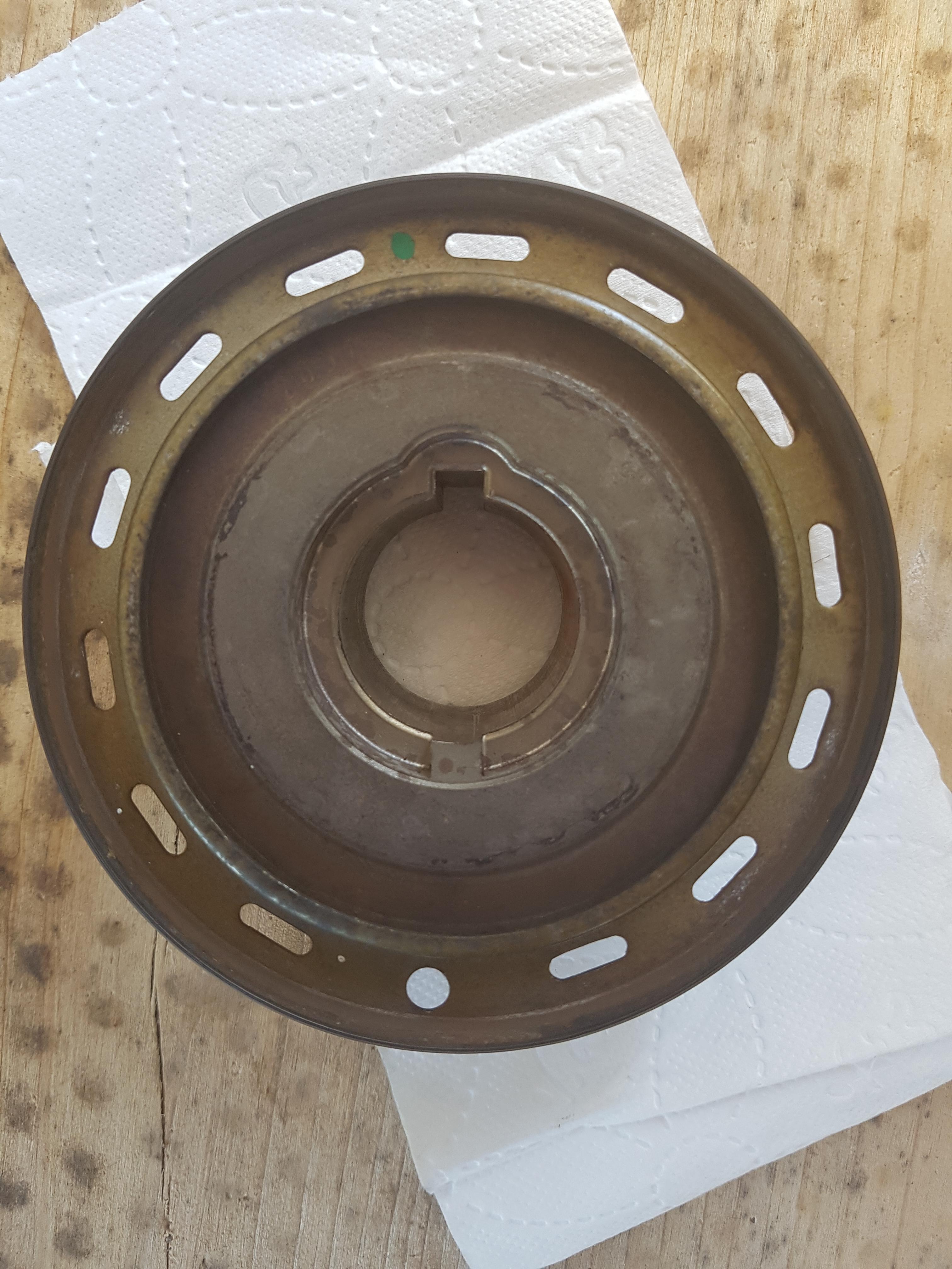

    joker1420
    Posts: 27
    Rate: 10
    I have a small problem how to set gmp in this engine? camshaft blocked ,, I did not make a mark on the shaft, and I took off the magnetic ring (seal replacement), how should this ring be positioned? Citroen Jumpy II 2007 1.6 HDI 16v DV6TED4 - Timing Belt & Chain Setting Photo Request

    joker1420
    Posts: 27
    Rate: 10
    Yes, I have a groove on the shaft but I mean - in what position to put this ring on the wheel "I unnecessarily pulled it off but now it does not matter" the locking hole should be set at 9 o'clock relative to the wedge on the shaft?

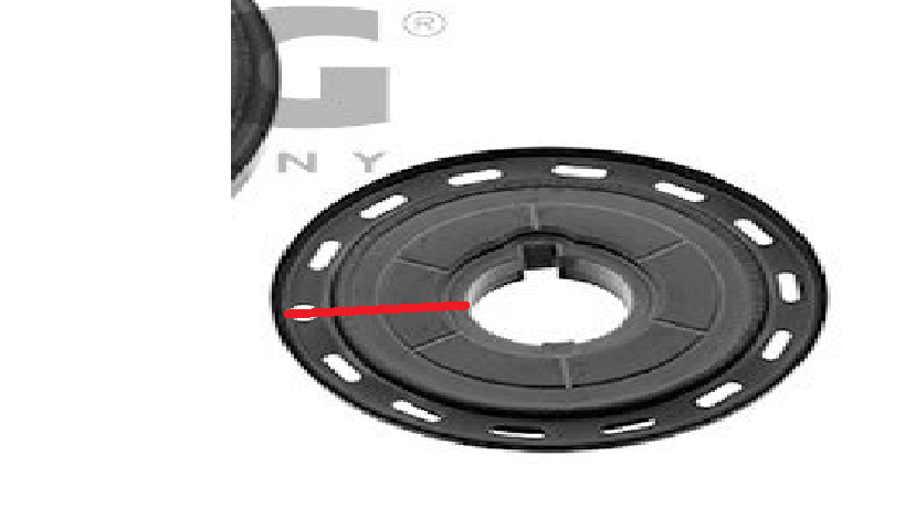

    joker1420
    Posts: 27
    Rate: 10
    should the ring be positioned in this way? Citroen Jumpy II 2007 1.6 HDI 16v DV6TED4 - Timing Belt & Chain Setting Photo Request
    Added after 16 [minutes]:
    survived, I did not touch the path on the sides, I will try to fold it, this is not a demountable part - you don't mention it?
    Added after 1 [hours] 52 [minutes]:
    ring fitted, shaft blocked, camshaft blocked, pump blocked, I wanted to make sure before putting on a new belt whether there is a gmp, I put the wire in place of the injector and it turns out that the 1st and 4th pistons are not in GMP, did I miss something? This is my first timing in a PSA engine.

    sly_1978
    Level 20  
    Posts: 724
    Help: 34
    Rate: 284
    Locked to DV6 timing will not be in GMP.
