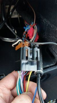

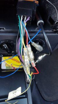

    I have a Pioneer MVH-160UI radio. I would like it to turn on with the key and turn off after removing it. Currently, I have to turn the radio on and off manually. The manual states that, depending on the car, red to red and yellow to yellow or, conversely, red to yellow and yellow to red. I tried both, but the effect is still the same - I have to turn it on manually.

  • #6 16511537
    Jachuw90
    Posts: 78
    Rate: 39

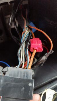

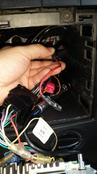

    I took measurements and the voltage on yellow and red is constant, regardless of whether the ignition is on or not. However, I disconnected the red cable from the black and blue cable, which were connected with this pink connector. I only checked the voltage on the red one. It is not on it, whether the ignition is on or off. I didn't make any more measurements because I don't know what to do next.
    Illustrative photos below:
    Skoda Fabia 2001: Pioneer MVH-160UI Radio Auto On/Off with Key - Wiring Configurations
    Skoda Fabia 2001: Pioneer MVH-160UI Radio Auto On/Off with Key - Wiring Configurations Skoda Fabia 2001: Pioneer MVH-160UI Radio Auto On/Off with Key - Wiring Configurations

    Take a picture of this black plug from the installation side so that you can see the colors of the wires.
    At this point, the wires that connect to the yellow and red go into this wrapped bundle? If so, possible damage to the car and the previous owner combined it to be overcome.
    Also check the fuses from the radio on the side of the dashboard.
    What is this extra fuse? Where is he connected?
  • #8 16511584
    Jachuw90
    Posts: 78
    Rate: 39
    I will take photos, and this additional fuse is on the red one, which was connected by a connector to the one shown in the previous photos, i.e. to the black-blue one.

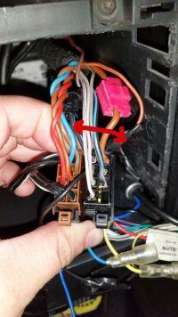

    The power supply is these black wires with a blue stripe. As I said, you need to find out why there is no voltage on one of them after the ignition. The blue cube is a changer or its emulator.

    I checked the fuse from the radio, it is working. Oddly enough, according to the list of fuses, the fuse from the ignition system is missing ...
    #17 16511837
    piotrek22101
    Posts: 3323
    Help: 695
    Rate: 1421
    Top up the fuses, check for loose wires behind the radio. I don't remember exactly, but there are cars with a triple fuse socket. It is translated depending on the needs, whether the radio is keyed or not.

    And it does not matter with which black and blue do I turn? And how to disconnect this cable from the ankle?
    And the red-brown one insulated at the moment - on it I checked the voltage with the ignition on and off and there is nothing, zero.
    PS. sorry i was wrong on that red one on the back there was no tension. I did not check the red and brown one.
    So I have to replace these, yes? :
    PS 2 ok, I already know. Not the black and blue one, but the other one :-P
    Added after 1 [hours] 18 [minutes]:
    sk700 wrote:
    piotrek22101 wrote:
    Two black and blue are the same power supply.
    In conclusion, swap that black-blue under gray-white with brown-red insulated somewhere in the back.
    Thank you to everyone, just like the sk700 said, yes it was, cables changed and everything works as it should be :)
