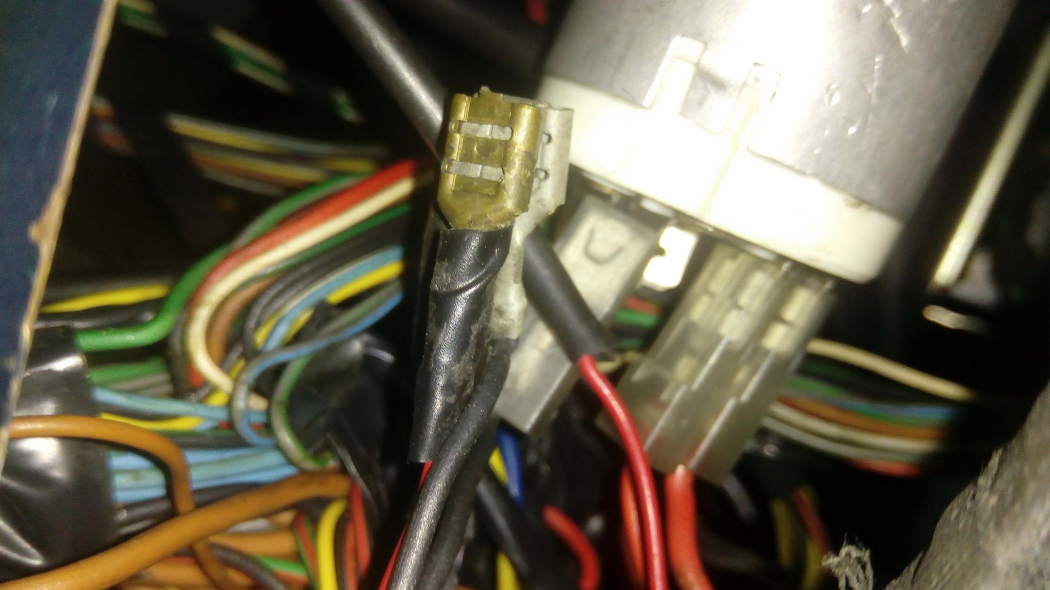

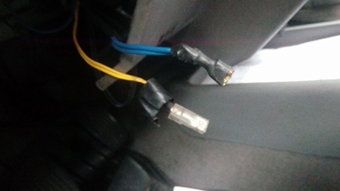

    Skoda Felicia 1.6 1997: Reconnecting Key Ignition Button - Wiring & Installation Guide Skoda Felicia 1.6 1997: Reconnecting Key Ignition Button - Wiring & Installation Guide Skoda Felicia 1.6 1997: Reconnecting Key Ignition Button - Wiring & Installation Guide Skoda Felicia 1.6 1997: Reconnecting Key Ignition Button - Wiring & Installation Guide Hello, a month ago I bought a Skoda Felicie 1.6 1997 hatchback, it had a button firing that worked on the principle of inserting the key into the ignition switch, turning it to the ON position, i.e. maximally to the right and pressing the button and you had to hold it, but this button fell out with the cables. So my question is if I bought the same button as to connect it, a button like in the picture, with two pins, a cable is connected to one pin and the other probably had nothing. How do you bite it?
    This ignition switch looks more like in the pictures and such cables are loose, from what I know, blue is from the starter, so I need to connect the blue button to this button and which is the second? Or to the ignition pin, I'm completely green.
    [Photo] http://electropark.pl/2622-thickbox/przycisk-monostabilny-okragly-zwierny.jpg [/ photo]
    This is what it all looks like:
    Blue is rather from the starter because the starter under the hood also comes out like a blue one.
    So as for the button you need to connect?

  • #6 16950475
    tzok
    Posts: 38890
    Help: 3176
    Rate: 6549
    The button that had to short the two wires ... what's your problem? The ignition switch in the START position connects terminal 30 with terminal 50. However, you should close 15 with 50, so that the button does not engage the starter with the ignition off.

    #7 16950487
    Dawidos97
    Posts: 27
    The problem is that I do not know what cables were connected and where, reansuming to one pin, I have to connect the starter cable and the other one which was in place 15 and it does not have to be connected to this cube?
    Sorry for the stupid questions but I'm totally green on this tm.

  • #10 16950554
    abart64
    Posts: 1716
    Help: 271
    Rate: 633
    The original cable from the car's installation is to be inserted into pin 15 of the ignition switch and an additional button for the button should go from it.

  • #12 16950741
    marfur30
    Level 28  
    Posts: 796
    Help: 138
    Rate: 386
    Take the control lamp in your hand and measure which wire shows the current after ignition.
    When you find this cable, attach the second cable to it and connect it to the button and that's it. :)
