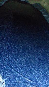

    Trying on the finished cartridge

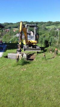

    Budget-Friendly Backyard Pool Construction: Using a Ready-Made Basin for 4000 Zlotys
    The beginning of digging. After two digging evenings yesterday, I poured the bottom of Concrete b 25 + dispersed reinforcement + sealer and super plasticizer and such effect

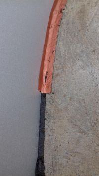

    Today is the next evening of work and the sheet is set. Notched groove in concrete sealed with roofing silicone + roofing tape. Tomorrow, the styrodur 2 cm on the bottom of a duffel fleece 500 g. On the walls, the polystyrene foam 4 cm.
    Budget-Friendly Backyard Pool Construction: Using a Ready-Made Basin for 4000 Zlotys Budget-Friendly Backyard Pool Construction: Using a Ready-Made Basin for 4000 Zlotys Budget-Friendly Backyard Pool Construction: Using a Ready-Made Basin for 4000 Zlotys

    I also think that it is completely cheap. I give the best materials, and I think to save on the work and good ideas. Today is another evening of work and
    Coarse foil on the outside of the sheet. Styrodur on the bottom. Geotextile on styrodur
    Styrofoam sides on the walls. Distribution of the cartridge and pouring the basin with warm water for a good stretch of rubber.

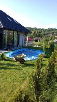

    Another work evening. Water poured almost to full. And a covered solar film. And the sides are showered on the bottom with breakage fraction of 1-3 mm, and the rest of the ballast under the ankle.

    The pool is over. I do not have an exchanger connected yet, but the water still stays within 27 degrees because it is all insulated.
