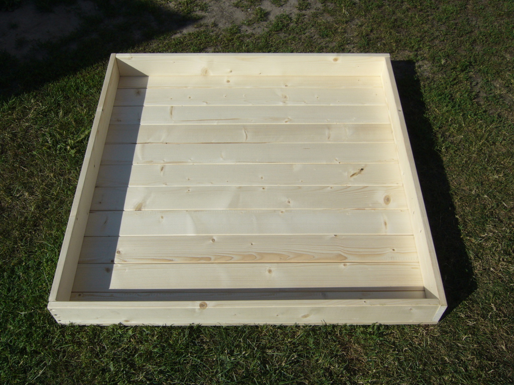

    I started working on the new collector at the beginning of June (after work - after hours).
    First, the purchase of planed boards, then something like a drawer was assembled from these boards - I also mounted four furniture handles so that the collector could be easily moved by two people.
    Dimensions are 104cm x 104cm - inside 100cm x 100cm
    Later painting with 4x primer and 3x yacht lacquers, of course at appropriate intervals.
    Then inside it is lined with 5 cm thick polystyrene - I put a black flat sheet on it and I put a new black garden hose - 50m 1/2 inch - as you can see in the first photo, 50 meters is a little bit, so I added a few more meters of green I had. The whole thing is covered with a glass, the black hose is the collector's entrance and the water from the pump is supplied there. The green one is the exit and runs under the polystyrene sheet and then returns to the pool. The glass rests on four boards on the sides and on the hose, lies evenly and is not too hot during operation, because the hose cools the temperature inside the collector on an ongoing basis. If it is not used, it is covered with, for the time being, a makeshift gumolite. I am currently making a cover, i.e. an OSB board with dimensions of 108 cm x 108 cm - covered with epoxy resin to make it resistant to weather conditions. There will be a sheet of metal on the outside, the same boards underneath as on the corners, so if you put it on the glass, it will fit.
    Here are some assembly photos.
    At the beginning, the "drawer" with handles:

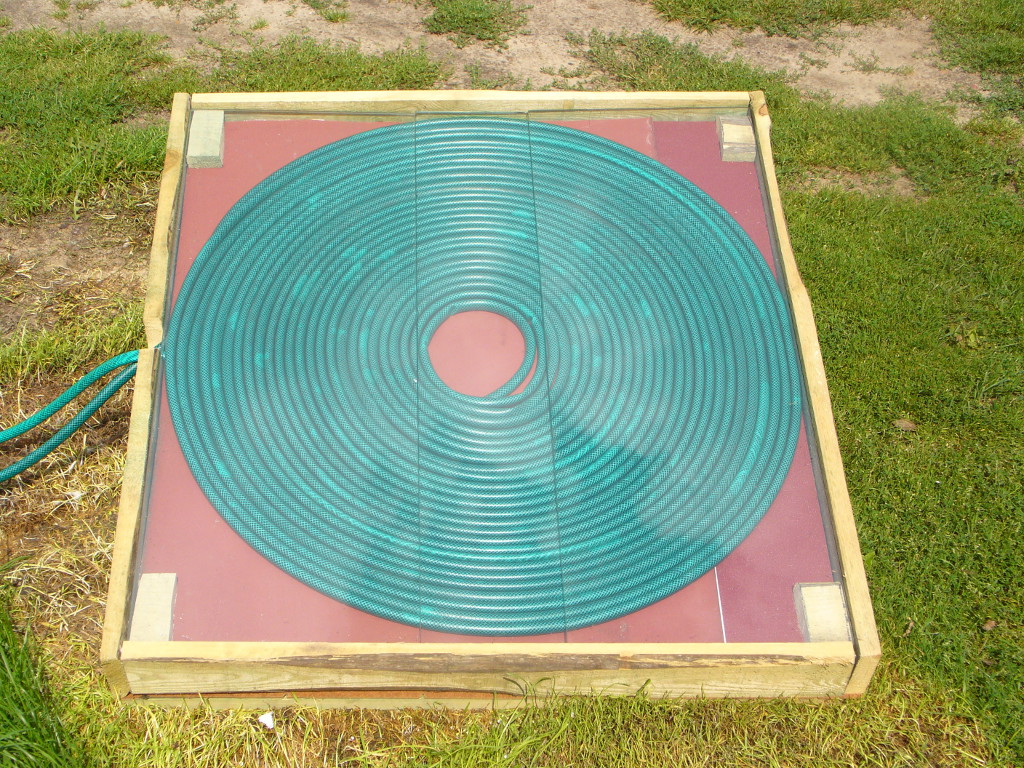

    It took a bit of work, but the effect is there - photos of the finished collector below:
    Solar collector - heating water in a small pool Solar collector - heating water in a small pool Solar collector - heating water in a small pool Solar collector - heating water in a small pool Solar collector - heating water in a small pool Solar collector - heating water in a small pool

    As I mentioned before - the principle of operation is very simple - this time the submersible pump is connected directly to the solar battery and when the sun is out, the pump pumps water into the hose in the collector there, under the glass, the water in the hose heats up and the other end of the hose flows into the pool.
    At this point, I warn everyone who would like to do something like this before using a 230V pump. I am allergic to human thoughtlessness and I would not forgive myself if there was some kind of overvoltage when my child was sitting in the pool. I STRONGLY ADVISE against it, because it is associated with a potential threat to life.
    That's why I used a 12V submersible pump - used for camping - the pump takes about 1.6A from the battery, which givesabout 20W and with this power it can pump 10l / min, but it has a minus, namely it cannot work continuously, only probably a maximum of 10-15 minutes. In my system - a very simple one, the pump is powered directly from a 10W solar battery, so it works at half its power, thanks to which we gain the possibility of continuous operation and lower flow, which in our case is very beneficial.
    The connection method without any drivers also has its advantages: simple analog operation - the sun is on, the collector is warm; there is no sun, the collector does not heat up, the pump stops and the water circulation stops, which also helps to prevent the pump from unnecessarily giving hot water to the collector when the sun is behind the clouds.
    I also warn you against using a SMPS Made In China power supply for such a pump - I do not trust these Chinese products. God forbid such a power supply will get a breakdown and the electricity from the mains will go to the pump and to the water, and then you know what to do next.
    So far my solution is 100% safe, effective and ecological.
    As I mentioned earlier - in the collector with internal dimensions of 100cm x 100cm there is 50m of black hose and a few green ones, about 5m - as there is no high pressure in the hose, the hoses were pressed inside with a smaller one with a smaller thickness along the length of about 4 cm - the thinner hose that fits on the pump, just perfectly fits inside the half-inch hose. The temperature difference between inlet and outlet is from 3 degrees for cold water to 6 degrees for warm water.

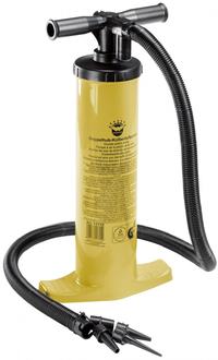

    The idea of heating the water is great, but to pump this pool it is a bit exaggerated to use a compressor. I would inflate it with my lungs in a few minutes (I am able to inflate such a large two-meter Intex plowing in less than 10 minutes). Well, but when I have a pontoon to inflate, I prefer to inflate with such a pump:
    They are on Allegro for about PLN 40, but I found it about three years ago in a sports store in my city at an equally good price. Powered by a cigarette lighter or power adapter that is included.
    When there is enough air, I add the pressure with something like this:

    I guarantee it will be much faster than the compressor from the refrigerator.

    I see no one mentioned pumping the pool with the vacuum cleaner exhaust air, I do and recommend it.
  • #22 15779130
    prosiak_wej
    Posts: 5273
    Help: 501
    Rate: 1459
    I believe that few of the vacuum cleaners on sale today have an exhaust air connection? Old Zelmers or Czajki had it and it was not surprising. Mattresses were pumped with a vacuum cleaner, after all.
  • #23 15779507
    ketch
    Posts: 19
    In my case, the possibility of connecting a hose to a vacuum cleaner on the other hand appeared after removing the final air filter.

    Yesterday I changed the water - I solved the problem with pumping - I connected the air from the aggregate to the outlet and pumped the air until the pump immersed in the pool did not go air - the water was completely pumped out - so the problem will be solved for the future.
    As for pumping with a vacuum cleaner, the problem is the fastening, I also made a pump from the aggregate and it will be useful for reproof.
    Today it promises to be splashing water changed clean - pure pleasure.
    Greetings ....

    I used 2 radiators to heat the water in the pool :)
    Cheaply bought, painted black, low water flow and heated really well.
  • #29 15794292
    DJCheester
    Level 28  
    Posts: 2082
    Help: 75
    Rate: 955
    Two radiators are also a good idea and tell me how did you force the circulation of water in the radiators - pump or gravity circulation as with the efficiency of such a circulation ??
    Greetings ...
  • #30 15795504
    jamtex
    Posts: 806
    Help: 12
    Rate: 247
    A pump, but really with slow circulation, it can heat well :)

How can I inflate the pool without burning cheap compressors?
Use a double-action hand bellows or connect a vacuum-cleaner exhaust; both fill a 2 m pool in <10 min [Elektroda, prosiak_wej, #15774771; ketch, #15779099]. A bargain 12 V car compressor overheated and failed after five minutes [Elektroda, DJCheester, post #15774489]
