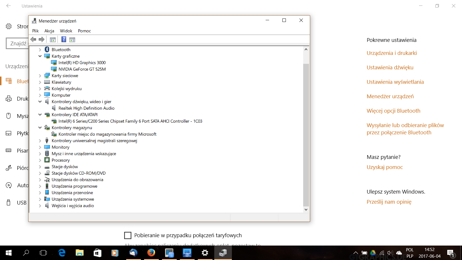

    Hello!
    I wanted to display a movie from a Dell Inspiron N7110 laptop via HDMI cable on a Samsung JU55 Smart TV, but there is only picture and no sound. Windows 10. I read a lot of posts on the subject that you need to select the default audio device as TV in the Sounds menu, but I have nothing but the speaker icons, both options on hidden devices tagged. Laptop connection with Smart TV via HDMI cable - no sound on TV
    I uninstalled the Realtek HD Audio driver and reinstalled it did not help. I tried to download the Intel video card driver, which is also supposed to be responsible for sending audio over HDMI, but he writes that I have the latest.
    I don't know how to bite it anymore, and I'll add that it worked for me earlier and the Tv icon was displayed besides the Speakers in the Sounds menu, but now it is gone.

    Do you have any devices with exclamation marks in the Device Manager?

    No I do not have. Laptop connection with Smart TV via HDMI cable - no sound on TV Laptop connection with Smart TV via HDMI cable - no sound on TV

    sosarek wrote:
    What do you have in Sound Controllers?
    Just like on the second screen Realtek High Definition Audio.
  • #6 16735025
    raf02
    Posts: 151
    Rate: 14
    Problem solved, so I close the topic.
    The driver for the nVidia card was responsible, which supports the HDMI output on the laptop, the second Intel driver only supports the laptop display. Help from nVidia Polska proved helpful, as it presented the procedure for removing the installed driver and uploading a new one.

    I downloaded the latest driver from the nVidia website and it worked, now when I hook up a laptop to TV, for example, a TV icon is displayed in audio devices and of course the sound works.
