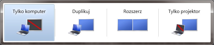

    I have such a problem that I installed new drivers for Realtek, because I did not have a preview of the sound in my computer. I installed and I only have sound on the headphones and on the TV not. The TV is connected via HDMI (without adapter, directly to the HDMI input). I play sound on the TV (music, etc ...). And when I want to run anything on Window Media Video, there is 0 sound. Even when I switch to headphones (which work), I can't hear anything. Everything is turned on, in Windows, TV etc.
    - The motherboard is MSI H110m PRO-VD
    - Sound chipset Realtek ALC-887
    I would be very grateful for your response :D
    And I will add that when I switch from headphones to speakers (TV) I have 0 sound in Windows, as if he did not read NVIDIA HDA

    Updating nvidia drivers should help.

    I updated everything
    This motherboard there is no HDMI output, so you probably connect to an additional graphics card - which one?
