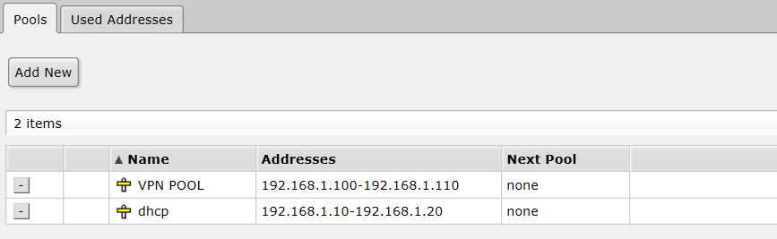

    I have the following problem.
    I will start with the description:
    Local network based on the MikroTik 192.168.1.1/24 router
    In the network, the WIN SERW 2012 server at 192.168.1.11.
    Computer No. 1 at 192.168.1.18.
    Units communicate with no problem, I have access to server resources from computer # 1.
    I connect another computer # 2 to the network via VPN, which has been configured on the MT router (the router is a server).
    Computer No. 2 connects to the network with no problem.
    Interestingly, it communicates with computer # 1, but does not see the server.
    Computer No. 1, sees both Computer No. 2 and the server.
    In turn, the server does not see computer No. 2, but sees computer No. 1.
    what is going on?
    What can the problem be?

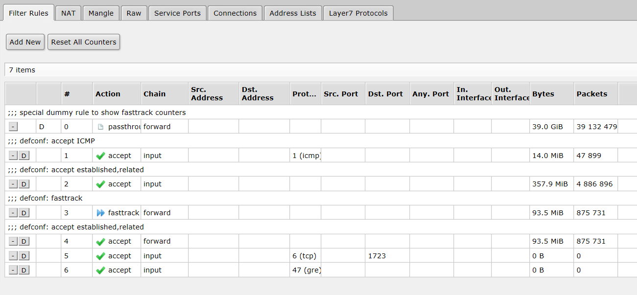

    1. How is the VPN configured?
    2. Paste MT firewall rules
    3. Check the routing tables on the server and MT

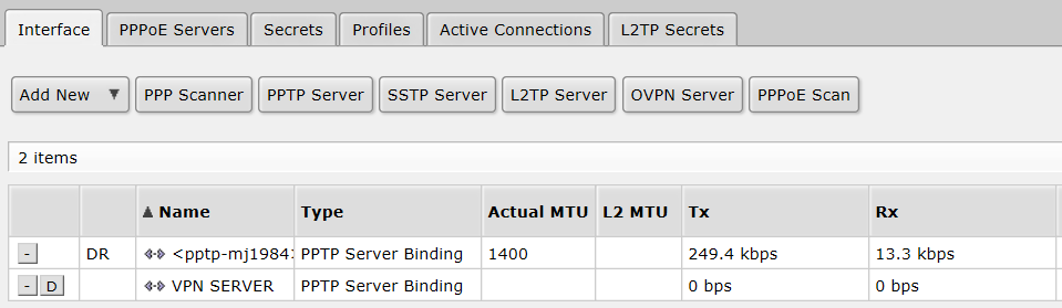

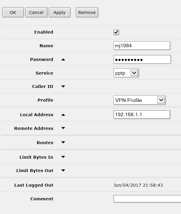

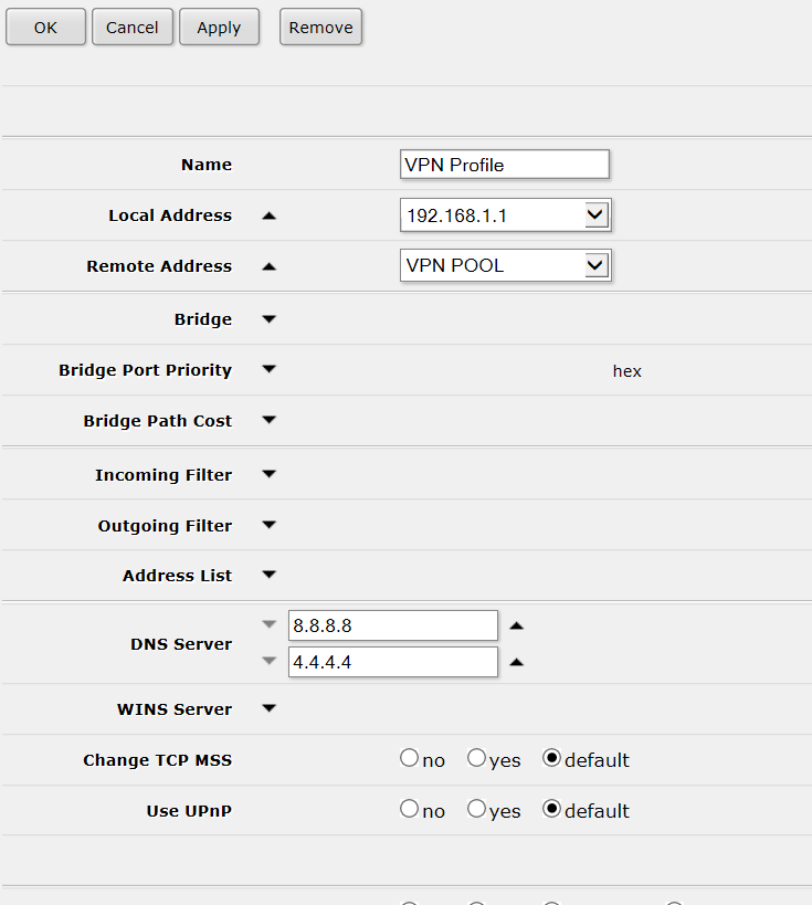

  • #4 16514076
    dzajko
    Posts: 7
    Below are screenshots in the MT configuration
    MikroTik Router VPN Configuration: Connecting WIN Server 2012, Computer 1 & 2 via MT Server MikroTik Router VPN Configuration: Connecting WIN Server 2012, Computer 1 & 2 via MT Server MikroTik Router VPN Configuration: Connecting WIN Server 2012, Computer 1 & 2 via MT Server MikroTik Router VPN Configuration: Connecting WIN Server 2012, Computer 1 & 2 via MT Server MikroTik Router VPN Configuration: Connecting WIN Server 2012, Computer 1 & 2 via MT Server
    I turned off the WIN SERVICE firewall, it didn't help.

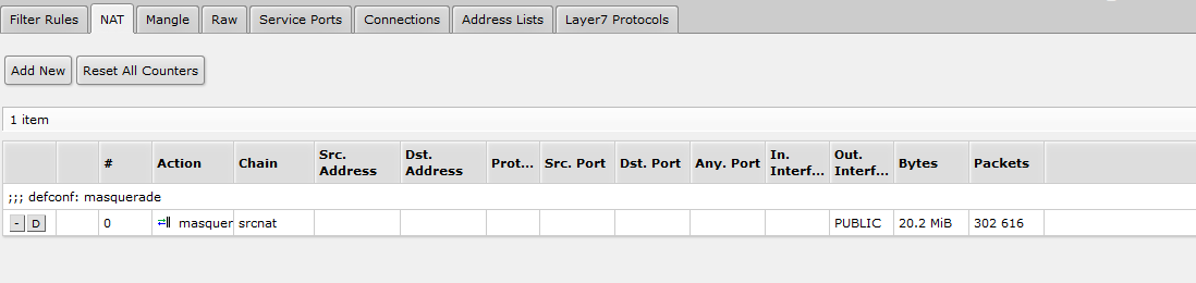

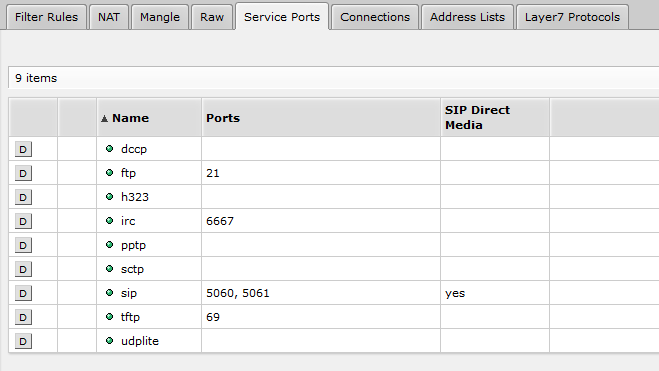

    Also paste the other firewall tabs: NAT, services

    Epic wrote:
    I add:
